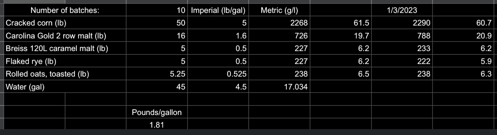

The first section (to use some railroad terminology):
50 lbs of cracked corn
16 lbs of 2 row barley malt
5 lbs of Breiss 120L caramel malt
5 lbs of flaked rye
5 lbs of toasted rolled oats
45 gallons of water
All of the above divided into 10 equal portions, to fit into my 6 gallon fermentation buckets. On all but the first batch, replace 1/2 gallon of water with backset from a previous run. Standard mashing procedure, bring the water to 190 F, add the corn and high temperature enzymes and hold. Bring down to 150 F and add the rest of the grain, along with some extra liquid enzymes and beta glucanase to help break down the rye and oats. When cool enough, pitch yeast (I have Lallemand Distillamax XP, which is what I’ll likely use. Also have DADY and Red Star baker’s yeast, which are options).
Hopefully all the ingredients are pretty common, in case anyone else is interested in trying the recipe, and to prevent me from being locked into a single supplier if this turns out good enough that I want to keep making it.
The corn is obviously there because it’s bourbon, and because corn is cheap and readily available.
The barley is also standard, for both flavor and enzymes. Carolina Malt House claims to have won awards with their Carolina Gold 2 row, so hopefully I have a decent product.
The caramel malt is supposed to give sweetness and fruity, raisin notes. I’m hoping that will provide balance and complexity to the finished spirit.
The rye is there for a little spice and complexity, and just because I like rye.
The toasted oatmeal will hopefully give some nice oatmeal cookie notes and improve the mouthfeel of the spirit.
Ferment on the grain, and either steam strip or squeeze and then strip off the grain. Collect the low wines and run through a pot still, making fairly wide cuts for aging. Save the heads for a neutral, recycle the tails into the next spirit run. Blend and age on new charred and toasted oak.
The second section:
Reserve 1/2 gallon of backset from the stripping run, to go into the next mash. If necessary, add calcium carbonate to raise the pH, though I’ve read that it’s generally not needed for the second generation. Add 8 lbs of white sugar to the rest of the backset and the grain (if you stripped off the grain, put it back in). Add a tablespoon of yeast nutrient, half a teaspoon of DSP, and a pinch of Epsom salt. 2-3 tablespoon of oyster shells can’t hurt, though I’m not sure if they’re needed with all the spent grain still present. Add water to get back to the original volume.
When cool, pitch more yeast and ferment again.
There’s more sugar than in the original AG recipe, to make up for the fact that you’re going to make narrower cuts and treat this more like moonshine than bourbon. I’ve done some research and found a few references to success using 100% of the backset in a sugar head, so it’s all in there in order to get the most flavor. With a little luck, this stuff might age well and at least be competitive with some of the more average bourbons on the market, but I see it more as something to sip on right away, or blend into flavored moonshine concoctions.
Distill same as before, including recycling the tails. Make narrower cuts, since the sugar head is probably better suited to drinking white.

That looks like a pretty tasty grain bill, but somewhat unconventional for a bourbon mash with malt at 20% and rye at 6%.
The vast majority of commercial bourbons contain more rye than malt (notable exceptions are Jack Daniels and Heaven Hill bourbons). I think with 20% malt you'll get a bit of a 'scotchy' character in it, which is not to say that is a bad thing. Caramel 120 won't generate any fermentable sugars (at least it doesn't in beer, but with Gluco added it might). At first it looked a bit heavy handed to me, but 5% is about the upper limit for a beer so it may be OK. It should add a ton of raisiny character and sweetness.
I've built a spreadsheet since I began stillin that helps me develop recipes and predict volumes. After 15+ batches of AG whiskeys & rums, tweaking my spreadsheet after each batch, I find that it is pretty accurate.
I've put this recipe into my spreadsheet, and using an efficiency setting of 75% it tells me I'd get about 38 gallons of beer at about 6.4% ABV, which would yield about 1.4 gallons of product after cuts. Of course, these are only estimates, but I find that my 'predictions' are pretty close, generally within about 10%.
I say go for it.

higgins wrote: Sun Dec 04, 2022 7:13 am That looks like a pretty tasty grain bill, but somewhat unconventional for a bourbon mash with malt at 20% and rye at 6%.
I like unconventional! Ideally, I would like this to be something unique and special enough that I can share it and have people appreciate it for its own character. Realistically, I’ll be happy if it’s better than what I can buy for a reasonable price.
higgins wrote: Sun Dec 04, 2022 7:13 am The vast majority of commercial bourbons contain more rye than malt (notable exceptions are Jack Daniels and Heaven Hill bourbons). I think with 20% malt you'll get a bit of a 'scotchy' character in it, which is not to say that is a bad thing.
Good thing I like scotch. My thought with the rye is more as a background spice, rather than a dominant flavor. Kind of like the way I put salt and cayenne pepper into my cinnamon rolls. There’s not enough of either for you to notice them, but they give it a much more interesting and complexly flavor, enhancing the dominant flavors.
I was a little concerned that it was too little malt, to be honest. I know there’s not enough for a full conversion, which is why I’ll add enzymes as well.
higgins wrote: Sun Dec 04, 2022 7:13 am Caramel 120 won't generate any fermentable sugars (at least it doesn't in beer, but with Gluco added it might).
I assume it’s still got starch in it, right? If so, it should provide some fermentable sugar after milling and mashing and adding enzymes. At least, that’s my hope. If all it adds is flavor, that’s good too.
higgins wrote: Sun Dec 04, 2022 7:13 am I've put this recipe into my spreadsheet, and using an efficiency setting of 75% it tells me I'd get about 38 gallons of beer at about 6.4% ABV, which would yield about 1.4 gallons of product after cuts. Of course, these are only estimates, but I find that my 'predictions' are pretty close, generally within about 10%.
I am hoping for a little more that that, of course, but my attitude is that I get what I get. Better to focus on quality, and just make more if I want more. I’m curious, does your spreadsheet have any allowance for recycling the feints, which should hopefully increase yield a little bit? Also, I’m hoping that slightly wider cuts with long aging in mind might mean slightly greater yield. But again, quality over quantity.

Steve Broady wrote: Sun Dec 04, 2022 8:09 am I was a little concerned that it was too little malt, to be honest. I know there’s not enough for a full conversion, which is why I’ll add enzymes as well.
I should have said that "caramel 120 won't generate very much fermentable sugar".
Crystal malts are made by adding a 'stewing' step between malting and drying. The malt is kept moist and held at saccharification temperatures before drying, which converts most of the starch to complex crystalized, caramelized sugars. There may be a small amount of starch remaining. Some of the caramelized sugars are fermentable, with one estimate of about 40% fermentable sugars in Crystal/Caramel 10, decreasing as the color increases. I don't know if our distillers enzymes will simplify those complex sugars.
It takes around 30 degrees Lintner (diastatic power) to convert a pound of grain. Your 81 lb grain bill should take about 2400 dL to convert. Your 16 lb of pale malt will contribute nearly 2000 dL (6 row would be over 2500 dL).
My spreadsheet does have the ability to use both feints and reserved wash in the estimation of low wines qty & abv.

Well, I’m committed. My wife and I spent about an hour and a half last night measuring out all the grain for this recipe and vacuum bagging enough for ten 5 gallon batches. I opted to use malted corn, which means that everything can be ground and mashed together. I realize that 90 lbs of grain is nothing to a lot of folks here, but it’s by far the most I’ve even considered and will likely take me a year just to get through.
I have to say, it smelled wonderful as we were weighing it out. That 120L smells like Raisin Bran. I’m hopeful that this will make a good bourbon.

The first batch is in the fermenter as we speak. I tweaked the recipe slightly:
50 lbs malted corn
16 lbs 2 row malted barley
5 lbs Breiss 120L caramel malt
5 lbs flaked rye
5.25 lbs instant oatmeal
I gave the oatmeal a light toast, cooked, and then divided everything into 10 batches and vacuum bagged them. The last bag was a little bit off most of the measurements, since I just used whatever was left after carefully weighing out the other 9 batches.
Last night, I ground everything in that last bag twice using a corona mill, until it was a mix of fine flour and ground meal. It all went into a cleaned and sanitized cooler, along with 4.5 gallons of water at 156 degrees Fahrenheit. Final temperature after mixing all the dough balls out was 149 F. I added 2 ml SEBstar HTL, 2 ml ViscoSEB L, and 3 ml SEBamyl GL, gave it a good stir, then closed the lid.
12 hours later, the temperature dropped to around 100 F, and I transferred everything into a bucket for fermentation. Prior to moving it, I reserved a pint of liquid from the top and set that aside in a mason jar. I measured the gravity at 1.044, which should be about 1.049 after correcting for temperature.
The reserved wort was allowed to cool, and I added a packed of S-04 ale yeast. Once the rest of the batch cools down enough, I’ll pitch the starter into it, and keep it under an airlock for a month or so.
