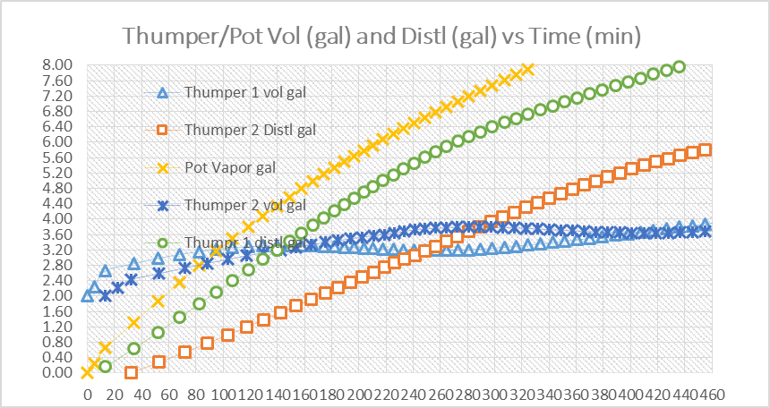

Here are details of this type of run. We will start with 14 gal of 30% ABV in the boiler and 2 gal of 10% wash in both thumpers. The boiler power will be steady at 2000 Watts.
Input Data
Results
You can see the steady distillate ABV and its gradual drop and very steady cumulative product ABV over the entire run time.
Estimated Hearts made were about 4.6 gal at 74% ABV with Tails starting at about 40% ABV out the spout at 450 minutes run time from the start of the pot boiling.
The volume in the both thumpers rose initially from 2 gal up to 3.6 gal, then were steady ( almost flat ) for most of the run time. A Good Result also.
The liquid ABV in the last thumper has a gradual rise, then steady, then a gradual drop. This vaporizes to give the steady distillate ABV.

You and many others might be sorry you asked this:
My calculation of heads, hearts and tails - best calc that I did for this version is this - it is based on studying many posts:
1. Calculate the total amount of alcohol charged = liters L of alc
2. 20% of that is the alcohol in the heads - volalcheads - in liters
3. Headabv = cuml abv after 2 steps of thumper 2 = abvheads
4. Heads L volume = volalcheads / abvheads
1. From the ongoing run calcs - you know the total volume made when abv out the spout goes less than 40% abv - call this the start of tails - some do more than 40%, some less so we have - Tails start L Volume
2. Hearts L volume = Heads L Volume - Tails start L Volume
3. Tails L volume = Final Total volume - Tails start L Volume
So now we have the volume of the three cuts and heads abv. The other abv's are more complicated, and not exact, but the best I could estimate at the time:
1. Estimate the Tails abv - ? ( tougher to do - did this equation ) =
( 40 + abv out spout at end ) /2 = Tailsabv
this can be improved on - with a more detailed calcs
2. Calc the total ethanol L out = Final Total alc L out * cuml abv out
3. Calc the ethanol L in the heads and tails - since we now know the heads and tails volume and abv
4. Ethanol in the hearts = Total ethanol L out - ethanol L in the heads and tails
5. Heartsabv = Ethanol L in the hearts / hearts L volume
If I run a case and stop the run at the end of hearts ( when tails start when abv out the spout goes under 40% ), so no tails are made. Then look at the calc of hearts abv, I get about the same result as this calc above when run went into the tails. So calc is ok but could be improved by better estimating the tails abv. Also, I could let the user decide how much abv out the spout to start the tails.
I did a stop the run at the 40% out the spout with the insulated first case above and got 2.4 L of alcohol out vs 2.62 L before above. So not exactly the same.
I did a stop the run at the 40% out the spout with the uninsulated second case above and got 3.2 L of alcohol out vs 3.3 L before above. So not exactly the same, but close.
The comparison : 3.2 / 2.4 = 1.33 - so, 33% more alcohol this time. We get the same conclusion as above.
zach, so due to your question, I may go back and do a more exact job of estimating the Tails abv. PM me if you have more questions on the calcs.

Wow haggy! Thank you for the explanation.
With your model, the first 20% of the ethanol in the ferment is consider heads.
Then when product condenser outlet reaches 40% abv, the remaining collection is tails.
The volume collected between the two cut points is your hearts. I can see how someone who has a consistent process can make cuts by volume.
Sometimes I detect tails at 50% abv at the spout. I might choose to keep these or not depending on what I'm making, but I think the 40% abv is the right order of magnitude. We all keep some of the heads and tails unless making a neutral spirit.
haggy

Yeah, thanks
I could make it user friendly if someone wants to use this Two Thumper browser file.
Could have an input data on amount of heads - initial value at 20% of total alcohol
And an input data on when tails start - initial value at 40% out the product condenser
But, in reality, Cuts are usually done by taste and smell - this is just a guideline
