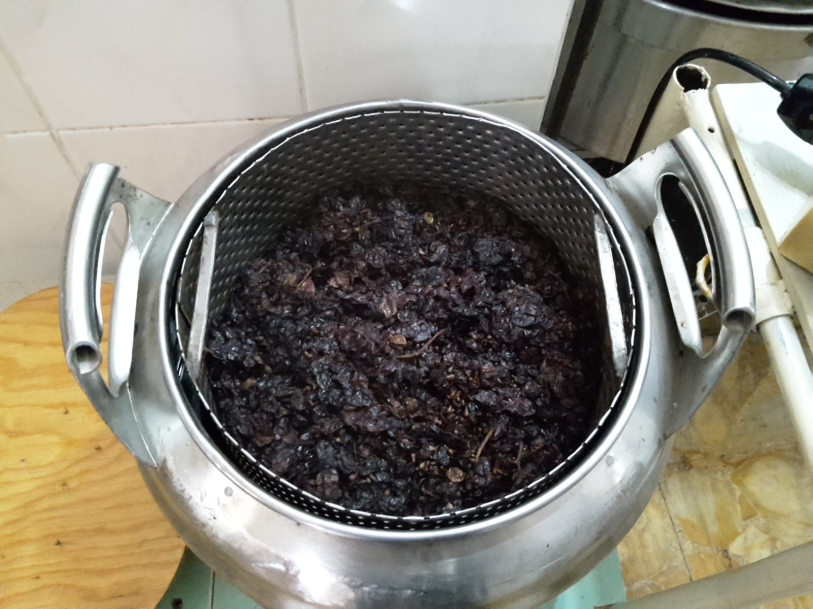

I put the marc in a stainless steel basket that I built raised above the water

This is the live system, as the steam rises

Nice set up. How many kilos of marc can you fit in the basket? What is the normal collection per run? Do you double distill?
What kind of grapes do you usually get?

Hi, the basket is very small compared to the amount of marc I have, it is 20cm high and 27cm wide. The grape is a mix of varieties including a very small part of white grapes. With this small basket I had to distil a lot of marc, I didn't weigh it but I think it was about 100 kg.

Hi Demy, This DIY basket is a very good idea for stripping on the pomace with an element. I think I'll look into making a nice sized basket out of some sort of expanded SS mesh that has legs to get it standing over the element.
Thanks for the inspiration!

Hi jonnys, mine also has 3 height-adjustable legs (screw and unscrew). I got mine starting from the plate of the drum of a washing machine (they already have holes). My set-up is too small for this job but I had to adapt. I also distilled with dipped marc (mix of a lot of water and marc) but I didn't like it, so I thought about this. There is a lot of room for improvement ...jonnys_spirit wrote: ↑Tue Oct 13, 2020 7:07 am Hi Demy, This DIY basket is a very good idea for stripping on the pomace with an element. I think I'll look into making a nice sized basket out of some sort of expanded SS mesh that has legs to get it standing over the element.

Hu Demy, My still has an 8" opening on top with maybe a 16" boiler diameter so It'd be fairly tall and skinny but yes SS screws w/some bolts for the legs and can either solder it closed or probably use SS wire to thread it "tight enough"... I usually use the pomace lightly pressed and refermented with with some sugar and/or cheap wine kit to boost the output because I don't ever have enough pomace. I've found macerating feints and low-wines in pomace to help with extraction and even macerated some pomace in the final cut with some oak and filtered it when ready to drink.
I really love the flavor that the pomace brings so always looking to maximize that. I'll get my thumper set up some day but I also love this method as an additional tool.

There are many possible variations on how to distil pomace, a thumper would be a great alternative. I distil little stuff (usually) that this was an idea born at the time. I know it is also distilled in bain marie but I don't know if in that case it is added with water. I was offered a lot of pomace from relatives but I couldn't really distill so much with my system. With that little basket I had to do a lot of charges, I think I distilled 100 kg or more.jonnys_spirit wrote: ↑Tue Oct 13, 2020 7:59 am Hu Demy, My still has an 8" opening on top with maybe a 16" boiler diameter so It'd be fairly tall and skinny but yes SS screws w/some bolts for the legs and can either solder it closed or probably use SS wire to thread it "tight enough"... I usually use the pomace lightly pressed and refermented with with some sugar and/or cheap wine kit to boost the output because I don't ever have enough pomace. I've found macerating feints and low-wines in pomace to help with extraction and even macerated some pomace in the final cut with some oak and filtered it when ready to drink.

I wish I could get my hands on grape pomace like that...also cool basket setup
