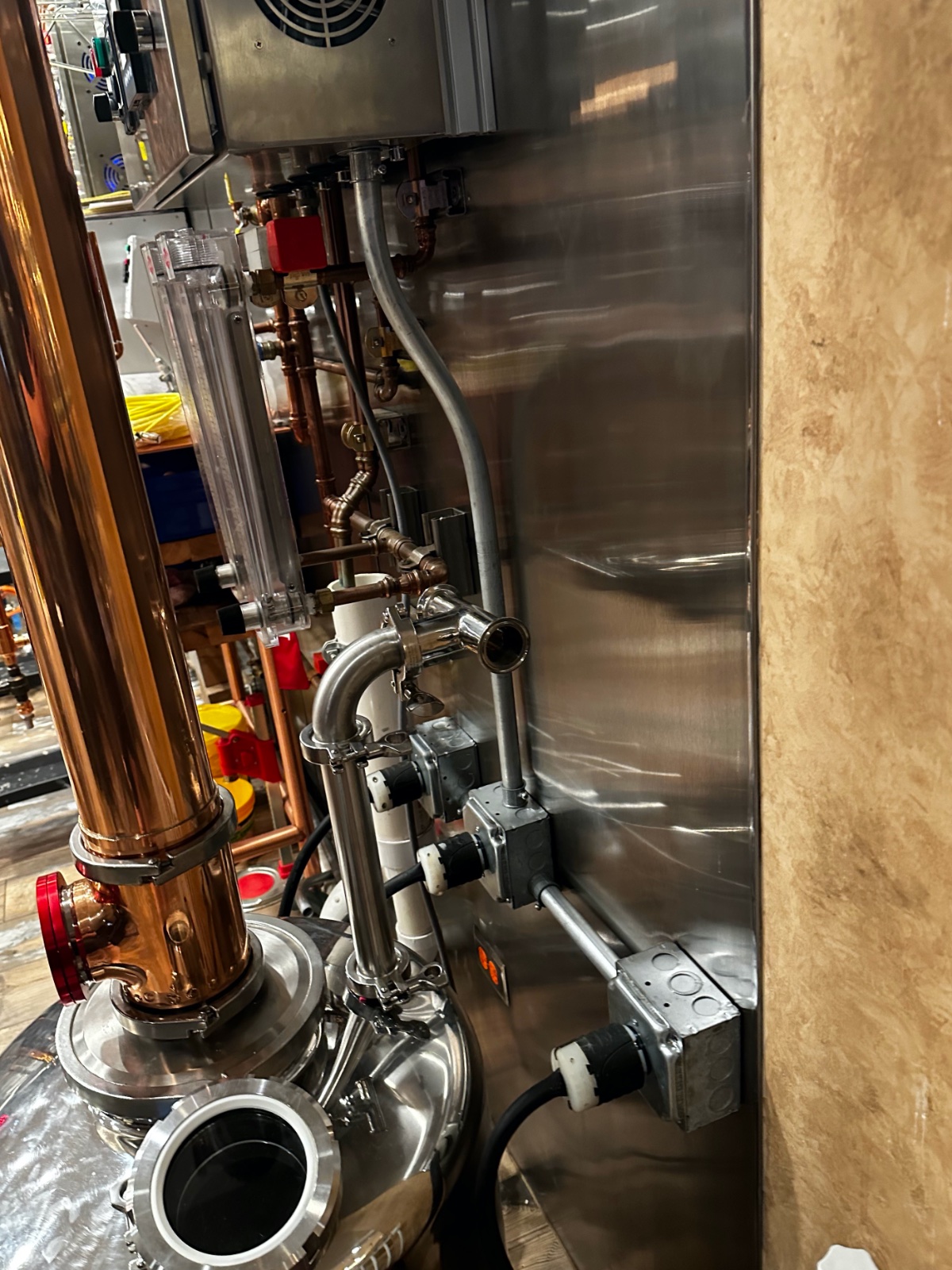

I have finished the control panel with exception of cleaning and tightening my wire management in the box. I have finished the wire management on the door. Hopefully I will finish the box side tonight. The power inlet and outlet of the box is all in conduit with three dedicated outlets for my elements.
I still need to finish all my 1/2" copper for condensers and clean in place.
Install thermometer cords and tie off. Complete the 1 1/2" drain.
Hopefully one to two more weeks depending on free time.
The still copper is complete, polished, powder coated (clear), assembled and packed.I still need to finish all my 1/2" copper for condensers and clean in place.

Ok I finished the wire management for the control box tonight.
One step closer.
I appreciate the sentiment yummyrum.
I love building this stuff and when I first started I would draw out complete schematics. Now I just lay out all my components and just start wiring. It’s all in my head and actually very meditative.
One step closer.

OK it is mostly done. Just missing a couple of pipe clamps and the blow off pipe for the relief valve.
Other than that I have done a water run and everything seemed to work the way it"s supposed to.
I have a large batch of Shady"s ready to strip in my other still and will pick up some vinegar this week so I can do my cleaning runs.
I won't be able to do the cleaning runs until weekend after next because we are hosting our sons graduation party next weekend and my better half has shut down all my extracurricular activities.
In the meantime here are some pics.

And here is the finished still and control panel.
The gauges and clocks don't photograph well and are properly illuminated when viewed.

Ok it’s been awhile as I have not done much distilling this summer. It has been a busy summer and a hot one, didn’t need to add a bunch of extra heat to the house.
So sorry for the delay but here it is.
I did my cleaning runs shortly after finishing the build and spent some time learning how it wants to be run.
I recently ran 24 gallons of Shady’s Sugar Shine low wines at 40% ABV
I did a slow ramp up to full power over 15 minutes.
Full power = 26.5, 18.5 and 18.5 amps @ 240 volts.
It took approximately 30 minutes to come up to temperature to produce vapor.
I turned down the power to 18.9, 14 and 14 amps and let column stabilize for 20 minutes.
After 20 minutes I turned down the flow meters to 0.13 gallons for deph #1, 0.7 gallons for deph #2 and 0.59 for the product condenser.
I produced 1.75 liters approximately every 15 minutes +/- of 95.6% ABV for the first 16 jars it then slowed down from 16 all the way up to 26 minutes for the last 4.5 jars when I shut down. The last jar (only 1 liter) dropped to 95.1% ABV.
I didn’t change the power or reflux throughout the run and just let it do its thing. Btw the reflux pump was set at 516 on the controller throughout the run.
This is a very slow setting as the the pump maxes out around 4200.
I probably could have used a smaller pump but the extra pumping capacity was appreciated during the clean in place procedure.
I am very happy with the results and believe with more experience I might be able to dial it in a little better.
I really enjoyed this build and am contemplating starting a separate company to start building equipment. I have thought about making a 6” version and even making a third column but that is outside hobby size but could work out well for a craft distillery.
Here is a screenshot of the Anton Parr EZ Dens.

Or would I go from the 3 to the 2 and from the 2 to the 1?
- Posts: 13027
Re: Pumped Reflux Side Column CM Still
3 to 2 and 2 to 1
By passing the otherwise naturally occurring temp gradient can make the still behave badly.
