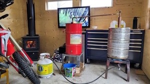

My new and improved setup, I bought this column off of ebay and when I was trying to charge my boiler as fast as I could the top of the column popped off. Should I keep it slow and steady for every run? Everything is working but I could push it a lot faster with this propane burner....

I have no idea why the pic is inverted

I could soilder a cap to my column, but obviously that would build up pressure, any thought?

I just google moonshine columns and none of them have a rubber pop off top, so I think I'm going to soilder a cap.

Moonshine31 wrote: Tue Nov 21, 2023 10:11 am I have no idea why the pic is inverted
Operator error.
Moonshine31 wrote: Wed Nov 22, 2023 3:38 pm I could soilder a cap to my column, but obviously that would build up pressure, any thought?
It’s a potstill. Therefore, the copper riser from the boiler is NOT a column …. it’s a RISER. Columns are on reflux stills and columns MUST HAVE a reflux condenser. Yours doesn’t. The cap holds your thermometer (which you don’t need in a potstill anyway).
And yes, potstills do build a little pressure to overcome the pressure drop in the piping (riser, lyne arm, and worm). It may not seem like much, but it is enough to blow off your rubber cork. But, as it does it may become a danger (explosive) concern.
One source of pressure build up is the worm. How big is the worm, ie - length and tubing diameter? Also, the lyne arm is small diameter as well. All this is aggravated by heat input power and vapor production rates.

Moonshine31 wrote: Wed Nov 22, 2023 3:41 pm I just google moonshine column.
Probably the very best way to find all of the wrong advice......its not a column just for starters.
Anyone that is dishing out information on "moonshine columns" more than likely doesn't know their arse from their elbow when it comes to stills.
Other than that , that's a nice little still there.......get it sorted and it will make you some good spirt.
