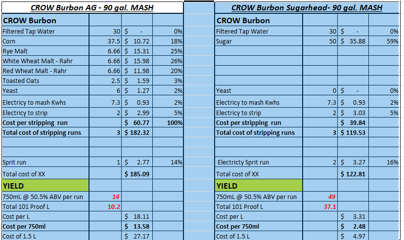

I’ve finished my 2023 Winter project of CROW All Grain (AG) + CROW Sugarhead (SH). I thought I’d share my finial results with the group. This was my 2nd ever attempt at AG and my 1st ever attempt at Large Batch. The final results did not come out as good as I had hoped, especially for the AG. I’m Ok with my results, I plan, (Hope) to do better next year. I did learn a lot through the process.
My process changed from Batch #1 to Batch #3. As you can see I got a lot better with my Mash and Stripping Runs from Batch #1 {AG =2.75 gallon + SH = 4.5 gallon} to Batch #3 {AG =4.0 gallon + SH = 7.3 gallon}.
I did put away 2.7 gallons of CROW AG in a BadMo and a 2L Mini Oak barrels. This is to be left alone to age. I also produced 9.8 gallons of CROW SH, this will be my Daily Sipping Shine, so as not to touch the AG.
• I’m thinking the reason for my low output on the AG was from my low SG numbers. I solved this on Batch #3 by increasing the amount of Corn I added to the Mash.
I fermented in a 44 gallon BRUTE trash can. I gelatinized the Corn in a 30 gal aluminum pot because I didn’t want to melt the Brute with hot strike water. I put the gelatinized corn in the Brute after it cooled down to around 150. Not the best of ideas.
• I have a Blue 55 gallon barrel now. I retiring the 44 gal Brute Trash can. I will be using SCD Easy Large Batch method next year with a 55 gal Blue barrel.
As for taste, The AG was the best, of course. It was good enough that I will try AG again. I have the AG is in Oak barrels for Aging. I promise not to sample any of it for at least a year (unless it’s scientific proposes). The SH turned out surprisingly good. It does have a little sugar bite, Not bad, but a lot of the grain flavor carried over. I’m going to enjoy sipping of the SH while the AG ages.
A big surprise was the finial XXX sprit run of everything that I had left {Feints from the AG and SH + some SH Low Wines}. I was tired and almost didn’t run this. I wasn’t thinking it would be that good. It picked up some of the thick smoothness from the AG and tasted better than the pure SH-XX, not as good as the pure AG. I’m happy.
I also keep up with my cost between the AG and the SH. The AG came in at $13.58 per 750ml. The SH came in at $2.48 per 750ml. I could not have done the SH for that cost without doing the AG first. I know I can do better next time and bring the cost of the AG down.
I’m breaking the still down now, cleaning it up and packing it away until next winter. I’m happy with this run. I know it wasn’t the best. I did learn a lot. I sure I can better these numbers on my next go round.
