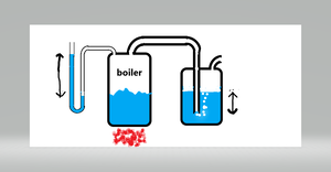

fiery creations wrote: Sat Jun 22, 2024 12:25 pm I’m trying to understand how it works
This is one of Shady's pics. The monometer is circled in red. No steam flows through the manometer.

fiery creations wrote: Sat Jun 22, 2024 12:25 pm Beautiful. I’m trying to understand how it works
So you have the right one full of water, heat it to generate steam. And it pipes into the column and down intoyour boiler full of mash? How does the steam heat the mash without escaping? Wouldn’t it just blow out the condenser and water down any distillate?
How hard is it running that, since I’m guessing all you can do is adjust the vapor speed of the water steam?
I'll try to answer that until Twisted gets around to saying it better than I can. :lol:
There's a shit load of energy in steam
When the steam hits the liquid in the thumper, the steam condenses and gives up its heat.
If everything is designed right, very little or none of the steam breaks the surface and escapes.

fiery creations wrote: Sat Jun 22, 2024 2:44 pm Ahhh ok. So it’s pipes in to the bottom of the grain mash through the wand. Basically turns back to water transferring energy and heating it up. So if you’re constantly adding water to your boiler, that’s gotta affect something right?
Trying to visualize it. The pot gets more water heavy throughout a normal run. This would add even more and cause the BP to increase and essential dilute your mash throughout the run? AFAIK more distilleries use a steam jacket and not a wand directly into the mash?
That's exactly it. So don't fill your thumper to the brim or at some point it'll overflow. The steam injection heats and adds water, but the heating happens fast enough that the additional water isn't an issue. A good wand design will also stir the mash ensuring even heating.
In an ideal world you want the tube running to the thumper to angle back towards the boiler so that any condensation will flow back to the boiler not into the mash.

NormandieStill wrote: Sun Jun 23, 2024 5:25 pm
:thumbup:
Dilution isn't that much of a problem, what is important is to strip the alcohol out.
Having said that, anything that mitigates dilution is good.

Does the manometer have to dip below the boiler? I’m not understanding why it would need to.

fiery creations wrote: Mon Jun 24, 2024 7:54 am
The mano can be above or below the boiler.

Born_Free wrote: Sat Jun 22, 2024 1:35 pm
I would think steam like water follows a path of least resistance. I believe that manometer would blow with that much in the thumper, especially if it was a mash in there.
Posts: 11618
Re: New steam rig and manometer test
A rule of thumb is to have the mano 1.5 times taller than the highest liquid level in the thumper.
That way the steam goes to the thumper. Instead of venting out the mano.
My first pic didn't show that so here is an update to show it better. :oops:
There's only a tiny difference between the weight of a liquid mash and water.
If the level is the same, it takes the same amount of pressure to blow bubbles in either of them.
