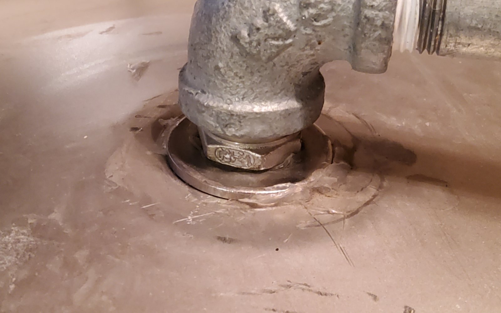

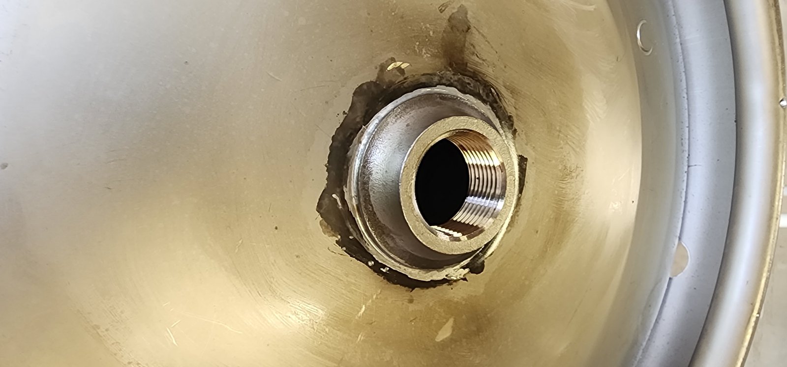

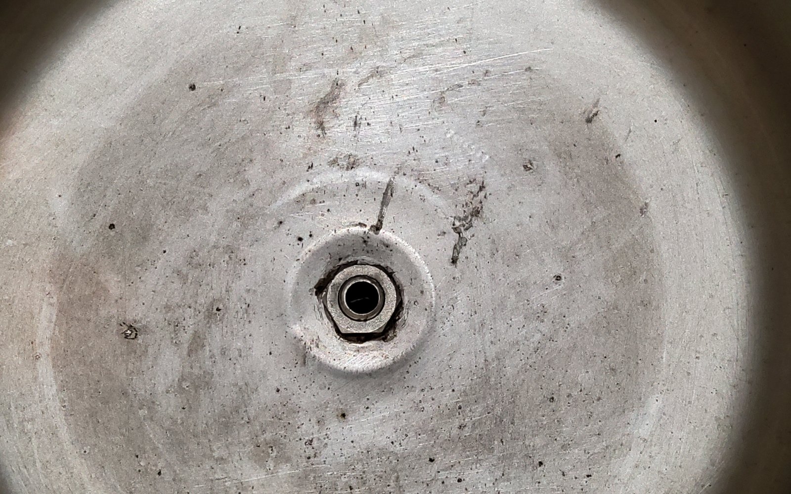

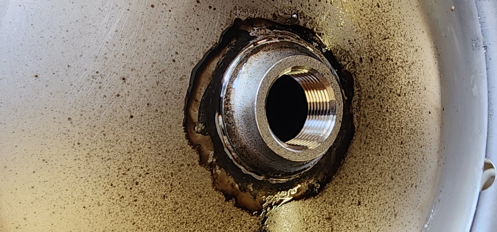

I picked up a used boar keg this past weekend. There was a half inch bottom drain that was put in with a fitting with silicone. Also there was gavin on spike used. The plan is to go back with a one inch weld spud and new piping all out of stainless. The fittings in the twelve inch Pipe nipple have m p t threading. What can I use to prevent gawling? I need something that's gonna seal and is safe..

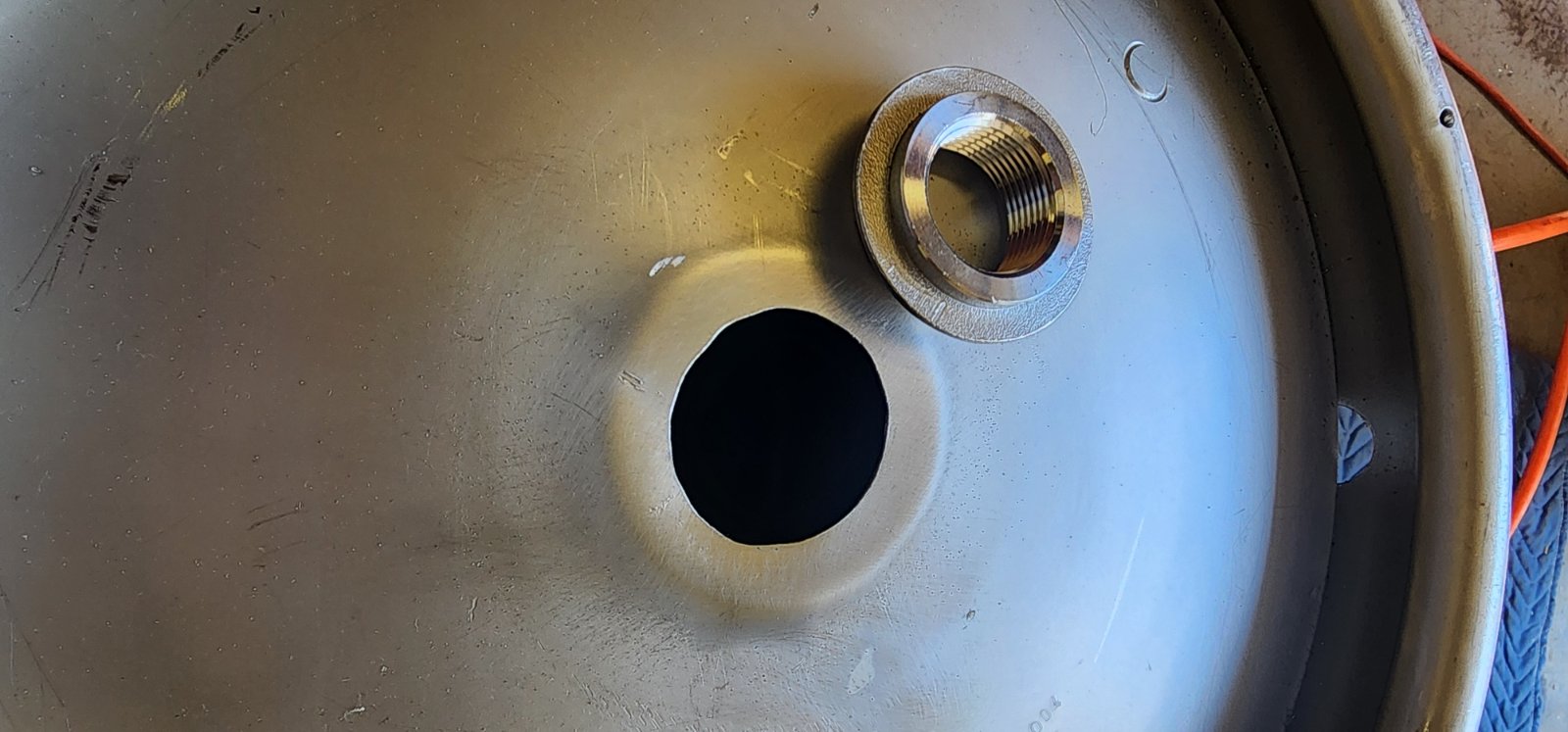

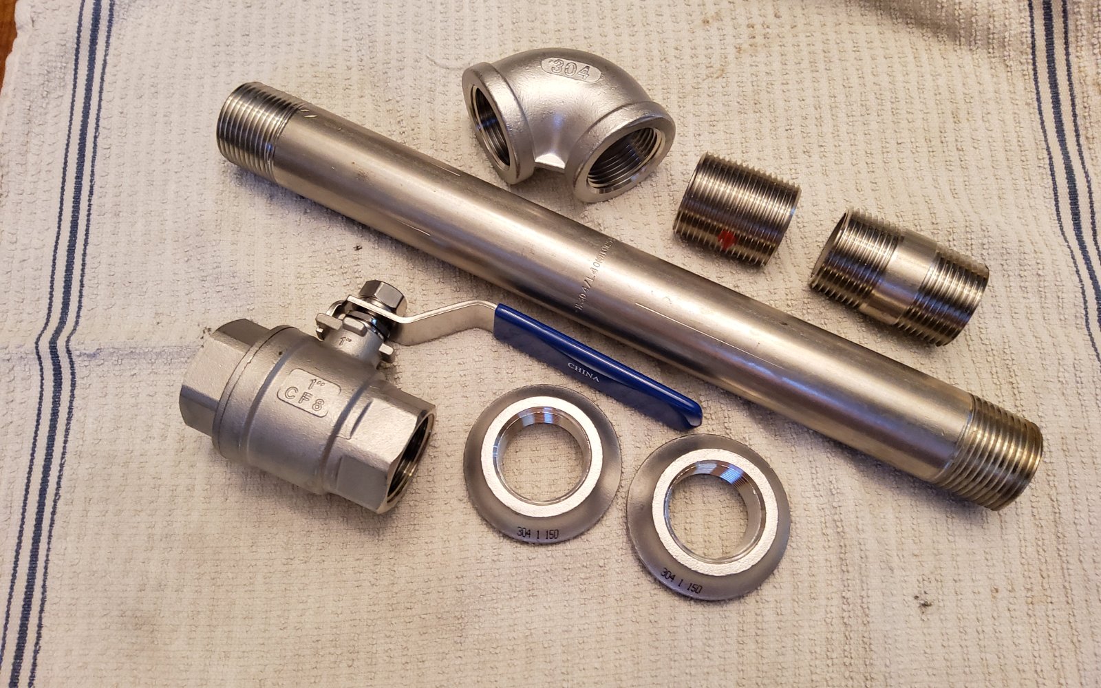

All the parts came in and today's the day. If I can find my solder and flux. I went with one inch drain and all the parts come from supplyhouse.com .

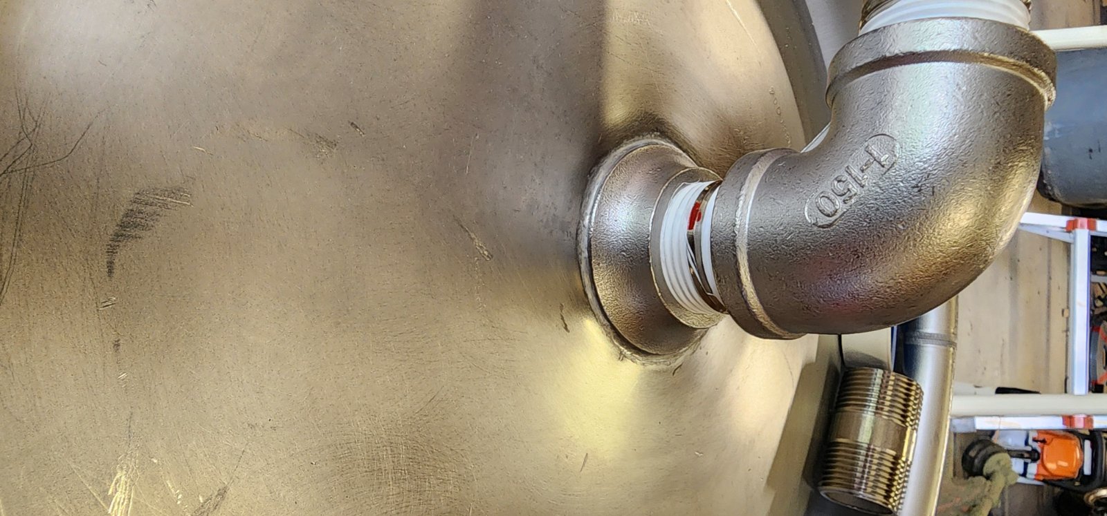

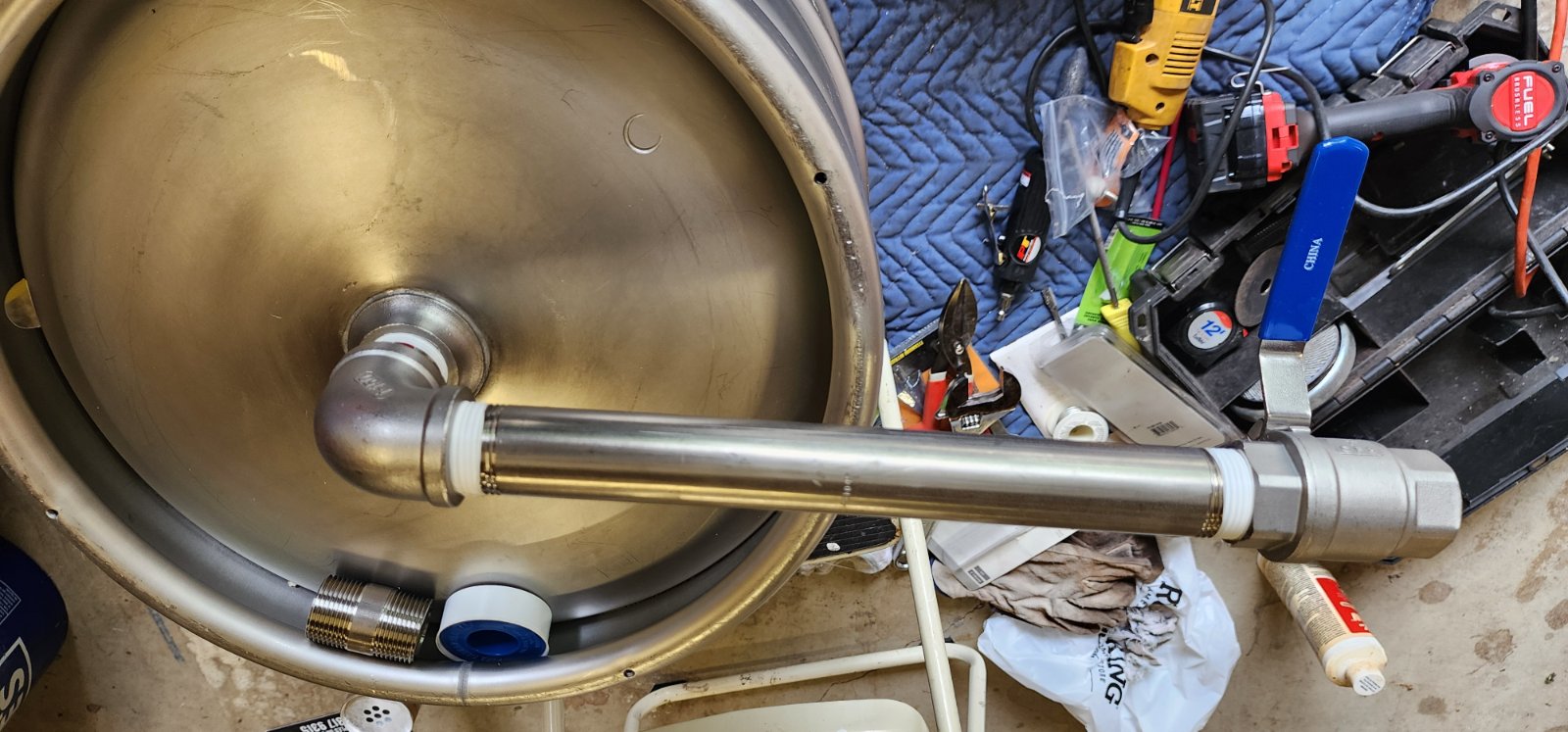

It took several hours to find everything that I needed. And of course I had to get the wife involved and she finally found my liquid flux. The only thing left is to let it cool clean it, put everything together and do a leak test.
Sailman
Posts: 460
Re: A refit on a used keg drain
Post by Sailman »

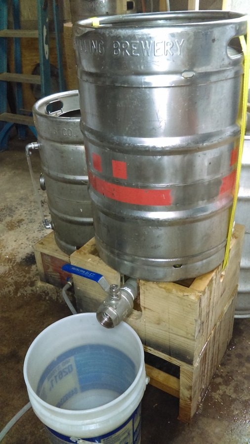

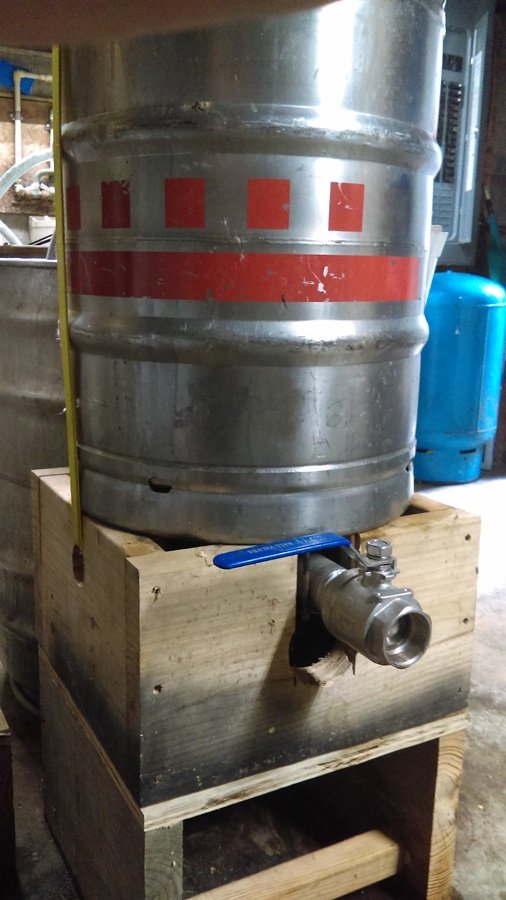

Got it all put together and about half full of water.I've got to go to the hardware store and pick up some lumber.I'm gonna make a wood stand. So far so good no leaks.

Real nice job man, that should last forever.

Man, that's a clean solder joint, good job, Sailman
