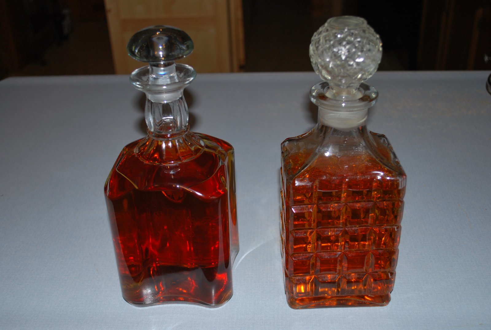

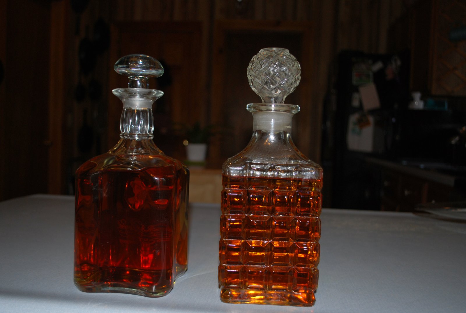

It's funny I've been doing this about 3 yrs now and this is my first bottled product. My UJSSM I don't age or dilute (moonshine). My rum I don't dilute, kinda use it like 151.
The sweet feed whiskey has been aging 13 months. I aged it 2 different ways to see which I liked better. I bought some French oak cubes, med toast. I did half in a glass jar with those. I did the other in a 2L oak cask that had been filled with rum (I know, backwards, oh well).
It was my first time diluting and I was really nervous. I have read how it goes cloudy on some people when they add their water. I also read the calculators aren't always accurate. After all that work and over a year aging I didn't want to mess it up.
I diluted with distilled water and absolutely no clouding :ebiggrin: I used the calculator as a guide. It told me to add 5 cups of water so I started with 3 and added 1/4 cup at a time until I got to 40%. I got over a half gallon of each.
After sampling both, my husband and I both liked the one aged in glass. When both samples were almost gone, he dumped them into one glass and that was really good! I think I will keep them separate though and maybe mix them when I want.
Here's a picture, you can see the difference in color.

Looks Awesome Sadie... Love the colors on the left.
Care to share you and your husbands tasting notes on either the sweet feed, rum or the ujssm (I know taste is subjective) Just curious what you came up with.

BlackStrap wrote: Wed Apr 30, 2025 3:26 pm Looks Awesome Sadie... Love the colors on the left.
Cheers!!
Stay Safe & Have Fun
BlackStrap
Thanks BlackStrap. I forgot to mention the one on the left was aged in the oak cask. Hmmm...I didn't take notes on the tasting. I took notes on every step, even the diluting, but none on the tasting. We just pour, drink and enjoy! But now that you mentioned it, I might have to take notes on tasting, I guess that is the most important thing.

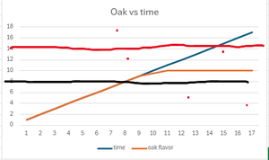

Over oak has two factors, amount of wood to product volume and time. But the amount of wood has to be above a certain threshold to over oak. That amount is dependent on each persons taste. For me I know it is some place above two oak fingers in a half gallon jar. I know have product that has been on two fingers for three years and just gets better. I am convinced it could stay on that wood for 20 years and never get over oaked because there is just not enough oak to push it there. If I could graph it the oak flavor vs time would be a line that ramps up for a year or so and then levels out flat as the oak available has been extracted (see below). As long as the line levels out below the oak favor level you consider over oaked you are good. On the other hand if there is enough oak to drive that line above your "over oaked" flavor threshold then time comes in and you need to remove the oak before it crosses the line. If your flavor threshold is the red horizontal line then it will never over oak. If your threshold is the black line then you have a certain amount of time before you need to get the product off the oak. Ignore the red dots, user error there.

sadie33 wrote: Wed Apr 30, 2025 3:19 pm It's funny I've been doing this about 3 yrs now and this is my first bottled product. My UJSSM I don't age or dilute (moonshine). My rum I don't dilute, kinda use it like 151.
Very nice looking bottles Sadie, we would call those "Decanters" here in the UK.
The one on the left has a beautiful deep colour! I get a similar, slightly red hue when I soak my used staves in red wine and dry them out before putting in my product.
