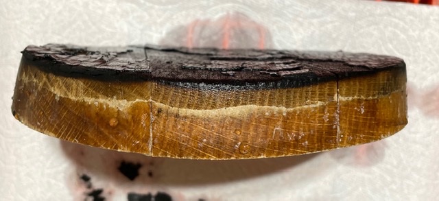

I've made 2 'used oak' heads from once-used barrel staves for aging single malts. I cut them to about 10" lengths, and using the inner face against the fence I jointed the edges square. After assembling 3 pieces with dowels and beeswax I run them thru the planer to flatten the outer face before cutting the circle. I do nothing to the inner (charred) face. There is still plenty of thickness left, so if I want 'new oak' heads I'll either plane or scrape the inner face, taking off most of the char, then will re-char them.
I've made 10 of them now - 6 the same size as Badmo's (8L), and 4 half the size (4 L). Before I got the used staves I imitated a used barrel by adding about 150ml of 95% neutral and storing it head down for a month, then adding another 100 ml of water (diluting to about 60%) for another month. I surmised that this process would extract a lot of the 'new oak' character rather quickly and make it more like a 'used oak' barrel.

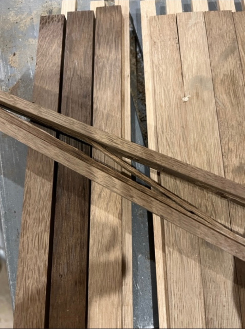

So I did some work over the past two days. I cut all of my Staves and put them in the oven for toasting. The attached photos show the checking that happened through the process. Here is the visual proof of why we must use quarters Sawn wood. It’s rather unbelievable.
I thought my plan was foolproof therefore, I made all of my staves and cut all of the grooves. I learned when I went to assemble that the cracks in these rays are very very deep, almost all the way through the staves. Unfortunately, when I inserted in my floating tenants, all of these staves simply cracked in half.
The pictures of the cracked staves are both the same piece, only rotated 90°. You can see how the cracks appear along the rays.

Tonight I was planning on cutting new 2 inch staves and just using beeswax between them. As I was disassembling yesterday‘s mess, I noticed that my staves with only a single groove were not split. If I have the structural integrity for 1/4 inch deep groove, I should be able to get away with two 1/8 inch deep grooves.
So that’s what I did tonight, I shortened my tenons to a quarter inch and put a 1/8th inch deep x quarter inch wide groove. We have success….
Next up, beeswax and cut it!

Wow, that's quite the journey you've been on with the staves! It's amazing how something like wood grain can have such a big impact on the final product. Thanks for sharing your discoveries and the photos—it's a real lesson in the importance of quarter-sawn wood.wanderingnunical wrote: ↑Tue Oct 17, 2023 5:06 pm Tonight I was planning on cutting new 2 inch staves and just using beeswax between them. As I was disassembling yesterday‘s mess, I noticed that my staves with only a single groove were not split. If I have the structural integrity for 1/4 inch deep groove, I should be able to get away with two 1/8 inch deep grooves.
It's great to hear you found a workaround with the shallower grooves, and I'm excited to see how the beeswax and final cut turn out. You're getting close to having a complete head, and that's really cool to see.
Keep up the great work, and please continue to share your progress. If there's anything I can help with, just let me know!

Well team, I have given up on my design for the time being...
Dealing with that many staves creates a very unstable barrel head which is difficult to work with.... this was expected and I had a trick up my sleeve to handle it. The trick is to create a perfect size circle out of 1/4" plywood and glue it to the barrel head separated by a piece of paper. The result is a fairly strong bond that can be easily separated in the future. I then tried to use a flush trim bit on my router to finish off the head.
Long story short, the paper glue technique isn't strong enough to withstand the power of that router bit. AS I approached the short end staves, pieces started flying. 1/5 stars, would not recommend.
I moved forward with a three stave rift sawn design utilizing floating tenons and will monitor losses.

Could you just put a couple of perpendicular staves or other boards across the front? Use stainless nails to attach the staves. Similar to how stakes are used on the side of a older wooden box grain truck.wanderingnunical wrote: ↑Wed Nov 01, 2023 11:55 am Well team, I have given up on my design for the time being...

I considered similar methods, but in tbe end I asked myself if i NEEDED quarter sawn wood if i chose my pieces carefully. Seeing as how we are dealing with a few quarts and not 55 gallons, I figured it may be good enough.
The circle is better cut on a tablesaw vs a router. I suspect had i used that method the barrel would have been a success.

Do you know how dry that wood was when you toasted it again? I have found that wet wood will check a lot more than dry wood. You can’t really tell how dry wood is by looking at at. I uses a wood moisture meter and found that I start to see more checking when the wood is at 5% or greater in moisture. Wait until it gets under 5% and the checking should be reduced.wanderingnunical wrote: ↑Tue Oct 17, 2023 4:50 pm So I did some work over the past two days. I cut all of my Staves and put them in the oven for toasting. The attached photos show the checking that happened through the process. Here is the visual proof of why we must use quarters Sawn wood. It’s rather unbelievable.
I have forced air heating in my home. I found that stacking dry wood over a vent with moving dry air for a few weeks was a simple way to dry out the wood enough for toasting. It would take weeks to go from 7% to 5%, so you have to be patient. With your smaller pieces, it should go quicker.
