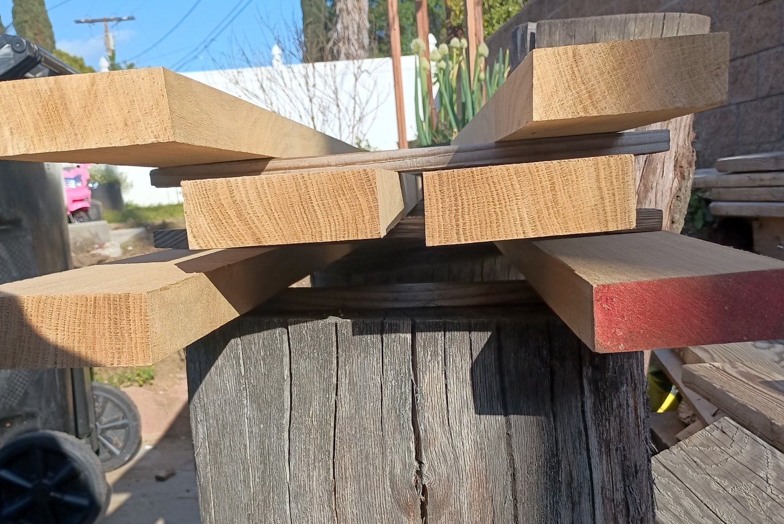

Hello everyone. Long time reader. I finally bought my fresh sawn 6/4 white oak QS and ready for weathering. I was also lucky enough to put in what looked like the last order of white oak available on the BadMo site
for a quick head start.
Question on seasoning and orientation of stacking. Do they need to be stacked perfectly flat? And which of the two orientations attached is better?
I am in Los Angeles area, we don't get much rain around these parts except for this winter ironically. Should I water them every now and then? Cover temporarily to promote that mold growth while wet?

is the grain ok on those for using on a barrel?
i assume you intend to make heads for a barrel.

Those are great looking QS boards.
I've made a dozen badmo clones with some previously aged qs white oak, but never aged it myself.
I would not worry about flatness - your individual pieces will be around 9" long after cutting to make head blanks.
I would stack them like in your last pic, or maybe on edge side by side, and I would hose them down for a few minutes every week that it doesn't rain.

I am starting see some checking along the sides of the boards. I have them sitting on the edge like you mentioned Higgins. Is this normal and am I just being paranoid? It did rain this weekend.
- higgins
- Posts: 598
Not sure what to tell you as I've never dealt with curing wood in such a dry climate. Do the bottom edges have checks too? If so then wet them down more often. In the states bordering Kentucky where a bunch of Stave Mills exist the humidity is much higher, and get 45-65 inches of rain per year so wood doesn't dry nearly as quickly as it would in LA. And they do stack them flat, so maybe that was a bad suggestion.
I think the checks develop in the medulliary rays, so as long as the checks are on the edge I think they should close up and seal when wet. If they are on the face they might seep a bit, but may still seal with barrel candy.
I have two I made with a thinner face and they do seep a bit thru the face in hot weather.
