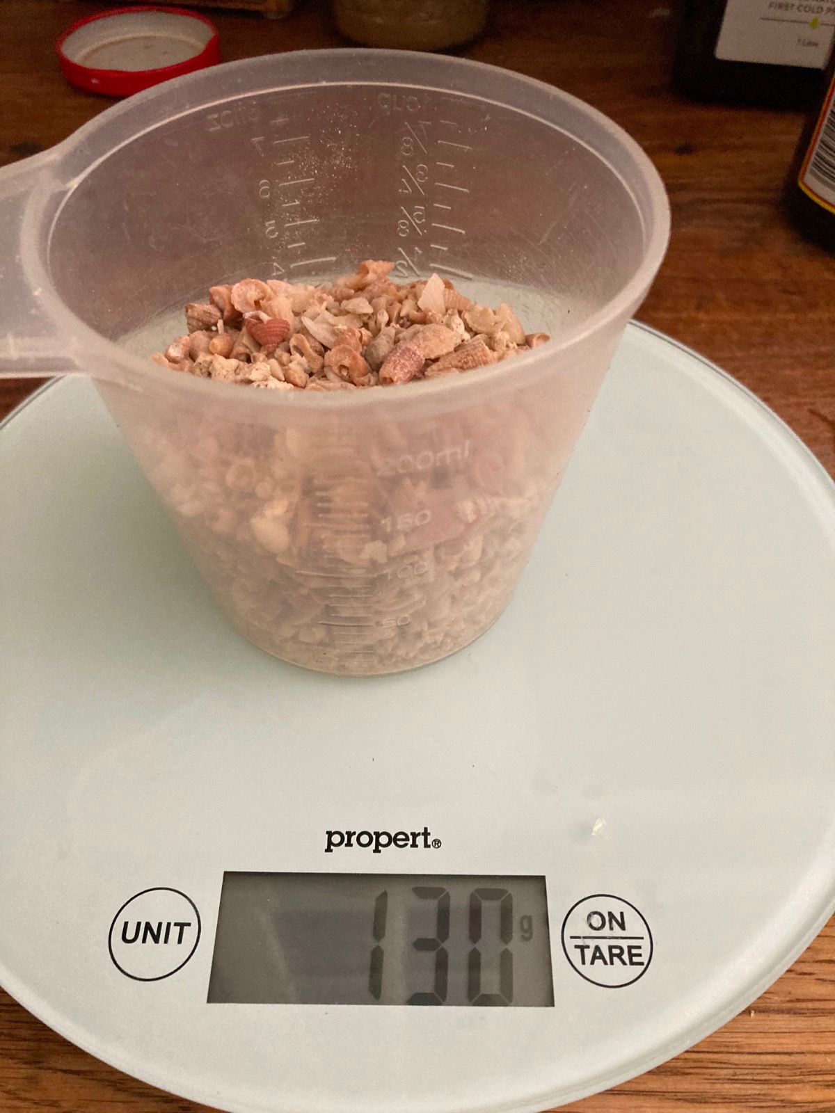

One question though how much is half a cup just an ish on grams would be great.

1/2 US Cup of crushed oyster shells is about an handful. Don't fret about the volume/weight ... you needn't be exact when adding oyster shells.

Like greggn said, don't sweat the amount. You can't have too much, but you certainly can have not enough. I believe this was mentioned previously, can't remember, but there's a topic where a guy put a big slab of marble I believe in his wash and reused it over and over again. Don't think of dosing with Calcium Carbonate like in a recipe. Use an abundance because it works, can be rinsed, dried and reused.

1/2 a cup weighed in at 130g .
I’ve got tiny hands for a bloke , LOL , it’s about 1 and a half handfuls for me :D …. I’d use two to be sure .
