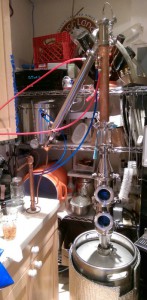

hi humbledore I have recently made a still head that looks like youer original drawing. I have not tested it yet buy I will let you know how it works after
here are some pics of it

Looks like you are not planning to move the coil..so it's not a CCVM.
You want to run it as a CM and regulate the cooling flow with that valve on the inlet side to the condenser?
Nice work by the way.. :thumbup:

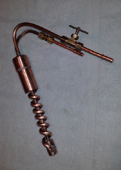

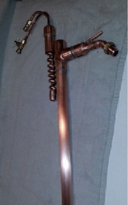

Some more progress. I decided to go out the side as suggested by Hound Dog. It was a bit tricky but I got there. It was interesting trying to figure out the right sequence of alignment, insertion, and soldering different parts.
Coil before placement
I soldered the top exit tube in place after inserting from the outside.
Soldered up including top ferrule. Tested water tight afterwards.
As I'm looking at it, again, the only disadvantage here is height. It's pretty tall, like 15".

OK blueduck updated on his still, here is an update on this csst build. I finished it up using push to connect tubing and fittings from mcmaster. It ran great. I need to get better at running a plated still but that's beside the point. I think this could have been significantly shorter...there's at least 48" coiled up in there. Pretty sure you could get by with less and have less overall height as well. I don't look forward to modifying it, it was a pain to put together. But then I imaging a standard shotgun dephleg would be the same.

Nice job mate :thumbup: , what's the blue colour inside?, looks cool!. Can you cut that ss tube stuff to shorten it?.

Thanks all. Nothing too amazing here, mostly bought parts. Googe I don't know how that blue is there, it's something to do with reflections or the camera. It's actually quite dark in there, have to use a flashlight to see much. Dad I have done two runs, but the first one that "mattered" was all corn, and I ran it too hot and smeared the crap out of it. I am used to keeping reflux cooling output at a certain temp. Having never run a cm I didn't quite grasp the dynamic so I was all over the place. It is a harder type still to run but that's the fun of it isn't it?
