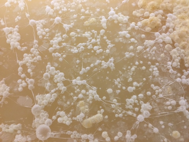

Not all infections will form a pellicle and some bacterias take a really long time to produce acid. You might not see signs, but there's probably something going on, perhaps very slowly.

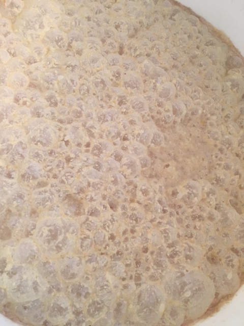

I pitched half with US-05, and the other half I divided into 4 buckets, threw a handful of raw rye into each bucket, and left them open for 5 days.
In 3 of the buckets I had what looked like bubble scum on top of the wort, signs of bubbling, but nothing active. The fourth bucket was just flat wort.
Yesterday I dumped in about a pint of the funk that I kept for myself into that fourth bucket and this morning it is actively fermenting, bubbling away nicely, pH about 4.0.
So, I've added the funk to the other three buckets and will see where this leads.

All 4 open buckets bubbling away. Smells good, too. I have a feeling you gonna like this stuff, Jed.
It will be interesting to see if the lacto drops pH too much, or if the yeast doesn't finish dry.
No idea how wild Michigan yeast perform yet.

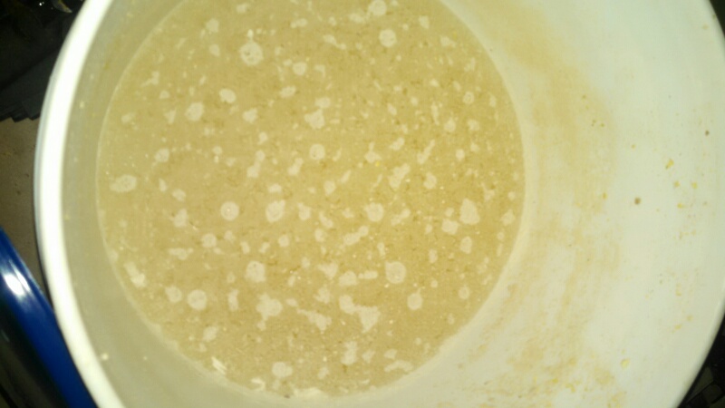

Here is what my bucket of Michigan corn funk looks like. Has some bubble activity and a lovely sour corn smell. Gonna be at least this weekend till I get to mash with it, if not next.
