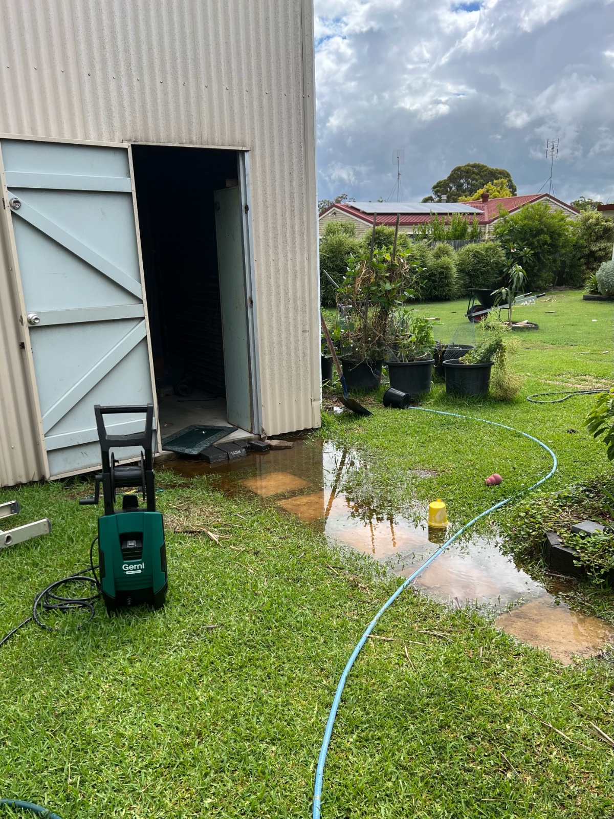

I love it Shady . Although I told myself when we moved here , “no more messes” :lolno:
I’ve got a storm water drain along the back which drains out to the street curbside to stop the shed flooding when we get a down poor . So I have to be careful nit to send too much Molasses mess down the street :ebiggrin:
(That white down pipe from the shed gutter goes underground to our 22,000l tank )
Speaking of drains , we just had 120mm of rain dump last night . Might need to add some more .
Looks like we lost a couple of ‘nanas too
