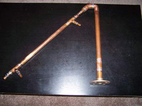

Here is an exact list of my still:
8 gallon polar ware brew pot
1" copper flange from mcmastercarr.com
(4) 3" X 5/8" stainless steel bolts from mcmastercarr.com
(4) 5/8" staniless steel nuts from mcmastercarr.com
1" 90deg copper
1" 45eg copper
1" X 1/2" copper reducer
1/2" copper tube
(2)1/2" to 3/4" copper tee
3/4" copper tube
(2) 1/2" X 3/8" copper reducers
some 1/2" rubber tubing for the liebig
some screw fastening tube holders for both ends of the liebig
Here are some pictures below, you can figure out the rest. I referenced mcmastercarr.com because this is the only place I could find these items. You will need to find someone to drill the holes in the boiler lid. If you don't know anything about drilling stainless you better get a professional to do it. Otherwise you will screw it up.
Don't pay attention to the soldering at the bottom of my still, it was just an extension of the column.
1" 90deg copper
1" 45eg copper
1/2" copper tube
3/4" copper tube

I looked up the flange on McMaster and they list it as bronze. To the forum, is there an issue with bronze? I have read many posts regarding "pickling" of brass to remove the lead. I don't recall seeing anything on bronze.
The reason I ask is one of our own here has asked me where he can get a flange.
thanks
WW
thanks
WW

Bronze comes in many different version. So the answer is that it depends on the composition of the particular bronze.To the forum, is there an issue with bronze?

The copper flange is cast bronze (cast copper). I called them and they said it is food grade and safe to use.WalkingWolf wrote:Cornwhiskey,
thanks
WW
- Posts: 5628
- Location: OzLand
Re: brewer wants to step up to still
Did you specifically ask if it was safe for sustained contact with high temp, high strength alcohols? Food grade does not automatically equal safe for use in stills.I called them and they said it is food grade and safe to use.
