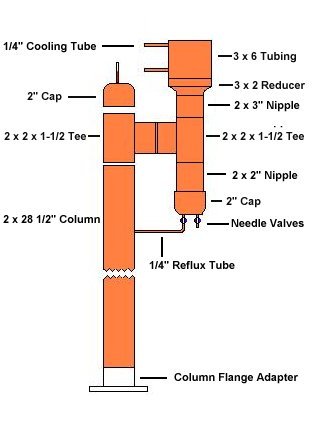

I have a Nixon Stone Offset Reflux still and I wondered if I put a basket with coriander, dill and orange peel into the horizontal connector between the reflux column and the condenser, would I be flavoring the distillate sufficiently?

Just use it in potstill mode. Put all the herbs in the boiler. Not in the column. Herbs will inflate upon water/liquid contact and may jam the column, creating pressure issues.
