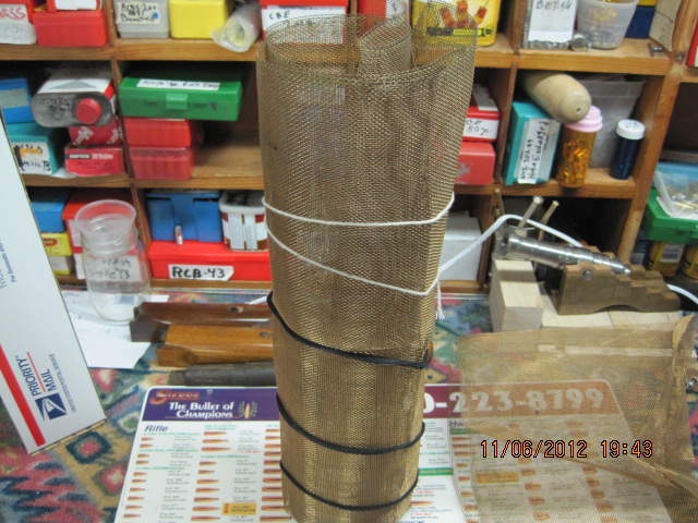

I also have a big roll of copper screen, what can it be used for in our hobby, Pic looks like brass, but its copper. Thanks- Joe

The copper screen could possibly work for column packing can you post a pic of the copper screening?

The copper screen. Are you sure its 100% copper? And not copper coated or something? I remember someone not that long ago getting some copper screen thinking it would work. And found out it was only copper coated.

The copper screen is copper, I used acid to strip it, burned with a torch and used a magnet on it. Just on a 2 in. piece of it, its copper and I got alot of it. I bought it at a sale from a machince shop. I will clean my pipes out with the lemon wash and water to follow, Joe
