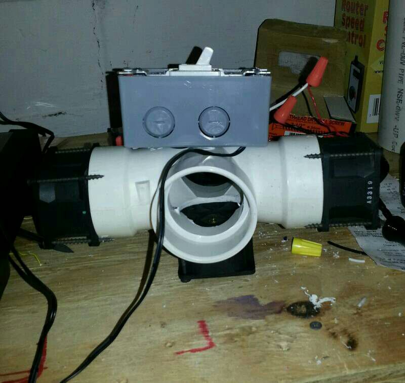

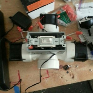

My research shows the same, and working in iT I have lots of old servers and pcs floating around, so I came up with the following contraption, 4 12v 50 cfm fans wired up to 12v 1 amp power supply from a dead router, pulls 200 cfm combined. [attachment=-1]uploadfromtaptalk1395542661874.jpg[/attachment][attachment=-1]uploadfromtaptalk1395543518818.jpg[/attachment]
They are all hooked up to 2 " dbl sanitary tee
