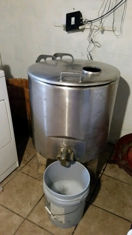

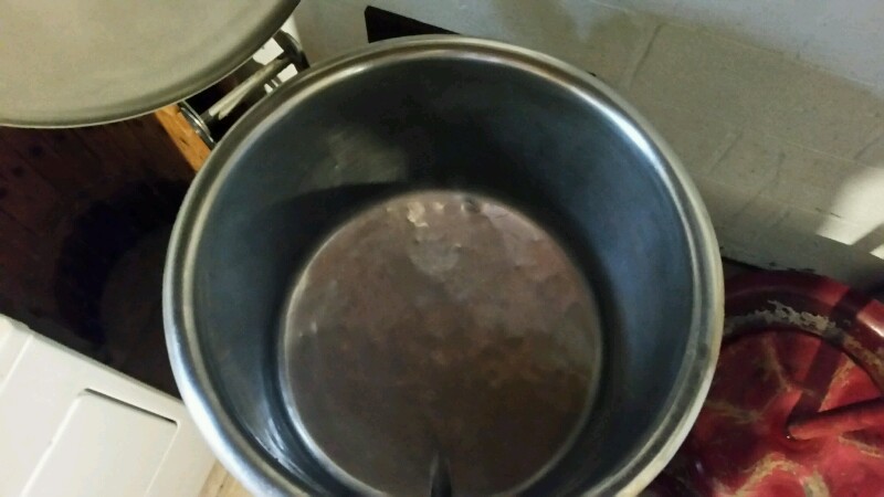

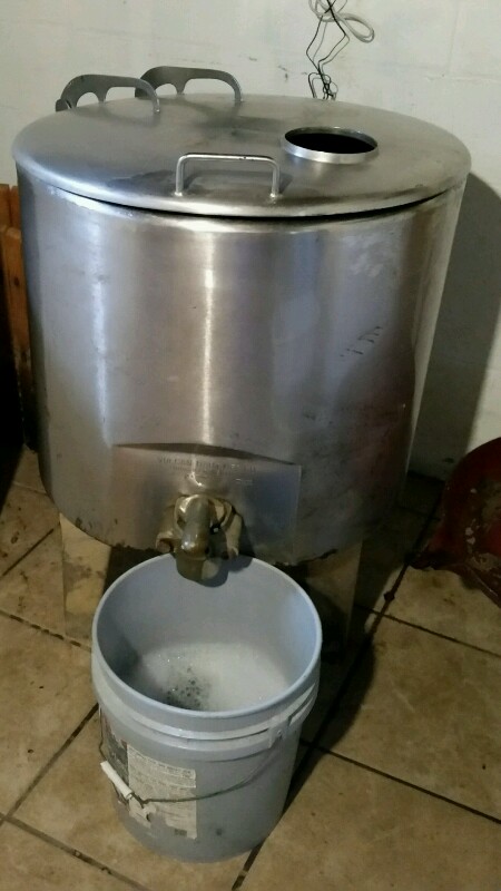

I've dropped a few hints in the direction that my builds have been going. I'll be purchasing my parts for a flute build in a few days so I figured it is time to start working on the boiler.
I came across the little beauty in the scrap yard that I picked up my 4 inch copper pipe. After talking to the yard owner he was able to track down where it came from.
This came out of the heinze factory when it closed down. All stainless steel construction. Double walled. Has a built in drain that goes through the double wall.
Hindged lid. With a 4 inch opening that will get a 4 inch furrel.
Capacity is around 22 gallons.
I need to figure out how I am going heat this beautiful new piece of equipment.
So far my two options are steam injection.
Pros.. I can run on the grain. No more squeezing. I can do a 35 gallon batch in one run ( clear beer in steam boiler. Dirty in the steamer. 4 inch flute on the double boiler.
I can either run the steamer in through the first plate section (as I am going modular) or I can create a dedicated line with a few unions in to the lid or through both side walls.
Option two is to use an immersion element in the double wall area. Due to the slope of the inner bottom ( for draining purposes ) I should be able to fit a 5500w calico element in.
Pros. Still able to run dirty as element is in double wall.
Easy to set up.
Could be used as the mash tun as well (batch cook would be staggered ferments for bigger runs but easy to do. )
Fast heat up times.
Cons. It will need some modifications. There is some piping in the bottom that could be utilized.
I don't know what medium to put in the double wall.
It is sealed so I know I would need to change that.
If I run water I will have to have a vent pipe in which case I will use a 1 inch pipe and put a cold finger or other condenser on it to keep it a closed loop system that is open to the at atmosphere.
Unless I can keep it a closed system, but I thought that would be a pressure bomb. If I'm wrong then that would be easier.
Anyways I've got to get my brandy spirit run going.
What are your thoughts guys and gals.

Re: My new boiler. Time to modify.
Really nice Yak!!!!
Both sounds like good options what suits what you want to make the best?
I would go with Bain Marie instead of steam injection. You got the double walls, use em.
Bitter, thanks mate .
Bear river - I have been leaning that way as I can use it for beer as well. Just means smaller runs. Which is ok seeing as they would still be bigger than my average run.
Any tips or experience in adapting it? Cause I'm still unsure how to do so safely and economically.

Nice find lad, I too would go with the banmarie option if you can fit the element. This is way out of my knowledge area, I'll watch this one from the sidelines

There's a shit pot full of fast food resturants that use it for french fries. I think the veggie oil would be fine. No potato chunks to filter out either.yakattack wrote:Won't the vegetable oil smoke?potentially catch on fire?shadylane wrote:...The vegetable oil is the cheapest.
And...you could use it as a kettle to boil your (beer) wort too.
Yak, looking at the vessel, I say that the jacket was steam fired (in a commercial business) with the inner vessel holding the slurry (ketchup???) for cooking and stock reduction. Is there a steam valve for inlet and outlet plus a condensate drain on the bottom?
The inner pot was atmospheric so the top didn't need a pressure seal. The 4" was just used to vent the evaporating vinegar (whew, can you imaging the "eye burning" smell?).

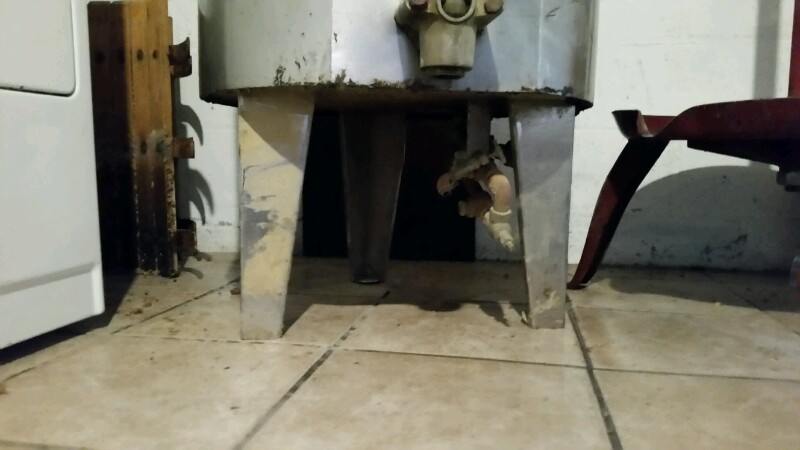

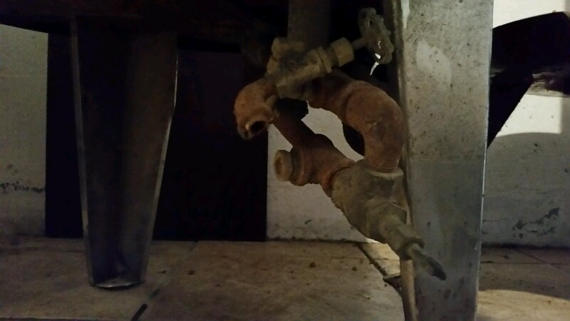

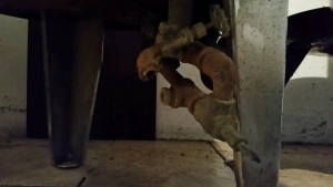

Thee is some drain and piping underneath. As the pic shows. Anyone here with experience with this type of system?
I can see using oil but would I then need a thermostatic control? Set max temp for the oil? How hot will say a 4500watt 220v element make the oil?
I want speed and simplicity. I doubt very much that the run costs between the two systems would be very much so that's not such a worry.

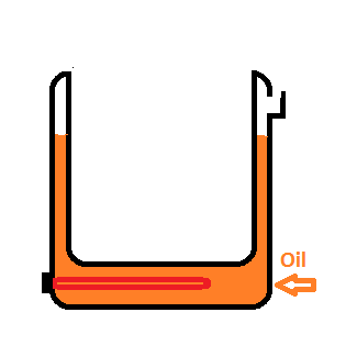

Here's the smoke point of a couple common cooking oils.
I'm guessing the heater would need a controller to keep from exceeding this temps.
Also the overall efficiency would be lower than having the element directly in the mash.

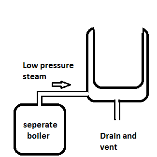

Ok. So I've settle on either steam fired in the double wall or using the double wall as an oil or water bath.
Anyone with any experience or knowledge of steam fired double wall boilers? As I don't know much about them safety is my main concern here.
Same goes for using oil or water with an element.
With water my main concern would be steam (I won't pressurize it for safety reasons. )
With oil I'd be more concerned with flash fire or smoking of the oil.
I am really hoping to draw upon others experience here
As I want to get this up and running soon.
Yak
Yak
- Posts: 11524
If you tried to use water in an open system, It would boil away.
Running it as a closed system would build up steam pressure.
That's good for transferring heat, but bad from a safety point.
Using oil will let the temp get hotter and transfer more of the heat from the element to the inside.
But, hot oil has it's own problems and hazards.

Here's an idea that uses a separate boiler to supply steam at low pressure.
The idea is, steam will heat the baine marie, condense and drain out.
It's a total lose system and doesn't build any pressure.

I did experiment using both water and oil as the heat transfer fluid for boiling a wash.
Long story short, using hot water was a failure.
On a side note.
A Baine Marie boiler and direct steam injection have their pro's and con's.
Their used for basically the same thing. Both are used to get the alcohol out of a goopy ferment without scorching it.
The Baine Marie is the cat's meow for heating, but needs a boiler to supply steam at pressure.
Direct steam injection's only down fall is diluting the mash with condensed steam.
It's being used as a temp controlled fermenter right now.
