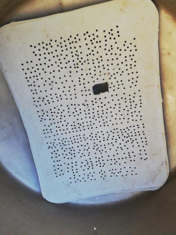

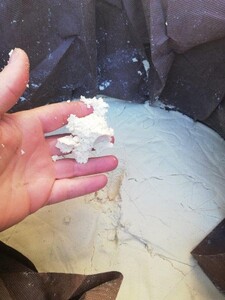

well after a while my top crate's seam tore. it was always the weak spot and i have been looking for a while to upgrade my press. a while back i installed a bottom drain on my 60lt stainless steel mushtun, bingo.
made a plug from some oak, i put the plug in a refuge bagg during the pressing.
the maize meal is wrapped in geotextile fabric. i recover from 83lt water and 20kg meal 70lt beer after fermentation and pressing.
at this time i use the original crate's bottom as false bottom but will find something better.
and after fermenting and pressing the organic matter only weighs about 13kg.

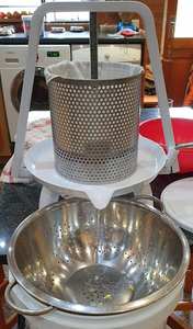

I use a fruit press
not fast - but i can squeeze maize to a dry pulp
SWAMBO made up the bags for me
The colander gets another cheese cloth covering when pour fine washes through it
