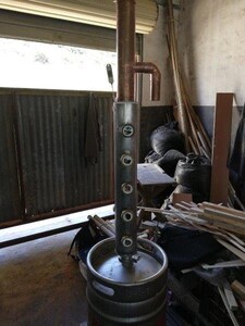

So the project is not finished yet….

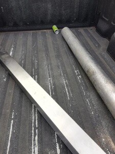

BUT in March I found ‘n piece of stainless steel pipe with a 100mm diameter at the scrap. I already have a flute/ plater and thought to do a second one. Since I do not have a stocked workshop and movements were restricted during lockdown, it went slow.
When I planned to cut the pipe I realized I just might be able to do TWINS! Two brewing friends helped out with keg tops for the bottoms.
Finally, in September I could visit my holiday home when inter provincial travel ban was lifted. Of course that was just an eye blind to the wife, I went to use my brother’s workshop.
TaDa meet my my twins, both ash blond with red and yellow attire.
The one on the left can take a 76mm extension if I want to run neutral… but I did my first flute/plater like that and after 2 years have not done a neutral run yet. They can run 5 plates each, plates are spaced > 125mm apart. The bottom plates sit 60mm from the bottom. The ss pipes are 700mm. They run CCVM heads in 76mm shells. Take off is 54mm for one and 42mm for the other one. Both will eventually have a 550mm by 42mm shotgun with 3 by 15mm vapour paths as product coolers.

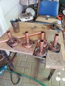

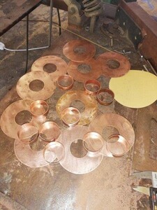

Now for the plates.

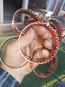

I started with the plates, I always wanted to do something on the line of the ProCaps and after reading Jack C thread viewtopic.php?f=17&t=78362 I started with my procaps…. It is a 67mm slip coupler that was notched with 3mm by 6mm slots. Height is about 20mm. Center down comer is 22mm and the vapour path riser is 42mm on a 98mm plate.
Hacksaw with 2 thick blades for the notching.
5 rings of 20mm x 67mm with 3mmx6mm slots for caps.
Ja, I know I will not win a soldering competition.
the rizers on the plates is 15mm high and 42mm pipe, down comers is 22mm pipe and ends in 35mm vapour lock.
Plates started as 35mm pipe, if I can do it over i would use thicker pipe.

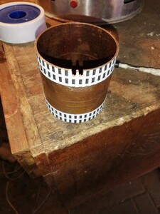

Did 10 plates but I am rethinking the cap thing…
The plates fit loose in the stainless steel pipe so they stand on stainless steel legs. The caps and vapour locks are removable with stainless rods.
After initial cleaning runs I have put a skirt on the bottom of the plates, I use a bit of PTFE tape on the skirt to help seal better. The ss pipe that the flutes are built from is rolled with a seam, it is not 100% round and without the skirt and PTFE tape there is a lot of weeping from the plates. I only have completed one set of caps for the plates. My first flute has perf plates and there is no difference in product between the plates for me. I think twin number 2 will run perfs… Yes, I am a bit over the procap challenge. They work well and I do not regret the build but perfs is just much easier.

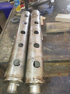

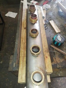

Now for the twins
Keg tops welded.

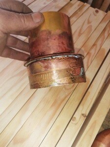

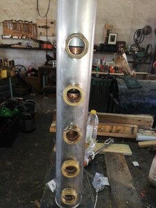

Tungsten carbide hole saw, oil and slow drill press. I wanted to solder the sight glasses before the cuts but my brother was not convinced the cutter will work so I ended up cutting first. The holes are 38mm.
Site glasses is 42mm copper pipe with the thread and ring of half of a conex union. The brass is not in contact with the vapoyr. If anyone tries the conex union for sight glasses, buy all at once and make certain they all the same. I have 2 different types, AND because I was in a hurry when I installed the I have mixed them between the twins. They differ on threads as well as glass size!!!
Test fitting the plates.

Reflux management
The twins run CCVM heads, shell is 76mm and take off on one is 42mm the other is 54mm. The condenser shell has a 50mm skirt that gets wrapped in PTFE tape and slips into the 100mm ss pipe of the flute. I still need to do product coolers but that I will only do in December, in the mean time I use my shotgun from my old flute.
One twin can run a packed extension below the condenser… I do not know if I will use it though, but I do have the option.
During the vinegar run I busted 2 sight glasses that a friend cut with his hands because I was in a hurry to run the second twin and I only had one set of glasses. I removed the glasses while hot and it cracked when it cooled down. Another friend friend made me another set and after 3 runs it is still intact. I use PTFE tape as gasket on the glass
First twin during vinegar run. My plan is to eventually run both twins simultaneously on electric kegs, but I need to sort out my cooling water and electricity in my brewery first. I do not think it will happen in 2020 but that is the end goal.

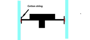

A little weeping doesn't hurt, It's the blow by that's bad.
I learned some lessons trying to fit a plate tree inside a 4" glass column. :oops:
The worst design I found for blow by was having a skirt to keep the liquid level on the plate.
That design was worst than having no skirt at all. With no skirt there was weepage, but also vapor / liquid contact with the vapor rising through the liquid.
A better design had the skirt hanging down below the plate. The reflux that tried to drain down the space between the column and plate had vapor bubbling up through it.
The best design used cotton string to completely seal the gap.

After many different trails, i have settled on just wrapping the plates in teflon tape. Not the most elegant and definitely a recurring effort but it works. Yes on my perfs i loose open area but it benefits power management and i do not see that it interfere with plate action.
