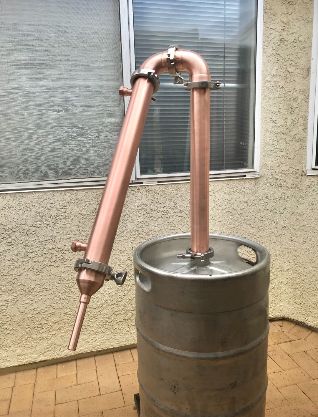

For brown spirits, something like this. Modular 2" from keg to takeoff with a shotgun condenser. It is then easy to add a second spool and tee with a reflux condenser on top and you have a reflux still for vodkas and gin.Prairiepiss wrote: ↑Fri Jan 08, 2021 8:24 pm Welcome aboard.

Thank you very much for the picture! I stayed up late last night drawing plans up and decided to fabricate it all myself including the shotgun condenser. Thinking an 18" section of 2" diameter with four 1/2" barrels should do the trick. I just need to source the copper ferrules and tri clamps to make the modular system work the way you describe. Plus, if my main condenser goes well, I can fab up another 4 inch or 6 inch shotgun for a reflux. Next up is to start watching copper soldering tutorials, I have tons of experience with electronics soldering, this should be pretty easy.Twisted Brick wrote: ↑Fri Jan 08, 2021 9:07 pmFor brown spirits, something like this. Modular 2" from keg to takeoff with a shotgun condenser. It is then easy to add a second spool and tee with a reflux condenser on top and you have a reflux still for vodkas and gin.Prairiepiss wrote: ↑Fri Jan 08, 2021 8:24 pm Welcome aboard.

The photo is of a pot I just built for a member. I should have mentioned that if you build your stillhead with a tee instead of a 90 at the top of the pot riser, you can change modes quickly and attach your reflux column for easy refluxing. Deplorable did this with his build and it came out very nice.

Nice beer keg build I like the contrast between copper and the boilerTwisted Brick wrote: ↑Fri Jan 08, 2021 9:07 pmFor brown spirits, something like this. Modular 2" from keg to takeoff with a shotgun condenser. It is then easy to add a second spool and tee with a reflux condenser on top and you have a reflux still for vodkas and gin.Prairiepiss wrote: ↑Fri Jan 08, 2021 8:24 pm Welcome aboard.
