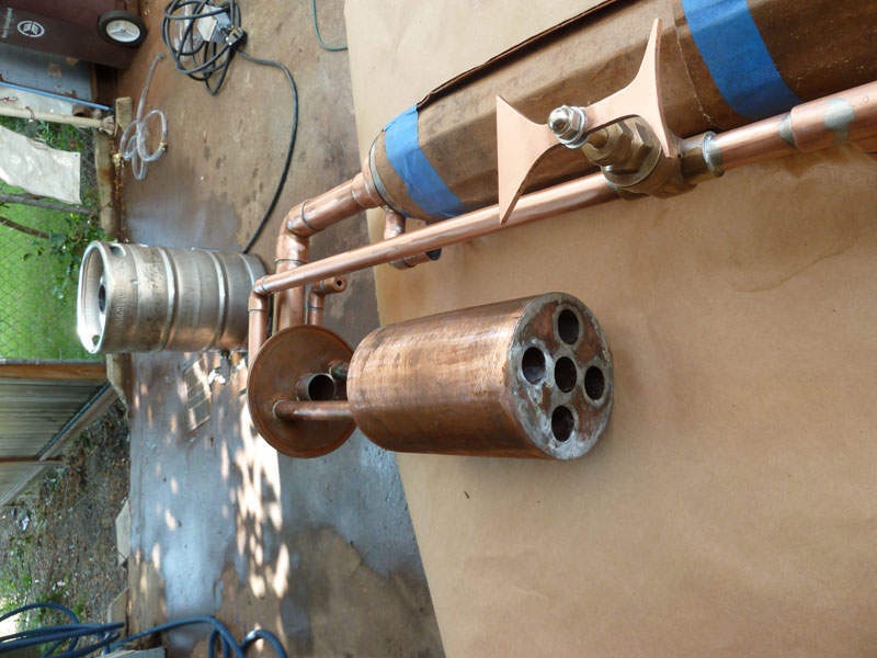

Most shotty users incorporate a ferrule on the vapor end to attach to the lyne arm and another ferrule on the distillate end to accommodate a collector/reducer. Ferrules also make for easy access/cleaning the vapor tubes of tails oils that accumulate over a number of runs (despite rinsing).
Just a heads up, installing an even number of baffles will place your I/O coolant ports on opposite sides of the shell.

Hi TB... I've been admiring your shotty... Yes, I will be adding SS ferrules...I was just checking the end caps for fit. I was advised to get ferrules that fit the OD of the 2" but I prefer the look of the inside fit. Plus I wanted my end caps butted up against the inner lip of the ferrules. Thank you alot for the advice on the baffles ..I hadn't even considered that!!

Twisted Brick wrote: ↑Thu Jan 12, 2023 11:42 am Most shotty users incorporate a ferrule on the vapor end to attach to the lyne arm and another ferrule on the distillate end to accommodate a collector/reducer. Ferrules also make for easy access/cleaning the vapor tubes of tails oils that accumulate over a number of runs (despite rinsing).

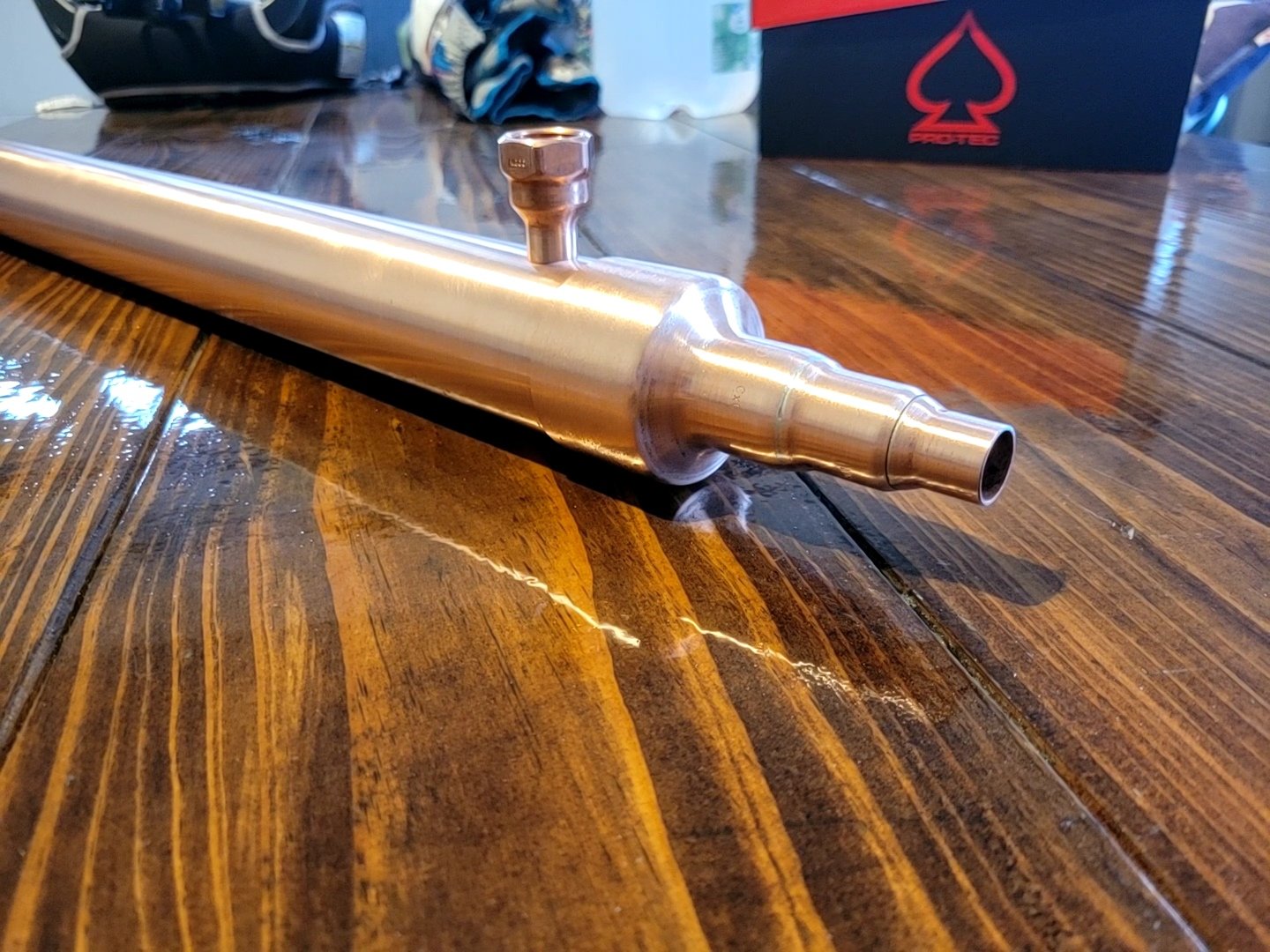

Practice fit
I radiused the fitting to the shell

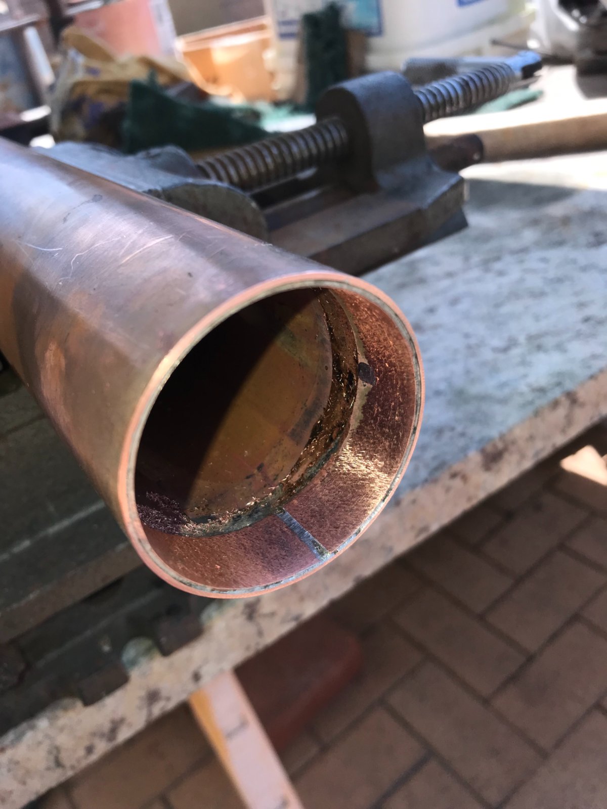

Need some advice on the best way to solder the ferrules to the DWV pipe taking the gap produced by the thinner wall into consideration.

I fill the gap using some thin wire..PuckJunkie76 wrote: ↑Thu Jan 19, 2023 12:34 pm the DWV pipe taking the gap produced by the thinner wall into consideration

That's all the wire you use? No issues with the solder filling the rest without running out?

Yeah that all I use.. the only time I have issues is if I rush the heating up phase.. where is it going the run out.. it's held tightly in place by the wires and against the ferrule..

You're soldering from the outside correct? Against the flange?
StillerBoy wrote: ↑Thu Jan 19, 2023 1:38 pm Yeah that all I use.. the only time I have issues is if I rush the heating up phase.. where is it going the run out.. it's held tightly in place by the wires and against the ferrule..

No.. from the inside..

Then how do you solder in the endplates with vapor tubes?

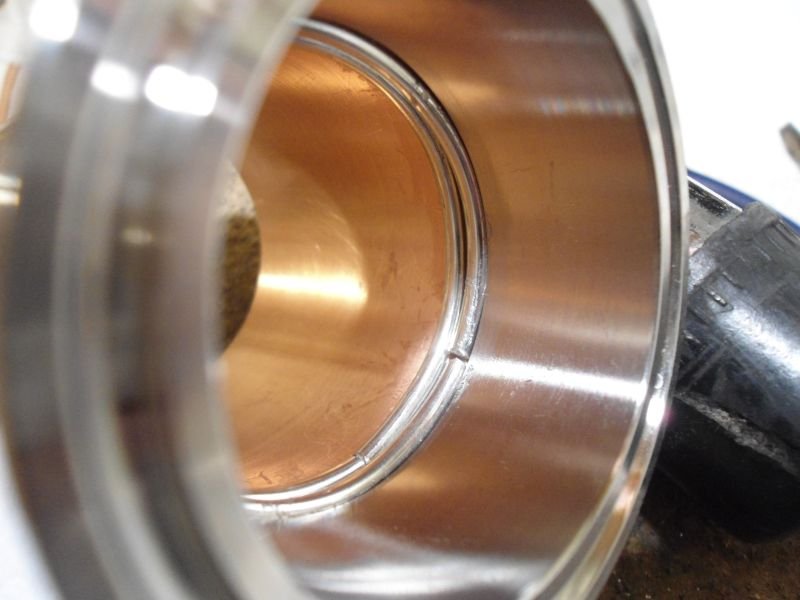

I only use Type L pipe for members' shotties/pots, but a while back was toying with some DWV to make a lightweight pot riser for a friend. I wasn't happy with the wire method (runs) so went with plan B. After cutting a ring (5/8" I think it was) off the end of the DWV pipe, I inserted it into the pipe and trimmed off the overlap. As you can see I cut off too much but it later filled with solder nicely. I used vice-grips to clamp the trimmed ring inside the end of the DWV and soldered it up. Lastly, I used my grinding burr to ream out the ID to accept the ferrule and Bob's yer uncle. It took about 30min for each ferrule, but that included a beer break. Very strong, no gaps, minimal solder and no runs.
The ferrules soldered in just like Type L pipe, but you might have some challenges with your endplates since they have no flanges. Maybe you can report back with your results.

I first solder the baffles and end plate as a unit, then slide the assembly into the tube, and butt end the ferrule to the end plate..PuckJunkie76 wrote: ↑Thu Jan 19, 2023 3:22 pm Then how do you solder in the endplates with vapor tubes?
I now use brass ferrules (SD) and do the same.. much easier with brass ferrules as the ferrule slide on top of the tube, as all tubes have the same outside dimensions..

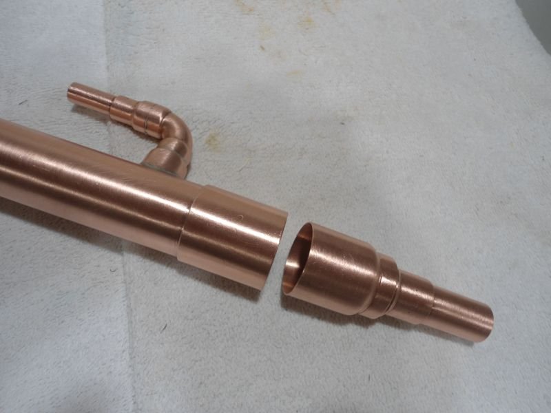

Here's a solution to your issue on the spout end of the shotty.. just solder the end plate to the inside of the tube, and leave the reducer as a slider, that will also allow one to clean the inside if the need araises..PuckJunkie76 wrote: ↑Thu Jan 19, 2023 5:09 pm but when I made my spout I wasn't thinking and used a 2" reducer fitting which slides over the top of the DWV, so I'd have to do some serious modifying on that as well.
I done many as such..
Mars
– Albert Einstein
– Albert Einstein
- Posts: 34
- Joined: Thu Dec 22, 2022 5:19 pm
Re: PuckJunkie's Build
Yes, that is what I'll do Stiller. Thank you for the help! I think I'll make it so I could still add a ferrule later, if I feel the need to, but otherwise I'll just use my slip fit spout as I pictured above. Appreciate you guys!!!

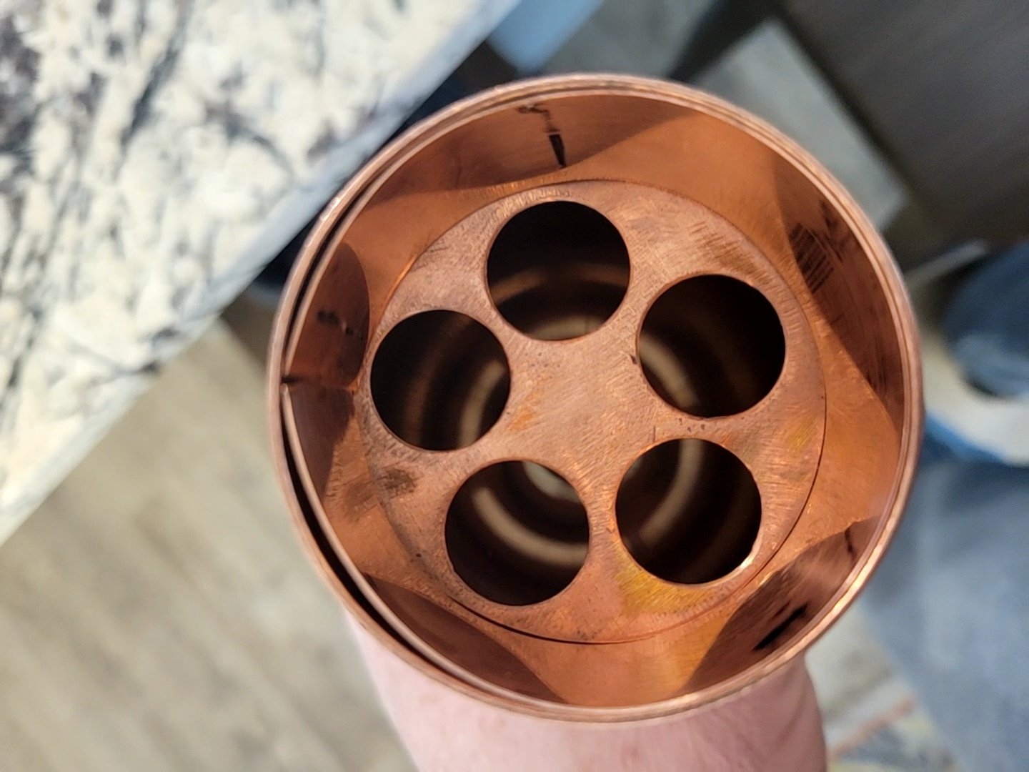

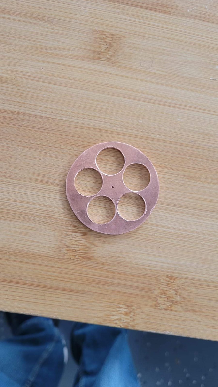

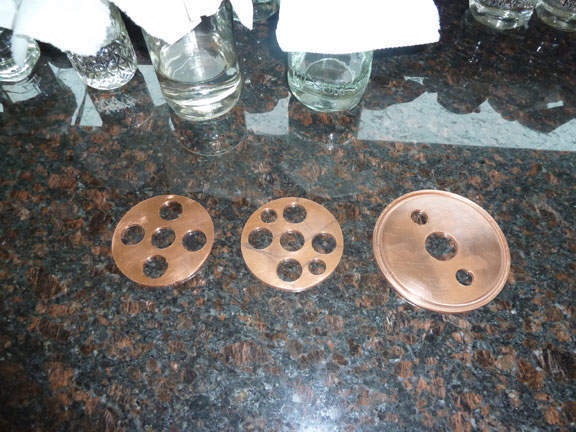

Looking at your plates, five looks pretty tight. I tried a couple sets and never did like my tube spacing. There’s a reason most shotguns are four 1/2” I.d. or an occasional seven 1/2” o.d. I’m not saying it can’t be done, but four is much easier and will knockdown anything you need.
- Posts: 34
Yeah, I thought about that. If I hadn't already spent the time and effort on the plates and baffles, I'd switch...if it doesn't solder well, I'll go to four.
30xs wrote: ↑Thu Jan 19, 2023 8:22 pm Looking at your plates, five looks pretty tight. I tried a couple sets and never did like my tube spacing. There’s a reason most shotguns are four 1/2” I.d. or an occasional seven 1/2” o.d. I’m not saying it can’t be done, but four is much easier and will knockdown anything you need.

Hey TB, I came up with a good solution based off of your method!! I had a small sheet of thin copper I had bought previously at a craft store to make a model still out of. It worked perfect!!! No grinding!!

I would solder the band in first before soldering the ferrule and end plate assembly, to over come any possible leaks later..

I appreciate it!! Yeah, I agree.
StillerBoy wrote: ↑Fri Jan 20, 2023 10:22 am I would solder the band in first before soldering the ferrule and end plate assembly, to over come any possible leaks later..
