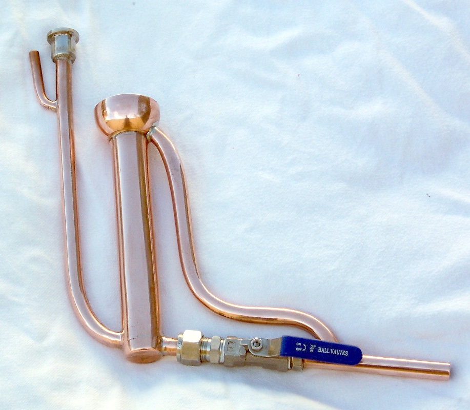

But if ever I was to make a Parrot , I’d copy this design from Bourbon Junkie .
You close the valve , the parrot fills , take a reading , then open the valve and continue . No Parrot smearing . Not that a parrot would smear more than a Pot still though .

thanks yummy accidentally deleted that pic and forgot where it came fromYummyrum wrote: ↑Wed Jun 07, 2023 1:13 pm I stick a measuring cylinder under the spout when I want go take a reading .
