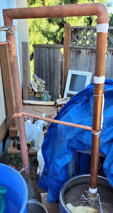

I steamed it for something like 3hrs. Then I added the vinegar and began steaming that.
About 2hrs into that I figured it was time to turn on the water and start condensing, which would have been followed my another water run before the sacrificial run but just before I plugged the pump in the column fell over :esurprised:

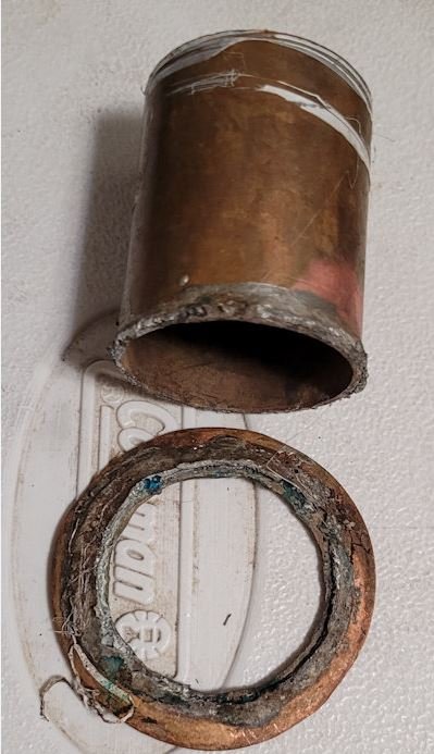

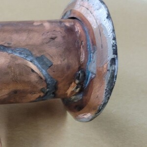

That's when I realized there was a slight flaw in my design...namely the fact that I used to use Easy flanges :roll:
I guess I should explain my pot head design. my old design, which has worked absolutely fine for 11 years now, used slip fit couplings to make it easy to assemble and disassemble. This included a fitting with a flange that connected the riser to the keg.
The new design uses slip fit up to the lyne arm, then a hammered flange and try clamp to connect the condenser.
For years I've had a much shorter shotgun condenser I've used for my flute and neutral columns but it is too under powered to handle a full on stripping run.
The original version of that short condenser used an easy flange, which eventually failed and was replaced by a hammered flange, which seems to be able to handle a lot more stress.
I also usually support the big columns from the ceiling but where I was running had nowhere I could support it, so there was a fairly hefty side load going on. I thought I had made that keg connection a hammered flange years ago but I guess not. :esad:
So now I didn't get to finish my cleaning runs and will have to modify that fitting into a hammered flange fitting and maybe figure out connecting a trypod for support in the future. Not that I actually plan on doing much with it other than boxing it up and stowing it away.
This sort of thing is why I quit using easy flanges.

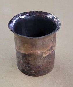

Well, I took my fitting to work and made a hammered flange.
I thought I might run through my process a bit.
To start with I remover the solder

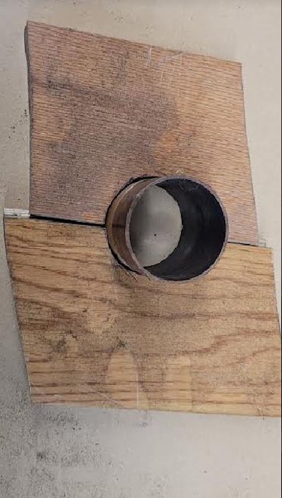

Annealed it, then made a jig out of flooring.

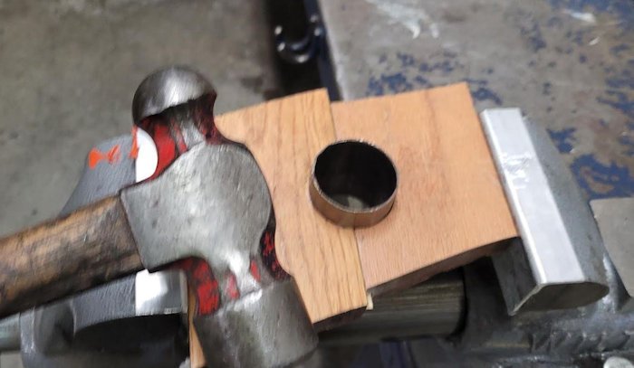

Clamped it in a vice and it was Hammer Time

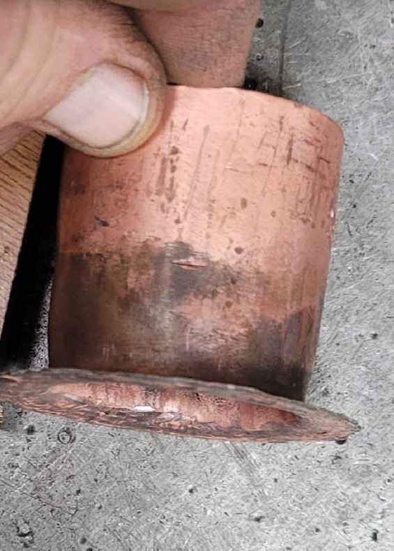

After the first hammering and time to anneal again
After 2nd hannering
I.D. fit check to make sure I hadn't distorted it too much
O.D. fit check will have to wait until I get home.
cranky
Posts: 6688
Re: Why I don't use Easy Flanges
Post by cranky »
Once I got home I checked the fit and it will work but should be a bit bigger. I have a couple solutions for that
#1 Remove solder from the original flange and make sure it will fit over the existing flange and not fasten them together.
#2 Solder the ring to the top of the new hammered flange so any stress is exerted against the hammered part.
#3 TIG weld the flange bigger
Currently I'm thinking option #1 :problem:

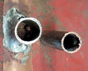

Anyway, here are a couple of other goofy things I did while remaking the condenser.
For testing purposes I needed to be able to pressurize the water jacket, which is why it has a valve. I tend to not be one of those people who thinks you need a temperature gradient throughout the condenser and tend to run my product condensers wide open but I added a valve to the bottom for testing.
I'm also not one of those people who think condensers should be fed from the top. My thinking on that is cold water naturally goes to the bottom so it should be fed from the bottom and if a pump fails the condenser will remain full. So my inlet is always at the bottom.

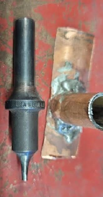

Now, my return hose is the same size as 1/2 inch I.D. pipe, but the hose from my pump fits 1/2 inch tubing. In the process of making this I got a little backwards and made the outlet 1/2" tubing and the inlet 1/2" pipe :roll: To fix this I had to use a technique I often use to join the two pipes.
The problem with joining the two is the tubing is just a little too small to fit tightly into the pipe

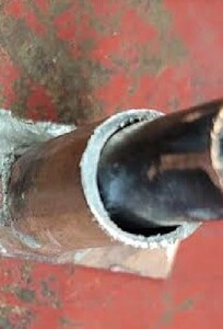

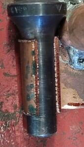

So I clean the inside of the pipe and outside of the tube then use a broken rivet set that I have, that fits the I.D. of the tubing perfectly
Because the set is tapered and the tubing is soft I can hold the tubing in my hand, tap it a few times with a hammer and create a tapered flange that will then fit tightly into the pipe. I then slip the tube into the pipe up to 1/2 inch, fill it with flux, heat it up and solder it like a normal fitting. I've never had one of these leak or fail
Even when soldered with my crappy propane torch

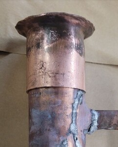

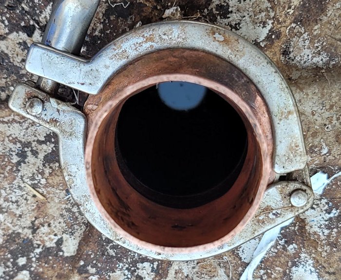

MooseMan wrote: Sun Sep 01, 2024 12:50 am When you say the flange should be "Bigger" you do mean thicker so that the clamp bites it better yes?
Actually I was talking diameter. Due to cost I always use 1.5" pipe and not 2" but because the keg takes a 2" try clamp I keep all my try clamps 2". So my flanges have to be extra wide. It's much easier to hammer a smaller flange and would make sense to use 1.5" try clamps but this is the way I do it :crazy:
I have copper in my toolbox at work and whipped up a piece to make it slightly larger diameter. Then when I got home and was checking it
I realized something :problem:...well 2 things really... :roll:
First the top of my boiler has gotten very dirty over the years. :oops: I've cleaned the inside many times but I don't think I've washed the outside since it was first constructed :think: I guess I should do that before I put it away.
And 2nd, The last time I reinstalled the connector I couldn't find the proper copper centered everlasting gasket so I used one that was cardboard centered but was slightly larger in diameter than necessary. This gave the appearance of the flange being too small but once the gasket was removed and the proper gasket installed it was pretty close to perfect.
and clamped up nice and tight because the gasket is pretty thick.

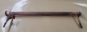

I don't think I posted an overall of the condenser so here is that
Y'all might have noticed I don't really go for that pretty, shiny, perfect copper. My style is best described as Early American Junk Pile :moresarcasm:

I've been wanting to get on with the cleaning runs of my newest condenser now that the keg connection is finished but it actually isn't finished :roll:
I am reluctant to hang all that weight on it in the partially annealed condition it is currently in for fear it will start leaning. My plan was to take it to the sand blaster when it was finished but the sand blaster had an out of service tag on it saying something was broken :( So I was unable to use it.

cranky wrote: Mon Sep 02, 2024 4:21 pm. My plan was to take it to the sand blaster when it was finished but the sand blaster had an out of service tag on it saying something was broken :( So I was unable to use it.
Sand blasting . ….Ohhh …. Shiny :ebiggrin:
and hardened of coarse :ewink:

If you just want to work harden it a bit quicker cranky, you could set it on top of something like a vibratory sander (Or anything that will "Rattle" it?) for a few minutes and that will help to speed up the process?
An old guy in a toolroom once showed me how to do it by half filling a copper pipe with nuts and bolts, and running it slow in a lathe for a few minutes.

It's not really shiny, it's more a clean mat finish :crazy: When I made the welded shotguns I cleaned and sandblasted everything but I'm being too lazy to do that again :roll:
MooseMan wrote: Tue Sep 03, 2024 12:47 am If you just want to work harden it a bit quicker cranky, you could set it on top of something like a vibratory sander (Or anything that will "Rattle" it?) for a few minutes and that will help to speed up the process?
The sand blaster is probably the quickest and easiest solution for me. I also have an idea it helps stress relieve the copper, similar to shot peening...of course I could be wrong on that.

cranky
Posts: 6688
Post by cranky »
I didn't manage to get the coupling sand blasted yesterday but I went ahead and installed it, assembled everything and got back to the vinegar run.
All of that probably belongs on another thread, maybe the goofy things thread but I'm going to go ahead and talk about it here.
2hrs steaming the vinegar followed by a half hour to 45 minutes with the condenser running. It ran flawlessly.
Then I drained the boiler, rinsed it out, filled it up with water, steamed it with water steam 2hrs then turned the condenser on for another hour. Then I had to go to bed.
Today I drained the boiler, added 1 gallon of fores I had saved up and 3 gallons of feints I really wanted to use in an all feints run. I had planned to add the 2 gallons of apple feints I have but just couldn't bring myself to do it :roll: Then added water until the boiler was 3/4 full and fired it up.
I have to say, I don't like this particular setup and never did because the the riser is just too freaking tall. I really prefer a short riser for a pot still and will likely run it on a short riser if I ever use this in the future with the outlet just high enough off the ground for the collection jars and spill tray. I do think this will work exceptionally well for my Neutralizer, which was too tall for the 20 inch shotgun I last used it with. This should bring the outlet just about where I want is the next time I make neutral.
As expected this condenser had no problem knocking down everything my 5500W element could do. It did take a lot longer to heat up since it had to push the vapor so high. It took nearly an hour which is pretty unusual but once it reached the condenser it took less than an hour to put out 4 gallons of "cleaning fluid" which can be a hell of a stripping run in the future. It smells so good it made me sad to use such good feints for a sacrificial run :(
In that hour the water temp went from around 70f up to 115f at the top of the reservoir, which isn't terrible.
The new coupling stood up just fine through the whole thing with no apparent distortion or leaking. Nothing else leaked either.
Now it's time to break everything down, finish making the crates and get everything packed away.
