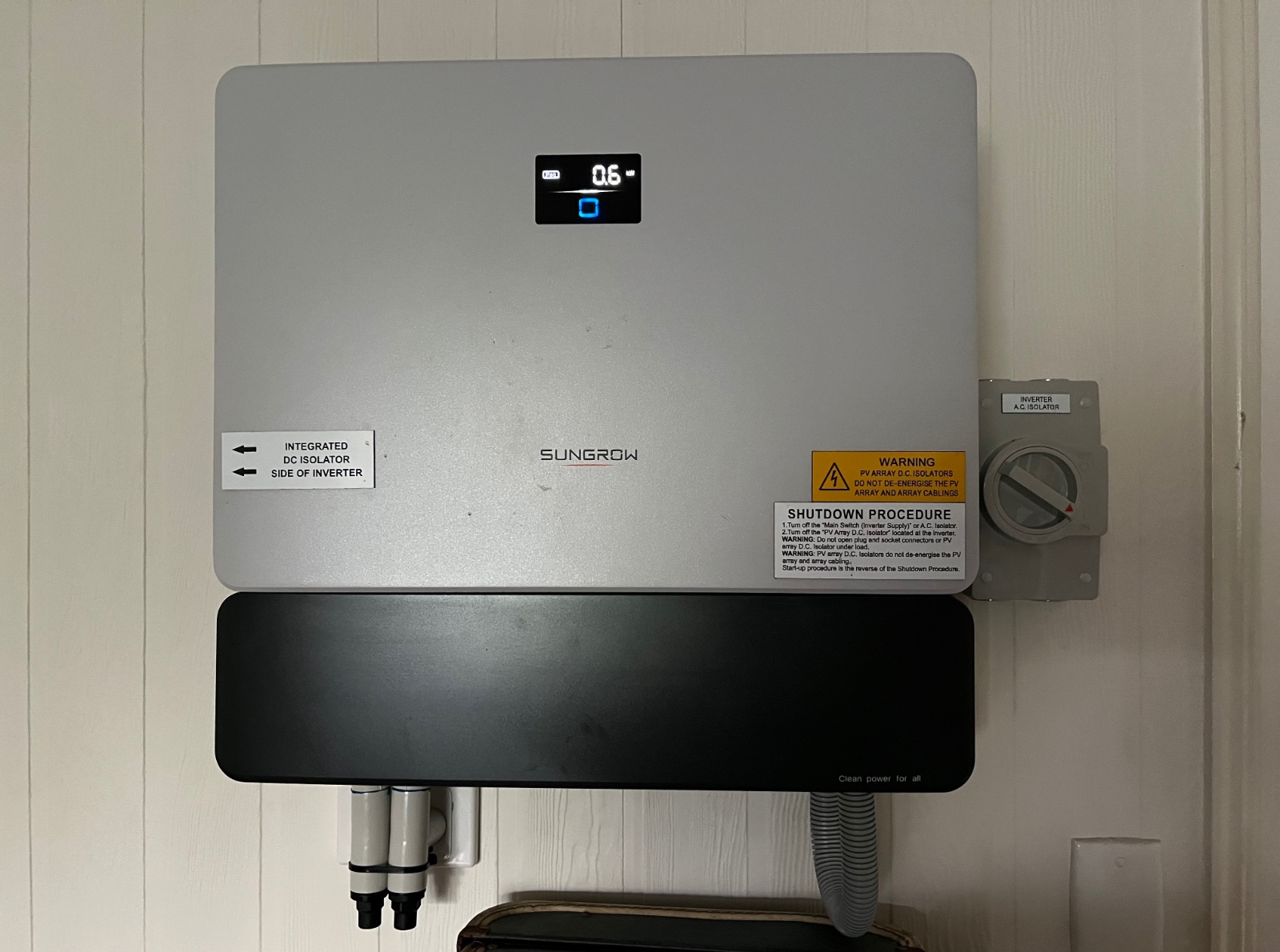

We also have a new 8kw Solar installation , I would have thought that that would have helped with the regulation , but it makes no difference if it is on or off .

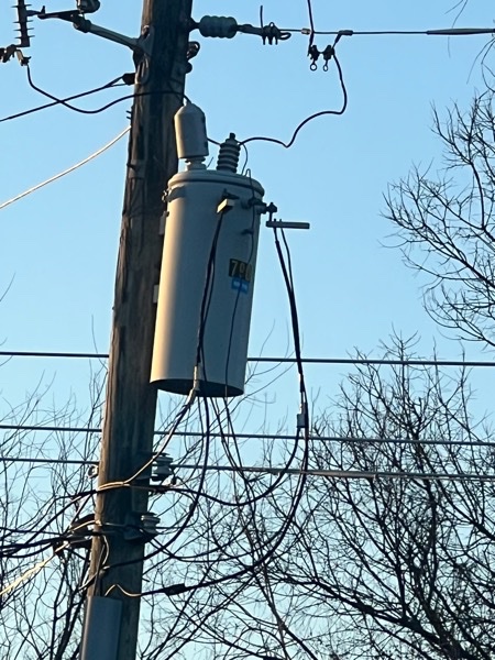

You mentioned solar, and it made me wonder.
Is there anything that's part of the installation between the house and transformer?
Could it be possible there's something in the pole transformer that's meant to automatically adjust for line fluctuations?

As far as I know , there is a “smart meter” in the switch board .
It has three ports . The incoming mains , the house load and the Output from the Solar inverter .
I am no expert on it Shady , but I believe it just monitors the three so the power company can either give you a bill or a credit depending on which way the load is going . We are also limited to pushing a maximum of 5kw back into the grid . So it talks to the inverter and controls how much it can generate .
I can switch it off …. as in throw the switch between the solar inverter and the switchboard so as if it wasn’t even there and it makes no difference .
I would have thought that the inverter would have acted as a low impedance source and during full sun and max output , the only voltage drop was the 5 to the shed , but it doesn’t work that way .

- Posts: 11542

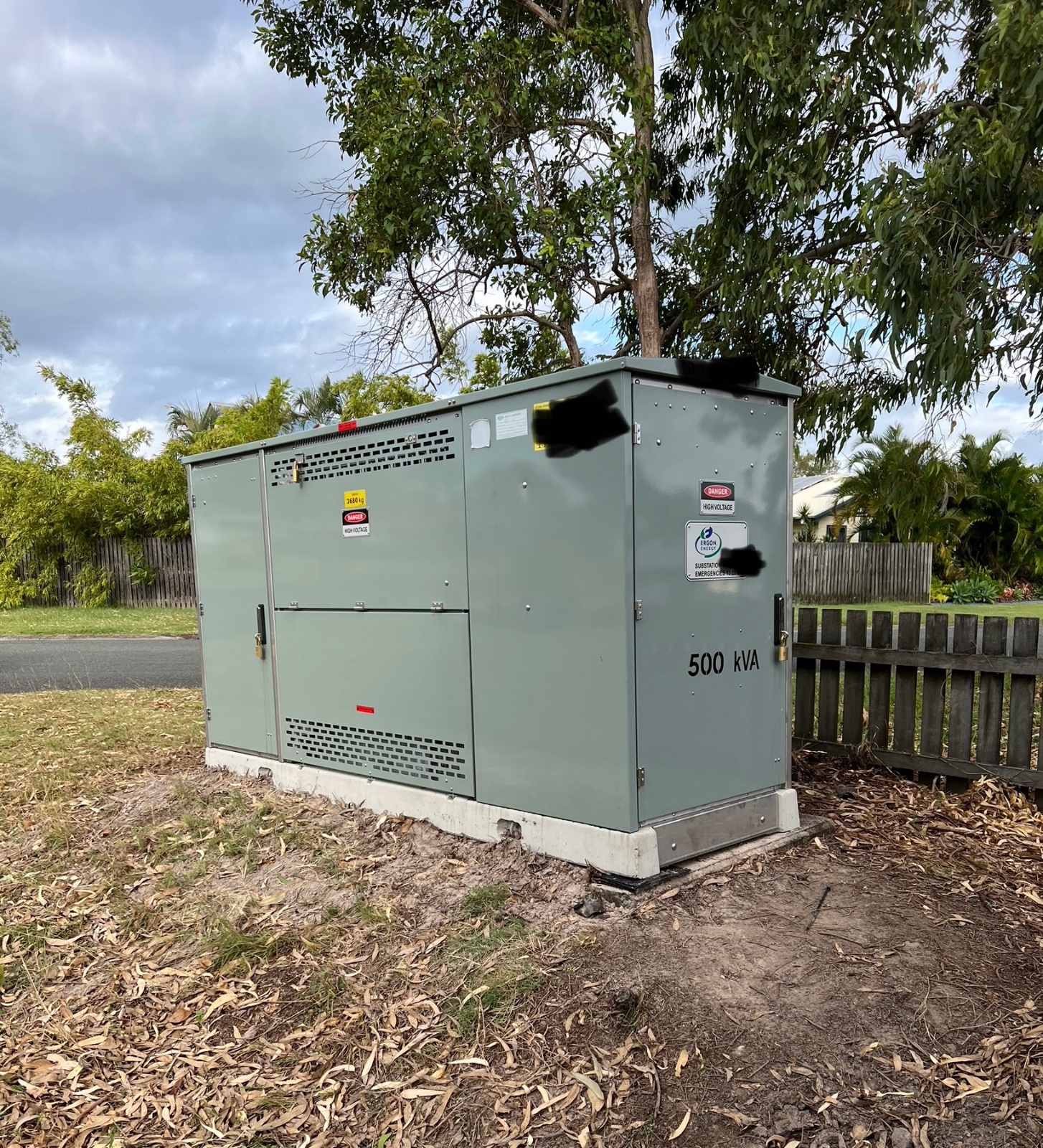

- Posts: 11542
Re: Lights flicker using Aurber DSPR1 or other Burst fire controller
What's the model on the transformer, I'd like to look it up and see if there's something about it that could be effected by a burstfire controlled load.
- Posts: 8915
Just reading Jonhnys post about the nuetral and it occurred to me . In the US , are your lights on a 120v circuit ?
Ours are on the 240v .I can’t see that making a difference though as the percentage change would be the same .
Also wondering when Shady asked about pole transformers , do you guys have one pole transformer for each house or do many houses share the same one ? Not that it mattes but just curious .
Quadra , yes all our residential switch boards have a 63a breaker .

In my US neighborhood we have at least a couple houses per one trafo up on the pole. Bucket shaped/sized trafos. A loose neutral will cause flickering LEDs and I believe they were “dimmable” LEDs too. In my case the loads that caused it were on different 120V circuits but the same neutral and it’s typically two phase to each house for 120V legs or 240V larger appliances like stoves, HVAC, dryer - and stills…
Cheers,
-j

Thanks for that , sounds like it’s a common theme then if Shadys got similar .
Interesting Pic Jonny.
So I guess they use the ground as the return for the tranny .
I’ve only ever seen that used one here . Strangely just up the road around Bundaburg . They have a single HV line and a small step down Tranny at each farm or group of houses .
As for the Neutral effecting the lights , that would make sense if your lights are on a 120v circuit .
