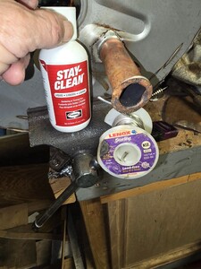

I finally got the right flux(thanks for the suggestions), it says it works with any solder to make a solid joint, it was 6 bucks at the a/c supply for a small bottle. I used the sterling solder which is a typical solder for copper. It held strong
Harris stay clean liquid flux and any plumbing solder
Pic turned, 🤷‍♂️

That solder is not a mgf recommended soldering for dissimilar metals SS /copper. I would advise you to do a leak check after a few boiler runs. After the different rate of expansion due to heat the metals and lack of proper wetting, it is likely to crack at the SS seam. I've seen this many times. A silver bearing solder is required per reliable mgfs.

No need to delete that flux works with all solder I have used as you mentioned. However the solder is for typical plumbing joints, copper to copper or copper to brass. For copper to SS or carbon steel it needs some silver to wet proper. Been that way all my 50+years in the trade even the 10 years in Texas.

That joint looks good to me. I’ve made several things using lead free plumbing solder and that flux, and so far the only joint that I’ve had fail was a butt joint between a stainless ferrule and a very thin stainless pot lid, where I’d hung way too much weight off the end and loaded the joint sideways. It finally cracked and broke on me, so I resoldered it with a copper flange to connect the two and it’s still going strong today. A thin layer of solder that’s in tension, has the absolute minimum surface area possible between parts, and subject to regular flexing is pretty much the worst case scenario and I’m not at all surprised that it failed. I find that flagged or overlapped joints where the solder is in sheer to be a lot more reliable - which is just good practice in general, to be honest.
Not trying to argue with an expert, but in my somewhat limited experience that solder will make a serviceable joint between copper and stainless as long as it’s done well in the first place, the joint has at least a little mechanical integrity of its own (I always flange thin parts now, or use copper rivets), and you don’t severely strain the joint while it’s in use. It’s not the strongest possible way to join two pieces of metal, but it seems more than strong enough for our purposes on 99% of the things we’d need it to do in this hobby. Maybe time will change that opinion.
And yeah, it can be a pain to get that stuff to wet out on stainless steel. Careful heat control, immaculate preparation, and brushing with flux while its molten all seem to help a lot.
