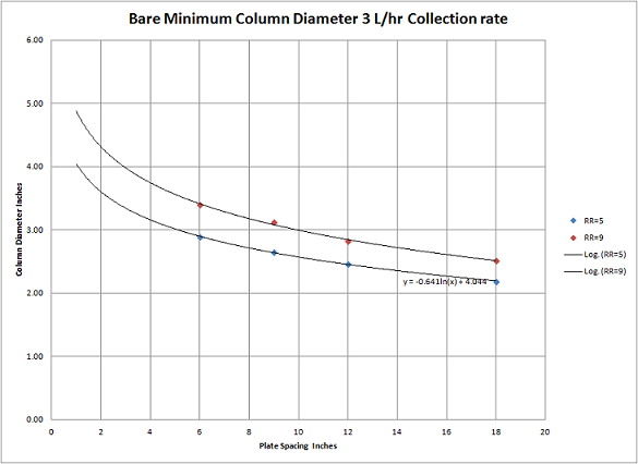

Ok in an effort to make this easier I took the formula for Kv on the Y axis of the graph and pasted it into word then converted that to an image so that you can see what is going on..
Now the top equation is the exact same on on the Y axis on the graph I just stripped out the greek letters and use V for vapor (not g like he did). I also replaced the lower case rho with d for density and lower case delta with S for surface tension like we have used all along. So the term in the first box is 20/s this is just the number 20 divided by our known surface tension. Now they are raised to the 0.2 power again its just a number type it into your calculator and it pumps out the answer. The second set of terms is just The density of the vapor divided by the the density of the liquid minus the density of the vapor. then it is raised to the 1/2 or (0.5) if you prefer. Ofcourse they are all multiplied together.
However what we really want here is Uc !
At this point we know the value for every single one of those terms so there is really nothing stopping us for plugging in the numbers and getting Uc.
Now to make life easier The second equation is really just the first equation. its just reaarranged so that Uc is all by his lonesome which is just the way we wanted it! Plugging in all the numbers for our 6" plate spacing looks like this
Uc= (0.1533)[19.2/20]^0.2 [(736.69-1.643)/1.643]^0.5 which for me works out to
Uc 6' = 3.216141695 feet/sec or 0.980279989 meters/sec
likewise I get..
Uc 9' = 3.803564836 f/sec 1.159326562 m/sec
Uc 12' = 4.65742633 f/sec 1.419583545 m/sec
Uc 18' = 5.874231407 f/sec 1.790465733 m/sec
Uc 24' = 7.762377216 f/sec 2.365972576 m/sec
Uc 36' = 10.10367802 f/sec 3.07960106 m/sec
Ok now feel free to plug in the values of Kv for each one and check what i did. Do the steps make sense to you. Better yet do the answers make sense. What I see which I find reassuring is that as the plate spacing gets further apart the maximum allowable vapor velocity is increasing. It doesnt mean my math is right but on the plus side I have no negative values and they increase they way common sense says they should . Nows a good time to ask me question here on this par,t but anytime will do. if you dont follow what i did ask chances are someone else has the exact same question and i just need to explain uit better. if you see an error in my math point it out!
:grin:
measure twice cut once and if that dont work get a bigger hammer!

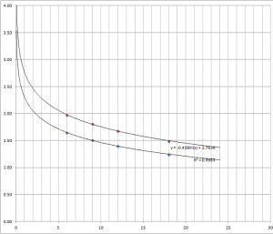

OK
Lets recap what I have done to this point. It looks like a lot but really it was just 4 steps.
1) I decided on a collection rate and reflux rate Rd for my desired column
2) Using known Literature values for ethanol and my desired Rd (reflux ratio)I calculated the term Flv which is shown on the x Axis of the graph by simply plugging in the numbers into that equation (nothing more complicated than that)
3) Using the graph and just tracing along with a pencil I followed up from my Flv number to my plate spacing line then across to the Y axis to get Kv (or Csb depending on who made the graph)
4 With my now know value for Kv I simply plugged in all the known values into that second equation I displayed (which is the same equation as on the Y axis just rearranged) to get Uv.
Thats it I now know for my desired column The maximum vapor velocity that would be acceptable for that plate spacing!
If my vapor travel faster than that all bets are off and there is a strong probability that my column will not work.
Maybe this seems like a little work...
BUT isnt it faster than building an entire column just to find out it does not work?
Better yet now we can finish solving for our column and graph just exactly what happens when we change plate spacing and see what happens with our eyes.
PS I wish there was one simple equation that gave us this answer without the use of the graph! I can not find one that describes any system where the plate spacing is less than ~18". If any knows a model that does this for say 4"- 24" inch spacing I would LOVE to see it
PSPS I would really like to see some questions or comments so I know people are following along and get this

Ok
Lets say you built a column and the splate spacing is just TOO CLOSE! Now your first instinct might be that as soon as you have an issue you put the sytem back into total reflux then after you keep that reflux ratio really high in hope of a better separation. But maybe sometimes our first instinct is not the best one.
if Rd = L/D which is the same thing as (V-D)/D then the higher the reflux ratio the more Vapor and Liquid we have in our column with respect to our distillate collection. So what happens when we cut back that reflux ratio?
Well for 1 thing Flv (remember the X axis on the 1st plate spacing chart) doesnt really change that much. Which probably means Kv (Csb) doesnt change that much. BUT back when we calculated out vapor flow rate we used the term
V= D(Rd+1) but suppose we lower Rd from 9 to say 5? Does not the vapor flow get a big reduction, like from 9 fold down to 5 fold!
Now I worked out all the calcs for 6" to 18" and here are my results..
For a column with a Rd (reflux ratio) of 5 intending to collect 1.2 liters per hour of nearly pure ethanol here is the reccomended plate spacings.
Plate Spacing...... .Dc........ Dc with 20% buffer
6" ....................1.64"..... 1.97"
9" ....................1.51"......1.81"
12"....................1.40".....1.68"
18"....................1.24".....1.49"
Now thats a pretty reduced minimum column diameter and heres the graph to show it..
Notice that at least on paper reducing the Rd (reflux ratio) allows us to use a 6" plate spacing on a 2" column. Now I didnt do the work but I would think if one were to further reduce that Rd to say 3 we could use that 4" plate spacing. Now that comes at a cost and the cost would be less separation but it should occur without flooding or entrainment IF the rest of the column is designed properly :grin:

Now lets look at what happens when we Increase D distillate collection rate. Lets say 1.2 liters/hr isnt good enough and we want 3 liters /hour. Now a common question might be how big does my column have to be. The answer is..
That depends on what kind of reflux ratio you are going to run. Here is a break down for a collection of 3 liters per hours for
A reflux ratio of 5 and
A reflux ratio of 9
Now the results are the bare minium column diameter. This means it is the absolute miniumum. Remeber the author reccomends over sizing this by 12% and I said if it were mine I would be tempted to increase that number by 20% but thats something you might want to decide for yourself.
Plate Spacing.......... RR=5....... RR=9
6........................ 2.88....... 3.39
9........................ 2.65....... 3.12
12....................... 2.46....... 2.82
18....................... 2.18....... 2.51
A word of warning! Having a trend line to predict how things act is nice. BUT using a trend line to predict exact behavior outside the data points is not reccomended. What this means is I absolutely can not say with any certainty that where the line crosses the 4" plate spacing is truly predictive of minimum column diameter because that is outside my data set. Any point on that trend line between 6" and 18" should be correct, but at 4" it is an educted guess because we really dont have any data that show what happens out there.
