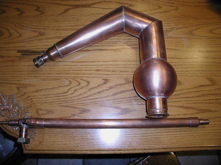

I have enjoyed my first still but have been itching to build a new one. Just finished soldering up the final tid bits, and man she turned out nice!
I modeled it after a scotch style still although I will be using it for rum. It connects to the keg with the standard 2 inch tri-clover clamp. It has a 5 1/2 inch onion and then 3 inch pipe tapering into 3/4 inch bronze union.
I have incorperated a precondensor in the downward sloping taper. Works like a reflux condensor except it sends spirit to the condesor rather than back to the pot. It is simply a 1/4 inch copper loop that the water coming from the condensor will pass through.
I have my new condensor design in another post. http://homedistiller.org/forum/viewtopi ... t=8448[b]I have added the copper sankey tri-clover adapter build on page three of this post[/b] I will do a cleaning run next weekend and see how she performs!

How did you make the spherical section?

Pulled most of the bits from the local metal scrap yard. Even as scrap, copper is so expensive!
The sphere was a copper float. It had a threaded nipple on it. I cut a 2" hole where the nipple was and a 3" hole in the other.

How did you do the conical section at the end of the column, where it tapers from 3" down to that 3/4" reducer - or did you find that also in the scrap yard?
Also, your precondensor is just a simple u shaped loop - right?
Why did you add that; is it just for better efficiency in condensing the distillate?

The conical section is hand made from the same 3" pipe. I had to cut out a wedge of copper and reform it. It is 3" on one end and about 11/2" on the other.I-GOR wrote:How did you do the conical section at the end of the column, where it tapers from 3" down to that 3/4" reducer - or did you find that also in the scrap yard?
The precondeser is just a loop and a way to use every ounce of energy in the cooling water. I have one in my original still and after adding it, I cut my water usage by 1/3. Let me tell you that the water coming off it is hotttttt!

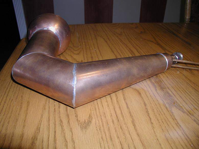

Howbout some photos of the ugly side too?
I'd like to see how the seamwork ended up....

The seam runs along the bottom. It's not every day that I get asked to show my ugly side! I will take a picture of it tonight if you buy me a drink first!

The cone was the hardest part of the build, but turned out alright.punkin wrote:Howbout some photos of the ugly side too?

Great work RumBull. Did you do the seam as a but join or overlap?

Thanks Rumbull, and ditto on duds question.

It is a but joint. When I started makeing that section, I had intended on an overlap. It just was not laying together nicely and would have created an issue where the large end jointed the other 3" pipe. I decided the but joint was going to work better and look better. It required several refileings and trial fittings before I had a good fit.

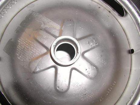

Next question,
It looks like you made the tri-clamp flange from a piece of 1/4" tubing, is that correct?
Very nice work by the way.

That was another challenge. It started life as a heavy guage (don't know the actual guage) copper grounding wire. I beat it with a hammer to flatten it into a wedge shape. Looking at it from the end, it appears like a triangle laying on it's side. That provided some natural curving and you need it to be tapered so that the clamp squeezes it down as it tightens, Just had to finish manipulating the curve to wrap tightly around the 2" pipe and then solder it up with some extra beef and file the bottom off nice and flat.Hawke wrote:Next question,

-the whole thing besides the sphere is made from 3" copper pipe which you cut, reshaped, and reconnected?
-how much length of 3" tube did you start with?
-how exactly did you reconnect the seams? both the long one down the tapered arm and the sphere.
-did you use any special tools?
ive been looking around and it would cost in the ballpark of $120 to make a decent 2 or 3 inch potstill from new parts from the store. all those big fittings get damn expensive! i feel this way would be cheaper and more fun as well as much more beautiful and effective to boot

There is a 1.5" to .75" adapter, the union, grounding wire, a short section of 2" and half of a 2" sleave. The sleave was added to give a wider base to solder the sphere to, this spot would have the most stress.eternalfrost wrote:the whole thing besides the sphere is made from 3" copper pipe which you cut, reshaped, and reconnected?
About 20", that was just the size of the scrap.eternalfrost wrote:how much length of 3" tube did you start with?
You just have to get the two pieces nice and flat where there is no gaps and solder them. I back the heat off as I finish the seam and build up some thicker solder.eternalfrost wrote:how exactly did you reconnect the seams? both the long one down the tapered arm and the sphere.
Just the miter saw to cut the pipe, roughly 30 degrees, if I remember right, which gave me about 60 degrees when assembled.eternalfrost wrote:-did you use any special tools?
