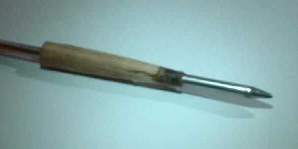

made a oak seal for my thermometer probe :)
with a little paste seal real good.
