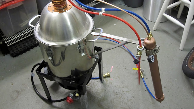

I sincerely hope you aren't insinuating that you would leave your still unattended and rely solely on a remote thermometer to run the show...Maxximus Flavius wrote:Still bored, and probably no life. Actually, I just enjoy spending time in the workshop while there's chunks of meat smoking on the BBQ. Especially on a holiday.
I've mentioned before, the difficulty I've had reading the column temperature with this tall build. I found these remote thermometers at Walmart for less than $20/per. I've tested them, and other than single digit display, they're spot on. Now I can lounge at the front of all the action and monitor the stuff I feel is important. The original probe thermometer is going into the condenser outflow line. I LOVE numbers. It makes things highly repeatable.
I meant remote as far as removing the local display from the top of the column. The units are wired and mounted on the cooling/product lines at a height where I can easily see them. The furthest I can get from the unit is 3 feet while hanging onto the display.rad14701 wrote:I sincerely hope you aren't insinuating that you would leave your still unattended and rely solely on a remote thermometer to run the show...Maxximus Flavius wrote:That would be a real problem from a safety standpoint...
You haven't seen much of that type of setup around here for good reason...
Still scared the crap outa me. There was droplets of hot alcohol being expelled out the vent hole, it was that close. On the plus side, I'm confident that the ENTIRE condenser head is sterile after that. The first thing in the morning is to disassemble and inspect. I'm not completely convinced that there wasn't some foaming out of the boiler going up the column (puking?). I''m going to pour the litre of product I have down the column to gauge the leakdown. And possibly clean any foamy bits out.rad14701 wrote:Choking and flooding is a major concern, especially with LM reflux columns... You learn to detect that sound really quick...
Yikes, this scares me.rad14701 wrote:Choking and flooding is a major concern, especially with LM reflux columns... You learn to detect that sound really quick...
It concerns me too. I wondering if I can install some kind of float down the middle of the condenser attached to a stainless spoke through the top. Might even be able to be hooked to a microswitch and gawdawful horn.lampshade wrote:Yikes, this scares me.rad14701 wrote:Choking and flooding is a major concern, especially with LM reflux columns... You learn to detect that sound really quick...![]()
What are the different methods for detecting flooding?
Also, can it be detected with a thermometer or sight glass?

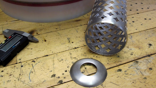

Yup, constant learning.rad14701 wrote:Maxximus Flavius, I have never had issues with my stainless steel structured packing... The stuff I use is very coarse, not fine like most copper... Can't comment on why you would have sparkles...
As for the choking and flooding it's just a matter of learning the limitations of your rig... You can only produce so much vapor and have it return back down through the structured packing before the upcoming vapor pushes it back up rather than allowing it to return to the boiler... The maximum amount of reflux will change as the alcohol is depleted from the wash... Adjusting heat input as the run progresses may be required if the problem persists...
Congratulations on the ~95% ABV...

Yes, the problem seems to have gone away. It must have been left overs from the manufacturing process. I tested them before I bought them with a magnet. I tested some copper scrubbers as well and they stuck to the magnet. Just a thin coating of copper on steel wool.Jncrtny wrote:Not sure if you resolved your Stainless particle issue, first thing I thought was for you to magnet test the scrubbers you have. It is a challenge to decipher posers when finding quality SS scrubbers, most are very poor and I could see this type of flaking with them. I use Copper screen mesh in my reflux, had done a great job and is very sound structurally.
