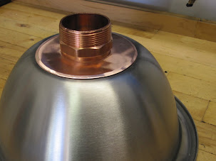

I did the first soldering on the column fitting. I`ve never had a chance to work on a joint this big, or use silver solder before. It worked out pretty good. The joint interface was a friction fit. I soldered from the bottom side. I was surprised at the amount of heat it took. Everything was well cleaned and smeared with acid paste. When I flipped it over after it flowed and cooled, I was pleased to see a nice little fillet all the way around the fitting. The wide ring bolted to the flimsy bowl is rigid enough now. I haven`t decided whether to peen the remaining lip of the fitting over on the bottom side for extra strength.

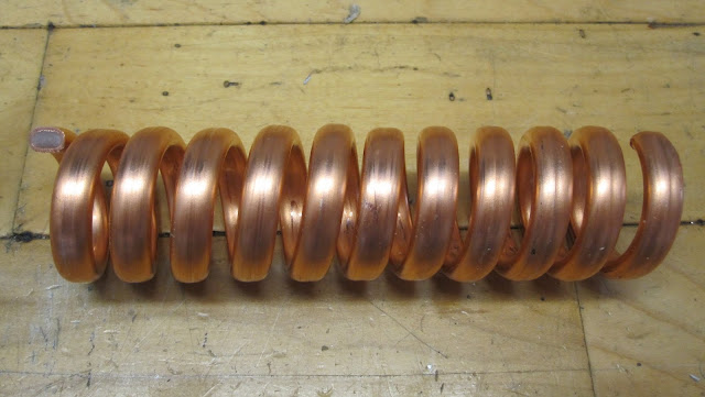

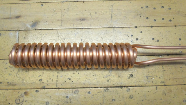

Very few times in my life do I nail something the first time. I'm highly trainable though. This site has done it's job. My first coil is a success with just very minor flaws. I wound the first coil without springs.
I wrapped it in cardboard until I had a O.D. of 1.45". I expected some crush on the cardboard and some slight deformation on the tube. I want to space both coils evenly in the 2" home that they're going to live in.
And the finished coil/condenser. I was able to grab a piece of the cardboard tube with a needle nosed vicegrips. A slight counter clockwise twist of the outer coil opened it up enough that the cardboard just slipped out.
The forming is very accurate.
I've successfully evacuated the parafin wax and done some flow tests. At 60 psi line pressure, it flows at just under 6 liters a minute. I calculate that I have about 17'-18' in the condenser after measuring the piece I had left and the test pieces I did. I flowed the 25' coil before I started and it flowed at 7 liters/minute. Am I happy? Yah mon! I've got video of the bending, wax removal and the flow tests. Working off an under powered netbook, it's a work-in-progress.
http://bit.ly/Maxxs_Bok

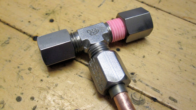

I've got the slanted plates cut and fitted in the head. Just need to solder them in and bend the little tab down.
I was pondering in how to install a temperature port. Came up with this. I had a stainless 1/4" tube fitting that I sawed on a angle to match the plates. My belt sander top roller is the same diameter as the column. I profiled the fitting for a close fit. Using soldering info from this site, I tinned and stuck it on to a test piece. I drilled a hole that is the same size as the temp prob in a tube cap.
A couple wraps of teflon tape and the cap is tightened on to the fitting.
You can see a little ring of teflon squished out. I seems to be a good fit.

More needle valve stuff
Post by Maxximus Flavius »
I decided to glue two caps together sooner than later so I can attach any length or shape of outflow tube. The second cap has a hole drilled a couple of times larger than the needle valve hole. A tube to tube union has to be used. I carefully filed and polished the joint so it's invisible Here's how it looks laid out.
And kinda how it will look in place.
