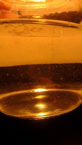

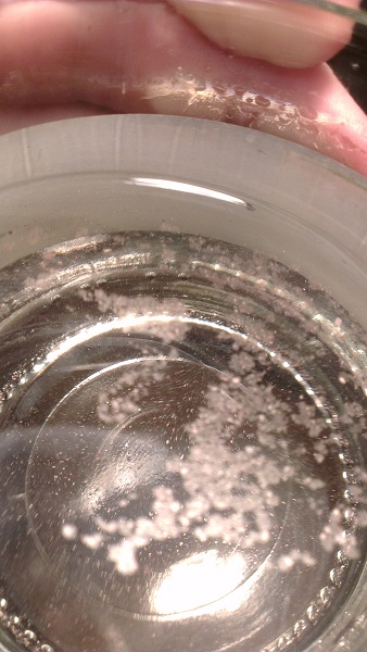

Update its stated flowing and the product is full of what looks like copper glitter. I know I didn't rince the column but I can't think of ANYTHING that could cause this. There was some copper balls at the bottom of the keg to let me know when its coming to temp. Surely they would not be able to come up the full-length of a metre column?
When i syphoned it in was incredibly sour. Could it be pulling then copper out of column? It seems to getting less by the jar but the glitter is still present. I think I'll shut down after this jar and wait on advice and have a look inside the column. The product have a biting chemicaly rum smell. Where as the late heads I pulled yesterday had a sweat almost appealing smell.

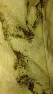

It was less of rust more a copper powder like residue that was built up. I have photos I'll be able to post latter.

ok so some photos...
side
side
top
top
cloth with flakes/rust

straight vinegar 7% pickling variety will clean everyplace you can't reach. just fill it and leave soak for 16 hours. everything including the first few microns of copper will come out.
the flecks look like oil from the rum, same as what i got out the tails on a feed molasses wash. kinda shiny mica-like in appearance red/orange/purple/black irredecnt.
My rum tased like shite too. put it on oak for 3 months, it was getting better, but i'm at about 9 months now and it tastes worse than ever! i'm thinking it was a shit recipe, executed poorly (mine i mean-i'll leave it to you to judge yours)
if that element is ok...thats my guess anyway.
