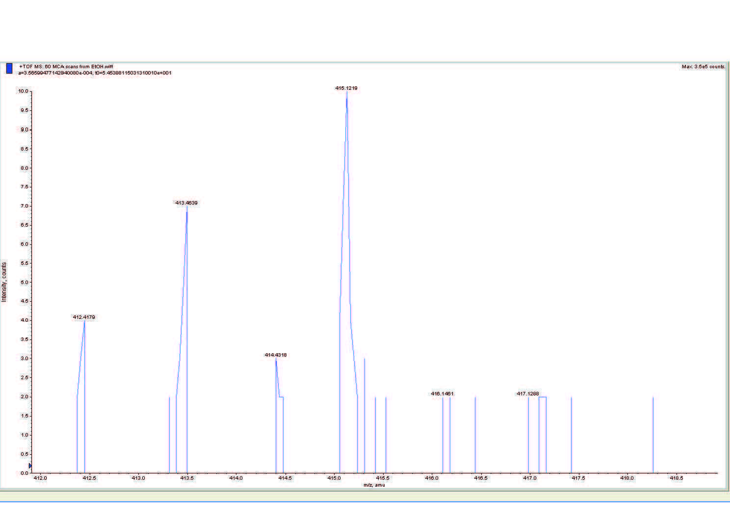

Alright, I did a mass spec run on ethanol with PTFE tape. I used the Mil Spec stuff that's made in Malaysia. I boiled 1g of the tape in 20ml of 95% ethanol for about 30sec and then ran it on an ESI MS. I have attached the TIC of the run for the range of m/z that we would expect to see PFOA (~415m/z) charged to +1. There is one ion that's in the range. It has a charge of +1 and an apparent m/z of ~415.1, which may indeed be PFOA. However, the number of counts is minuscule- so much so that I can't really even say if this is a peak or if it's just noise.
I just want to warn you guys that I am by no means an expert in MS (I'm a novice at best). This was a quick scrapped together run. Not necessarily conclusive by any means, but a good piece to the puzzle. Had I PFOA available to me, I would run that as well as a control. I hope this helps, take it or leave it.

Damn that was fast!
Thank you kindly, sir, every bit helps.
Is the vertical line just below 414.8 the single ion?

I forgot to adjust the m/z for the additional proton. See my revised post.
The ion could in fact be PFOA, however it looks pretty much like noise to me. Even if it was PFOA, we're talking about 10 counts in ~10ul. To put that in perspective, 10ul of ethanol has ~100000000000000000000 molecules of ethanol in it. So 10 detected molecules really isn't anything. Furthermore, the intensity of this ion equates to 0.00285% of the total intensity of the run... so virtually nothing.
I also ran just 95% ethanol and I have attached the same window for that run. As you can see, this same ion appears in this run as well. Subsequently, I would have to say that this ion is not a consequence of the PTFE but rather some trace contaminant in the ethanol that I used. Like I said, it is most likely noise, especially at this intensity.
I really don't think there's any PFOA in this stuff- certainly not an appreciable amount. The Chemist didn't see any on his runs either, albeit it's possible he missed it if it only charged to +1.
This is of course all speculation. I am in no way endorsing the use of PTFE... just giving you some info (that may be fake for all you know) that you can weigh in your decision. <--- Liability stuff!

Centimeter, is 30 seconds the standard time protocol for this type of a test...??? I'm only asking because in real world distillation the product would be subjected to hot ethanol for up to several hours and breakdown may not occur until a substantial time of exposure has passed...

I don't know that there is a standard protocol. PFOA is soluble in water and polar solvents, subsequently it should have dissolved in the ethanol quite rapidly- especially if you consider the surface area of the tape. PFOA is not a breakdown product at this stage, it is just a potential residual contaminant from the polymerization reaction.
We're not looking for breakdown/pyrolysis products. Those would appear at way higher temperatures than what exist in a stil.
It looks like Wikipedia has updated its info on PFOA. Looks like they say we're in the clear too:
"Perfluorooctanoic acid (PFOA or C8)—in the form of the ammonium salt (APFO)[16]—is used as surfactant in the emulsion polymerization of PTFE,[17][18] and has been detected in some PTFE products.[19][20] The levels that have been dectected in non-stick cookware range from non-detect to 75 parts per billion.[20][21] PTFE products such as thread sealant tape have had 1800 parts per billion of PFOA detected.[19] Non-stick cookware is heated to volatilize PFOA.[19]
A DuPont study on Teflon PTFE did not detect any PFOA above their detection limit of 9 parts per billion,[22] and DuPont says no PFOA is in Teflon cookware.[23] A 2009 USEPA study found levels of PFOA in non-stick cookware ranging from below the detection limit of 1.5 parts per billion up to 4.3 parts per billion.[20] DuPont says there should be no measurable amount on a finished pan provided it has been properly cured.[24] While PFOA has been detected in the low parts per billion range in the blood of people,[25] exposure from non-stick cookware is considered insignificant[26][27]—despite the marketing of other wares. However, at temperatures well above those encountered in cooking,[28] PFTE pyrolysis can form minor amounts of PFOA.[29][30]"
