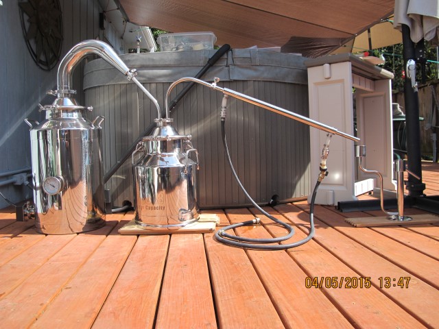

- piperdave
- Posts: 348
- Joined: Wed Feb 18, 2015 6:29 am
- Location: Great White North
Re: Setting up recirculating cooling system
Most pond pumps are mag drives. Looks like the one you picked is as well. In the picture of the one you picked it has a valve on the output of the pump. I wouldn't use that valve but use a valve on the return. Otherwise the pump looks fine.

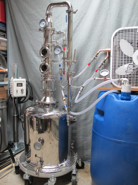

You could also do a "kidney loop" recirculation: split the output from the pump with a tee, have one leg go through a valve and onto your condenser, and the other leg go through a radiator and fan of some sort and back to your reservoir.
The mag drive pump you linked can supply FAR more water flow than you need for your condenser, this way you get to use the excess capacity of your pump to cool down your reservoir too. In a way that's independent of the flow control of your condenser.
If you find that you're not getting enough flow through your condenser (highly unlikely) add a gate valve to your radiator water line and restrict the flow a bit until you do.
In general you REALLY dont want to starve a pump on the input - even a mag drive pump - it'll destroy the pump in short order. Mag drive pumps are the only kind of pumps that you can get away with closing off the output but even those it prematurely ages the pump. It's much better to have it constantly flowing and then tap off what you need.
