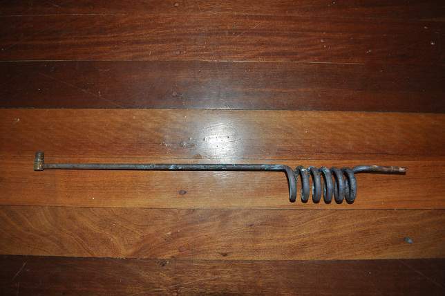

There's a smallish dia. very short coil in the top of it, I've filled this with copper saddles from the brew shop & then stuffed the rest of the column with copper scrubbers.

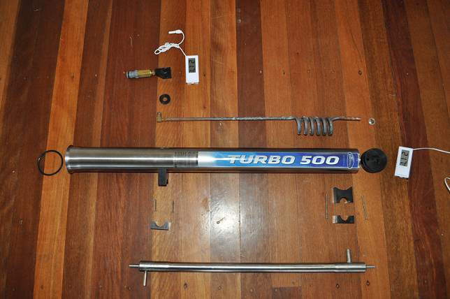

Hey, Austin Nichols, any chance you could post some detailed photos of that still so we have them for future reference...??? We quite often run into situations such as this one where we are attempting to give support for rigs we haven't physically laid our hands on and perhaps seen only a single photo... Any additions to our knowledgebase helps us more readily assist members in need...

Yeah no worries I'll get some pics in the next couple of days, I was going to see if I could pull it apart to give it a really good clean anyway.rad14701 wrote:Hey, Austin Nichols, any chance you could post some detailed photos of that still so we have them for future reference...?

Perfect... Thanks... That helps a lot...

Yep it produces a pretty good neutral, I get usually about 92 to 93% from the half dozen runs I've done with it.
Pulling the thing apart and putting it back together is quite easy really, probably could do it in under half an hour all up now I've done it once.
One thing not shown in the pics is there's a long copper sleeve inside the still, and I've packed the coil and column with copper scrubbers instead of the ceramic saddles that were in it and the alcohol is much smoother from it now.
