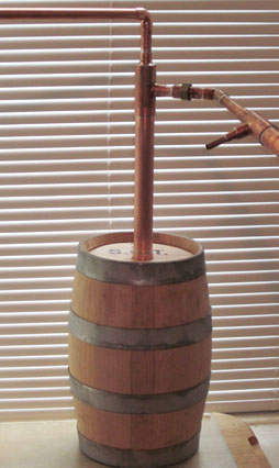

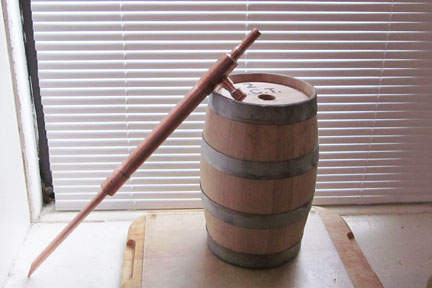

I've been wanting to try a thumper for some time and figured my Colonel Gooseneck head was probably the most likely candidate. Logistics in an "in-house", stove-top rig is always a problem/concern. But I finally got everything mocked-up, measured twice and soldered up. Here she is:
The barrel is 2 gal gibbs brothers, I ordered with no bung (ie., holes) drilled. I drilled out the top. The thumper design is one that I saw "here" in the forums Don't recall who's design it was..sorry..or I'd give credit where it's due. It's a 1" copper tube with a 1"x1/2x1/2 reducing Tee. The 1/2 inch tube is pushed up through the middle. So basically, the 1/2 tube transfers vapor down to bottom of keg..and 1" tube transfers the vapor out, to a liebig attached on the other side of the T. Its all in-line as it were instead of being 2 separate tubes going in and coming out either side of the barrel. I haven't had a chance to use it yet, just got it all fit together and soldered up. But, plan to do a clean run this weekend.

That is the perdiest stovetop I have seen
my only question would be about the arm leading to the thumper being so long and thin, I don't know but I would expect some condensation to form in it
but it looks great can't wait to hear how it performes.

Pretty damn cool man. I love that. I cant wait to here how it works.

I reckon it could happen...have to wait and see. The arm coming over to thumper is about 38". It's hard to see from picture angle, but it has to be like that to clear the stove. I had to mock it up 3x soldering bits and pieces at a time, in order to get everything lined up properly so it would hit the barrel parallel and the fittings would fit (proper angle). So, I'm hoping it's not going to be an issue (fingers crossed).Rabies wrote:That is the perdiest stovetop I have seen

That should be OK, dont forget you need to put a bit more power in when your driving a thumper.

Oooh. The lyne arm.
Gonna be hot. May get some type of passive reflux action.
Seems fine (again )
Seems fine (again )

Nice looking rig... Like the single orifice thumper plumbing...

Thanks for all the comments/advice, etc. It's really appreciated. I've always wanted to try a thumper. I've read enough to have a "general" understanding but wanted to experience it for myself (and add the capability to single run a wash...beyond my CM reflux Ga Ridge head).
Nobody commented about the original liebig (in the lynearm loop over the head of the cap), is still intact and functional....ie., could run water to it first part of the run to pre-fill the thumper with low-wines, then shut the water off and let it heat up? Didn't want to get into that for first runs, but the option is there. Not sure it would work though, given the the length of lynearm and how straight it is. Probably pool up.
The design (single in/out) was not mine. I found a picture of it somewhere and liked it...saved it. Don't know who's it was, so don't know who to give credit to for it. Just wanted to make the point..that it wasn't my original concept design. I just used/borrowed it
The barrel is a 2 gallon toasted Gibbs brothers barrel with a plugged and ground off bung. I drilled a 1-1/8" hole in the top...but my drill SUX and was wobbly so it came out a little oversized (note to self...next time, use one size "down" and file it the rest of way out — or..buy a better drill!). So, I slid a copper join over my 1" pipe to act as a shim/sleeve and soldered it in place, then used a file on the hole till I got it to drop down in the hole (not the cleanest job there, but I think it will work). A little dough/paste should fix it right up. I soldered the 90 degree elbow to the lynearm, but not to the top of the thumper head. This lets me position everything more easily and it stores (breaks down) better, and didn't require fixing the angle between the lynearm and the liebig at the top of the thumphead — it allows for further adjustment once it's all tightened up. I could put another 1/2 union somewhere near there to separate the lynearm from the thump head, but I don't think it's going to be necessary. We'll see after a shake down run. It seems to fit on there rather snug, and with a little thread tape, etc., and/or paste, I think it will be fine and less prone to leaking than adding yet another union. Have to wait and see.

Just wanted to add for anybody who's interested in making one of these: To mock it up several times and solder a little bit as needed as you go to make everything fit good/right at the angles it needs to be at. Secondly, other than the crappy drill job for the hole in the barrel, the other thing I had to fiddle with was getting the inner 1/2" tube to solder up "straight" (or relatively so) inside the 1" tube rather than pushing to one side of the tube. I solved this by putting a 1" to 1/2 inch fitting reducer in the other end of the 1" tube without soldering it ...just to hold the 1/2" inner tube centered inside while I soldered the top of the tube in the T. I then removed the fitting and the tube was centered nicely.

That little barrell is so cute! I just want to take it home and raise it into a full grown 55 ...
I bet it will make a really nice sound. Blump blump blump...very nice.

Yep...guess some got bigger thumpers than others
But, it's not the size that counts
btw...I searched back and it was Olddog that posted the pic of that thumper head design. So, credit due
