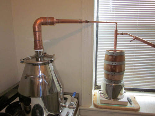

It's "baaaack". Stovetop
Thumper II.
So, built myself a rig that I can play with. Here's the new model taking into account most of the comments/advice given here. First, I started with a 8gal pot, with ferrule. That's a 2" pipe about 8" up and over to 1" pipe, then down to 1/2" at the connection. No more loop-d-loop over the top thang (as per several persons mentioning issues with the design). Then, I raised the thump keg up and shortened the distance as much as possible to the stove to drive more heat (as per goose). I shortened the thump head a few inches as well. I ran higher abv low-wines instead of water (as per Dunder)
So, how did the adjustments fare?
Single run on 6 gals of All-Bran at 11%, 1 quart of 45% low-wine (corn) in
thumper.
The Good: heat up time was definitely shortened. Within 3 mins of the lynearm heating up, the first drips started coming over. That quickly built to a kind of broken stream. It was outputting at 40ml per min, but in a sort of broken/dribble/stream. Im not exactly sure how much each thing contributed to the shortened warm up time.
The Bad: it made no difference as to heads/tails compression and reflux when single running wash. Results were the same (ie., basically a potstill run that starts out a small percentage higher in abv and falls linearly as it goes.) "The magic" never happened.
I'm coming to the conclusion, based on this and other experiments, that there is a threshold amount of volume of alc that has to be present before that kind of compression/reflux can occur and be sustained (ie., for the "magic" to occur). I've got another thread going in the Theory Section to discuss some of those findings. I already know from previous experiments that increasing the abv of the
thumper charge..would not affect this. It might make the run start out a few points higher...that's about it. So, I would like to find out exactly what abv still charge in the pot...it would take to break out of the linear, falling abv/rising temp and flatten it out..ie., maintain constant abv for a good portion of the run. Secondly would be to find out if this holds regardless of which reflux system I use (ie., bubble cap, boka, CM,
thumper), or whether it varies ..and by how much. But, that's for another thread
The "theory" would suggest that no matter what you start with in the pot, that it should do this reflux "magic" the same way....perhaps the only difference being that if you start out wiht low abv, it would sustain a lower average abv over time. But, this has not been what the empirical data suggests! That's enough to know that it has an impact on the use of a
thumper. I'll leave the rest for further discussion in the other forum.
