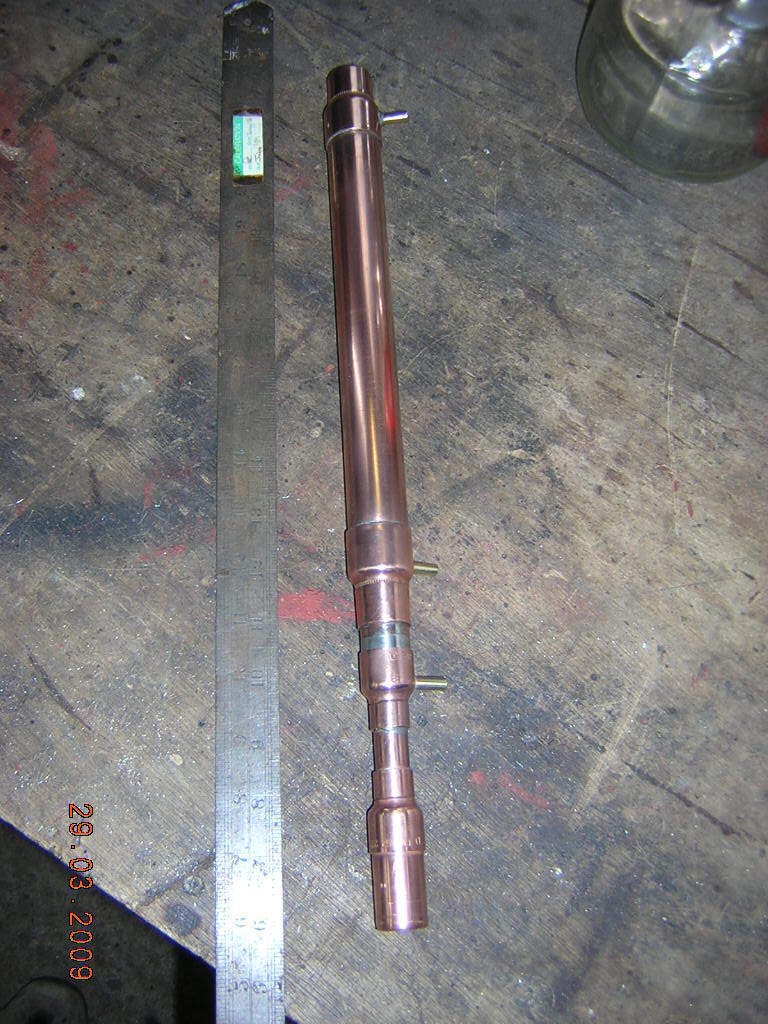

John, your concentric column is simple and compact, and superbly built. Thanks and I'll be following this thread with interest.
The only vent to the outside that I see is the takeoff outlet, does any vapor pressure cause the output to blow or sputter? I guess it depends on the performance of the condenser. Further back someone mentioned putting a valve on the outlet - wouldn't that create the ability to completely seal the system?

The stills dimensions are not super critical but I will give you a guess . The 3 tube sizes are readily available in the UK and are 28mm , 22mm and 15mm copper plumbing tube . You will need the following
1 x 28mm x 300mm long copper tube
1 x 22mm x 300mm long copper tube
1 x 15mm x 200mm long copper tube
1 x 22mm blank cap
1 x 28mm blank cap
1 x 15mm brass tank connector ( for lid of boiler ) (search on the forum for treatment of brass fittings)
1 x 28mm to 22mm pipe reducer
1 x 22mm to 15mm pipe reducer (both of these will need the pipe stop filed out from the inside so the smaller tube will slide through)
3 small stubs of 6mm copper tube for water in/out and product out .
none of the sizes are critical and any 3 tubes that can be made concentric will do as long as you can get the reducers . If you have read the parent site in detail you should be able to work out how it all goes together and works . It is quite a fiddly design to make for your first still and quite awkward to solder together so assemble it dry first and use a bit of commonsense .Good luck and if you do build a still of any sort post it up here for all to see .
In reply to the other question , I have had no problem with the still sputtering even when run at full power . A previous poster mentioned the idea of fitting an external reflux valve to the outlet to allow the still to partially flood and reflux some of the product . As you mention this would in effect allow you to seal the system so if you wanted to do it I would suggest that you would have to drill a bypass hole in the valve somewhere . To be honest there are a lot of better designs than this for reflux stills so I would not bother myself . It was designed as a pot still that is small and compact and works pretty well within the constraints of the design . I think the reason that it does not sputter is that the condenser knocks down the vapour pretty quickly and the only reason the product comes out warm is the proximity of the outlet to the vapour inlet .

My idea is now to extend the vapor tube deeper into the outer liebig to force the vapor a longer way down the cool walls. I hope that stops the puffing and vapor pressure issue.

WARNING !!! UNSAFE DESIGN !!!
Post by Master-Peter »
I have received a warning from Harry . He's right with his concerns. Even when the design has approved working like a charm so far I'll put it on my wall of shame. It's explosion prone.
For your reference here the original quote from Harry:
I hate to be the alarmist here, but....
The design has a 15mm narrow tube delivering vapor to a 28mm chamber. That means there's 6.5mm space between the wall of the tubes. A narrow space.
If it pukes you won't find it in the parrot. That narrow space will become effectively blocked. Then you immediately get an over-pressure situation in your rig.
With luck, the obstruction will be blown out forcefully through the takeoff. Without luck (Murphy factor) the puke will be forced even tighter into the tubespace & outlet. The rig becomes a rather large bomb. The bad thing about that is, you may not even notice the blockage, & a minute or two later, you'll probably be dead with a piece of steel keg or copper pipe stuck in your head and a big pile of rubble where that brick wall used to be.
I'm sorry, but it's a bad design safety-wise.
There are some things you can do, like install a large blowout plate or plug in the top of the keg. But you still have the issue of removing the gunk from the closed chamber, and you still have the problem of not being able to see or prevent a potential puke. And it will happen because while you're doing sugar runs now, at some point in the hobby you will try a mash with solids in it. We all do eventually (grains, fruits). But by then (if you're still alive) you will have forgotten that your design isn't suitable for solids. Even molasses wash is prone to puking.
It's a disaster waiting to happen.
But don't take my word for it. Ask any engineer. There's a few here, & lots of groups online where you can ask about vessels and pressurization.
Good luck.
Edit: I fogot to ask...You DO block off the holes in the pipes when you're not using it, don't you? Mudwasps, spiders & lizards like small dark places to live & build things. Those become the unseen, un-thought-about blockages also.
_________________
Slainte!
regards Harry
I fully follow his concern. Further oversizing, so the gap between the inlet tube and the outer liebig becomes bigger, might be a way. But not cost effective.
As it is this head makes rum or boom depending on Murpheys mood.
Another beautiful piece of copper scrap for my wall of shame, on the one hand. Some more steps on my learning curve on the other.
Cheers
Peter

Master-Peter, while there are some valid concerns it should also be noted that this design isn't intended to be used for distilling on the grain in the first place... Beyond that, it would be simple enough to incorporate a safety release if deemed necessary... Harry does have a legitimate concern with relation to distilling on the grain, however, and anyone considering building this design needs to take this limitation into consideration...
I had thought of the whole pressure issue when the original design was posted yet I'm still considering a similar design for strip runs because I only put well cleared charges in my boiler...
Don't write your efforts off as a total loss just yet...

I really like this design and had a thought to address the safety issue. What if one were to let middle size tube extend out the top of the larger tube and then just set a pipe cap on top of it so it could pop off in an over pressure situation? Thoughts?
Posts: 20865
Re: New member . New still
Post by rad14701 »
Ethanol Al, with this design you can never have a shut off valve because that could allow pressure buildup... It makes for a very compact stripping head, that's for sure... It might even work for RLM because the take off would always be open to the atmosphere...

This design could easily be converted to RLM... Simply reroute the take off port downward, create a new take off point, and then put a needle valve and reflux tube below that with the reflux tube returning the reflux into the center of the vapor tube... This design can also operate at any angle from vertical to just above horizontal for added height - and could even be mounted off a packed column... The trick is to never close off the take off port...

Sorry for not posting for a while but my life has been busy of late . Following concerns posted by masterpeter, I redesigned the still so there could be no build up of pressure if the outlet were to get blocked . I have never had the problem as it was designed only for distilling well cleared sugar washes but it was pointed out to me that these are public forums and other people may use the design to distil other stuff . I modified the design to a 2 part still which has made it easier to clean out . But did not post the replies here . My apologies . Attached are some photos of the still as it now is .
top view
top view
bottom part
bottom part
still in 2 parts
still in 2 parts
assembled still
assembled still

yep I think now it is quite foolproof. I am just thinking of converting mine to a RLM head. This design could give a real nice RLM head on top of a column and is a great pot head for stripping without, as RAD already pointed out.

Just ran my 6 month old wash through the new still and I think that we are on to a winner . When I sober up in a few days I will give you a more impartial view . Managed 1.5 litres or so at 66% .

The modification was to build the stillhead in 2 separate parts, so in case of blocking of the outlet no overpressure can build up. Besides, it is easier to clean that way.
You can see it on the picture "still in 2 parts" from John. This is different from the previous model.
Cheers Peter

How are you sealing that (slip?) joint John?
Posts: 20865
Post by rad14701 »
LWTCS wrote:How are you sealing that (slip?) joint John?
I'm sure flour paste would work perfectly, if it needs anything at all due to the lap joint... Similar slip joints on my still have never leaked because vapor takes the path of least resistance, flowing up onto the condenser, and the condensate is at the mercy of gravity...

The slip joint is not sealed with anything . It was unsoldered from a previous incarnation and the male part wiped when the solder was wet . It is now a tight sliding fit and does not leak at all in use . As the top of the still is now open to the atmosphere there is zero pressure in the body of the still to make it leak .

Thanks,
Can you also describe how you are installing your nipples (your welds are really nice)?
