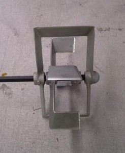

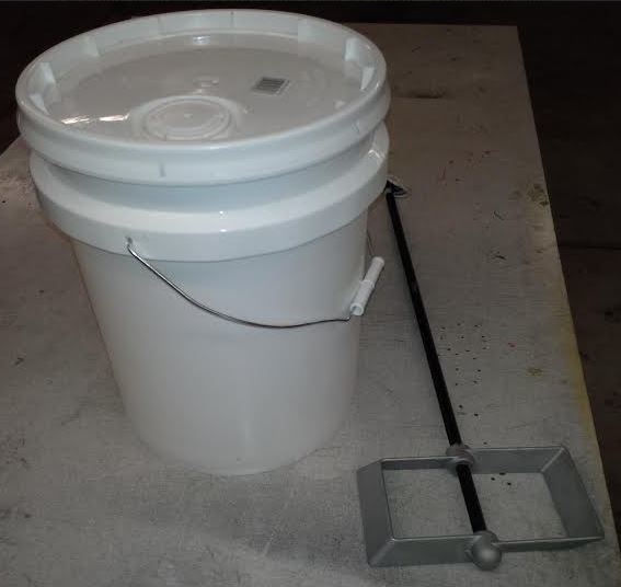

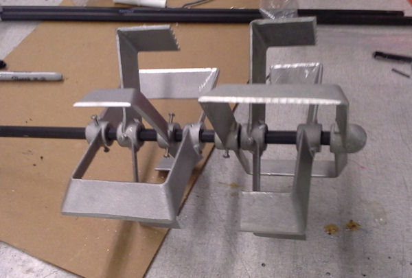

Then I added a second blade to make the MkII,

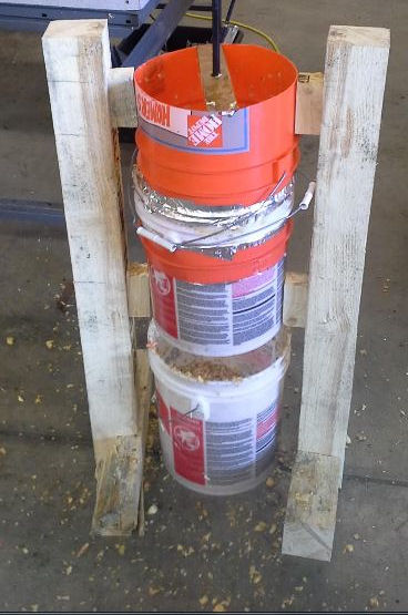

then I went back to Lowe's and bought 2 more and made the Mk III chopper which was the prototype that lead to this newest chopper.
In retrospect I wish I had bought 6 mixers, but as they say, hindsight is 20/20.

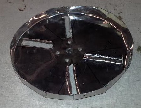

Now this brings me to the apple chopper Mk IV which I have been working on lately and finally decided to share the details of the build.
I began with the Mk III which had some shortcomings. First and foremost is the plastic bucket I was using it in. This thing was both fun and terrifying to use because even though it was only being spun at 1650 RPM I could never shake the thought of a potential catastrophic blade failure which could send a blade right through the side of a plastic bucket and into one of the people operating the contraption. I found that to be a rather unpleasant thought so I started looking for a suitable tube to put it in. The problem there was the blades on the chopper are a little bigger than 8 inches so an 8 inch tube was too small and a 10 inch tube, much like a bucket, was really too large. The eventual solution came when I found myself with a 32" X 36" sheet of .032 thick stainless steel. With a little thought I figured I could roll that stainless sheet into a 9 inch tube giving the blades a much tighter and more efficient chopping ability.

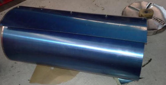

So that decided I set about making a bottom for the new chopper. I began by making a rough circle a little bit larger than the blades themselves. I didn't use anything to actually measure just got a rough circle by tying two pens together to use as a compass. Then I cut the circle out and cut a piece of stainless out a little larger than the paper circle. My original intention was to cut out a piece of plywood to form the shape out of but didn't have any plywood so I wound up just using a piece of wood. This worked OK but far from perfect. Fortunately I don't need it to be perfect.
So I used used this rough circle and rolled the stainless into a tube to fit around the base I had just made.
Next I I began drilling the tube and bolting it to the tube to make it as tight of a fit as I could. In truth it isn't very tight but it is tight enough.
Once I got it screwed down all the way around I drilled some holes up the side to hold it all together and it looked like this.

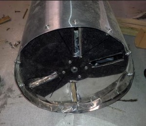

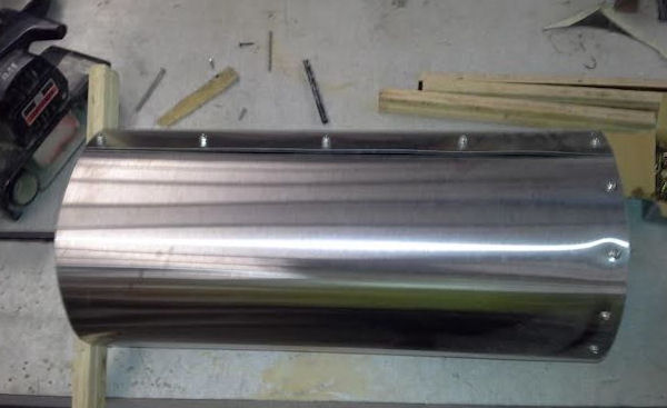

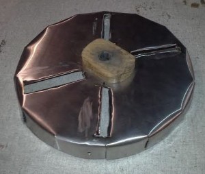

After the size and shape was determined I cut some slits in the bottom for the pulp to pass through. It is difficult to see in the pictures but I bent the leading edge of the slots up and sharpened it to act as an additional blade to further cut up apples, the other side I bent down at a 90 degree angle which helped stiffen it up. Then I drilled the center hole and added the bearing block salvaged from the Mk III.
Next I trimmed the excess off the tube then began bolting/screwing the whole thing back together

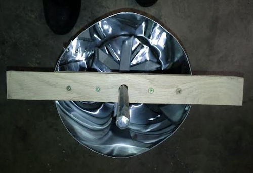

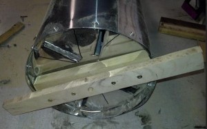

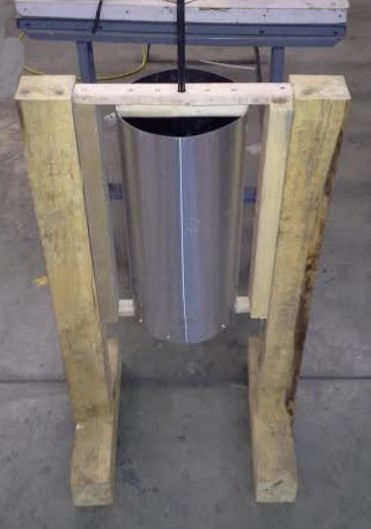

I cut cut some oak pieces to use as bracing and centering pieces
One went in the top, the other the bottom
Then I added additional pieces of oak flooring to attach it to the stand

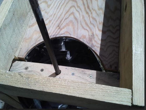

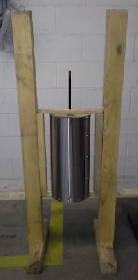

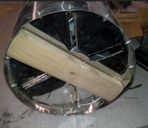

Now that I had the cross supports in it was a matter of adding a couple short 2x4 pieces to the legs to attach it to then mounting it to the legs.
Here is what I have so far
and here is a shot looking down the business end
You definitely don't want to put your hand down there while it's running.

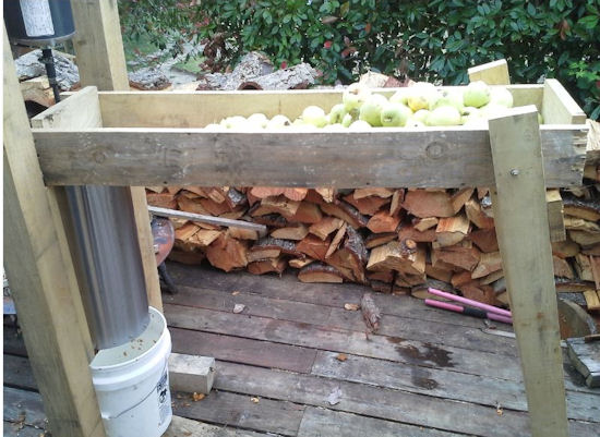

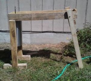

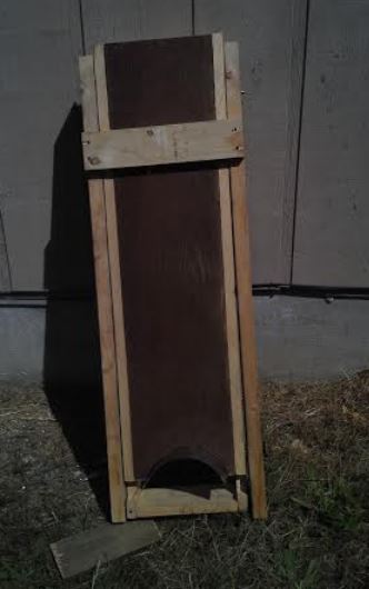

Things are coming along nicely with the chopper setup. Today I more or less finished the chute.

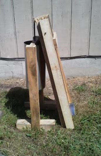

I made it so it will hook over the cross brace and sits at a slight angle to make it easier to feed the apples into the chopper but not have to be directly attached.
When not in use it can then be folded up for storage

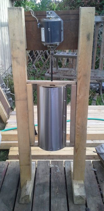

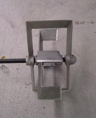

Apple season has begun which means that I am way behind, as usual :roll: Fortunately today I found the time to just about finish the chopper :D
As you know I have decided to go direct drive rather than pulley driven which meant that I needed to extend the legs to be tall enough to support the motor. This meant cutting new legs. The whole thing is about 60 inches tall.
Once the legs were extended I mounted the motor to a piece of 3/4" plywood.
Because I forgot the screws at home I then had to take it there to finish working on it. I added some 2x4 pieces to the legs to act as spacers for the motor then mounted the plywood to the 2x4s. The only thing lacking now is a coupling to connect the motor to the drive shaft. I did a sort of half assed thing to try to work as a temporary measure but it didn't work so I will just have to wait until I get the coupling to run it with the motor.
In the mean time I can still run it with the cordless drill.
One other issue that comes to mind is with all that weight up so high I think the feet need extended to give it more support. It also has gotten quite heavy. I can still lift it but it is pretty cumbersome to move around.

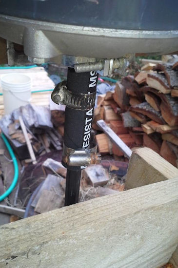

Today I took steelmb's advice and sought out a bit of 1/2" hydraulic line. I managed to procure a piece about 6 or 7" long for free :ebiggrin: I cut it into 2 pieces and used one as a coupling
Next I took a bucket of apples
Loaded it into the chute
And started it up. It worked like a charm until it became evident that I had a bit of a flaw in my design. I believe I already mentioned that the slots might be to small or too few and that proved to be the case. With a 1/3H.P. motor running at 1650 RPM the apples were chopped into pieces very quickly and clogged the outlet slots.
This will be easily remedied tomorrow by cutting larger and more slots which will allow the pulp to pass easily through into the bucket.
