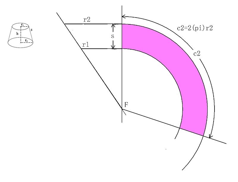

There have been several requests recently for a way to lay out a template for a cone. Here is the old school, low tech method. All you need is a measuring stick and compass. If it is not clear, please ask.
1) Draw the vertical origin line.
2) Draw r2 and r1.
3) Draw the diagonal to locate point F.
4) Draw the arcs extended from r2 and r1.
5) Calculate the circumference of the base c2. Divide by 20.
6) Set your compass to the distance c2/20.
7) Walk your compass 20 steps along the arc of r2. This will be the distance c2.
8) Draw a line from that point through F.
9) The purple area is your template.

Nice! I like the clean, simple way to make an important and difficult to handle part!

Love it. I learnt this in trade school and have used it many times. Circles are difficult, cones are more so. One of the best bits of maths that I know.

Nice write-up... I prefer the method Dan P. described in his Frustum/cone development for lyne arm etc. topic... Virtually no math required... That was the method I learned to make frustum patterns by years ago... Been using the method recently in preparation for making a dust separator... Software works great but if you don't have a plotter it's easier to do hand drawn layout instead of piecing standard printer paper sheets together, IMHO... Just wanted to offer up another option for those who haven't stumbled across this alternate method...
