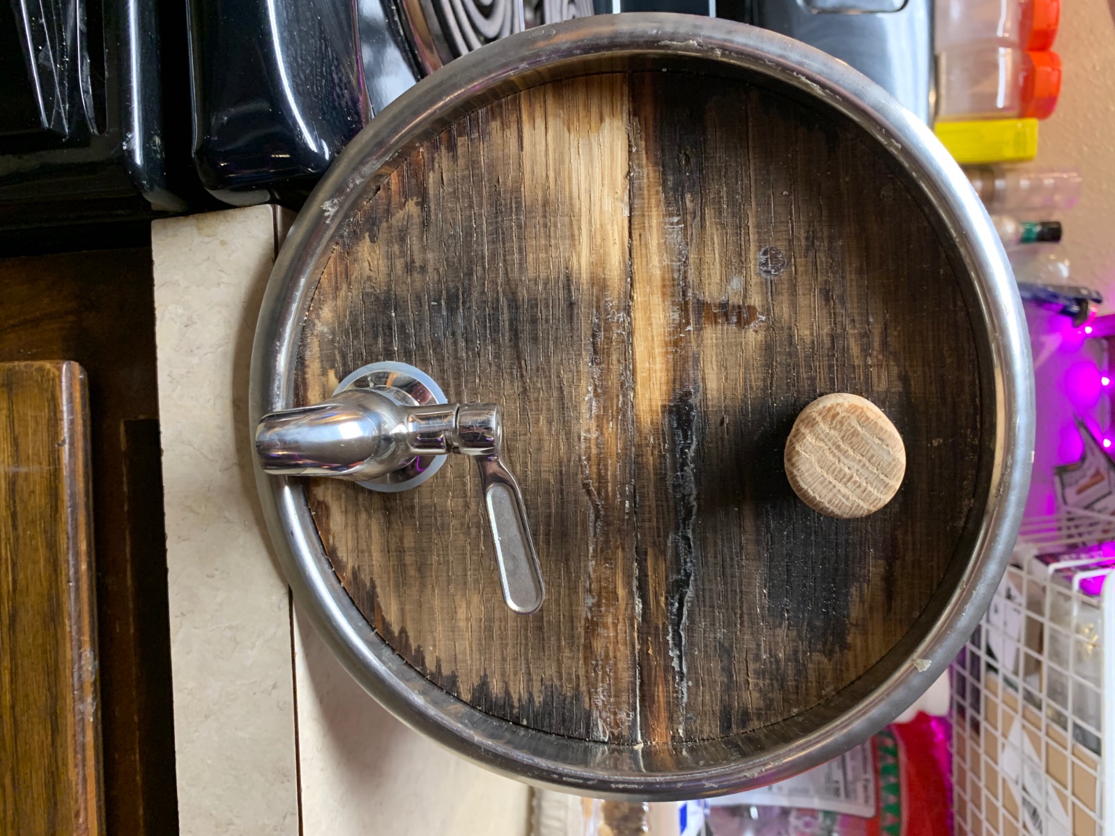

Ok, so after a couple different approaches here’s what I went through. I ordered a used but good condition whiskey barrel head. I Sanded the char off it as best I could and used it and my face side. Then I added new dowels in tighter groups to accommodate the smaller diameter and get a solid hold of the staves together. Which by the way was my toughest part of the whole process with my particular skill level. Once I screwed up about 6 I started to figure it out though.
One note I will mention is I went with 5/8” oak dowels. I used beeswax in between the staves. One thing to mention is it’s easy to overdo it on this step. A thin coat is required for your joints to come back together. Then once I got the staves together I attempted to use a router but to no avail wants clean enough and was difficult to get through over a solid inch of oak. So I end up using a small circular saw and cut off all corners and sanded down til I had a circle. Next I drilled my holes for the tap and bung. Screwed my tap in.Then I used a small hand torch to char the clean face that wasn’t originally charred. After that I hammered the head into place. After another thin coat of beeswax around the head. You can see where it Indented where the staves come together but it seems to be holding water this far.
I plan to put some apple brandy that’s been waiting to be run for over 3 monthes in this barrel if it works out. Also I like the look of it with the burnt but sanded down staves on the face.
I’ll return with final verdict

To get my dowels to line up I drill holes on one side and put in the dowels. I then take a piece of charcoal and blacken the dowel end sticking out. Now I line up the piece with the dowels with the next piece. I "squeeze" the two pieces between a couple of boards to keep them aligned as I move them together. The charcoal marks the spots on the next board where the dowel holes need to go. I would not need to do the "squeeze" if using a head to cut the pieces but these were cut from staves so they have some curve to them.

I made a jig for the drill press (inspiration from the badmo YouTubes) but it works fine with a hand drill. I just mark on the drill how deep I want to go.

In the end this is the way I found worked for me as well. For now anyways. Once I’ve made a few I’ll start to figure out what works for me and my skill set and tools and space ( or lack thereofsubbrew wrote: ↑Wed Mar 08, 2023 7:25 pm To get my dowels to line up I drill holes on one side and put in the dowels. I then take a piece of charcoal and blacken the dowel end sticking out. Now I line up the piece with the dowels with the next piece. I "squeeze" the two pieces between a couple of boards to keep them aligned as I move them together. The charcoal marks the spots on the next board where the dowel holes need to go. I would not need to do the "squeeze" if using a head to cut the pieces but these were cut from staves so they have some curve to them.

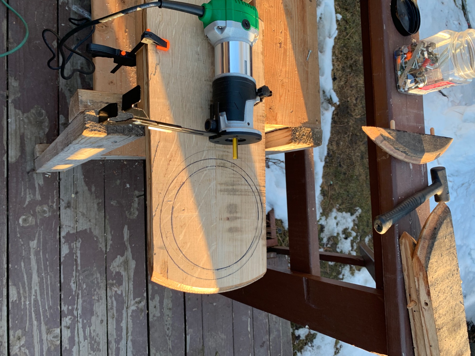

Why would it burn the wood? It's a computer controlled router, it only burns if you're doing it wrong.jonlah wrote: ↑Wed Mar 08, 2023 1:25 amNow we're talking, could bash them out. Does it burn the wood though?BlueSasquatch wrote: ↑Tue Mar 07, 2023 1:21 pm I've got a 30x30 wood CNC that could be programmed easily enough to cut a tapered circle out of a solid piece of wood. Could do the same for the holes as well.
What's the pro/cons to a single piece of wood? Menards sells 3/4 x 12 boards that could be a single piece. Seems to save the multi-piece glue up, but I assume that's the way to go for a reason? Wood Buckling?

Ah, CNC router. I'm new to CNC and have a laser one. I assumed it was a high powered laser cutter.BlueSasquatch wrote: ↑Tue Mar 07, 2023 1:21 pm Why would it burn the wood? It's a computer controlled router, it only burns if you're doing it wrong.

Sometimes you'll get a little burning with CNC, but it really doesn't matter on something you are going to char... if your tool is sharp, and the feed/speeds are correct it's pretty minimal.
The reason you make things like barrel heads from narrower pieces is to prevent cupping, a wide board will tend to cup quite a bit in one direction, narrow boards do cup, but you alternate the cupping direction and on average it stays flat. Again, it probably doesn't matter for the badmo's, it could show but shouldn't effect the actual construction.. on a barrel if it all cups one way you will blow the end out.
Go with the wide stock (make sure its quarter sawn, will prevent cupping and seal better) and yard age it for a season or two... put it where your sprinklers can hit it. The chances of you getting 12" wide white oak that contains no sap wood is pretty low (sapwood will rot under prolonged moisture exposure), getting a piece with perfectly quartersawn grain is even less; the trees that big don't get cut down very often any more.

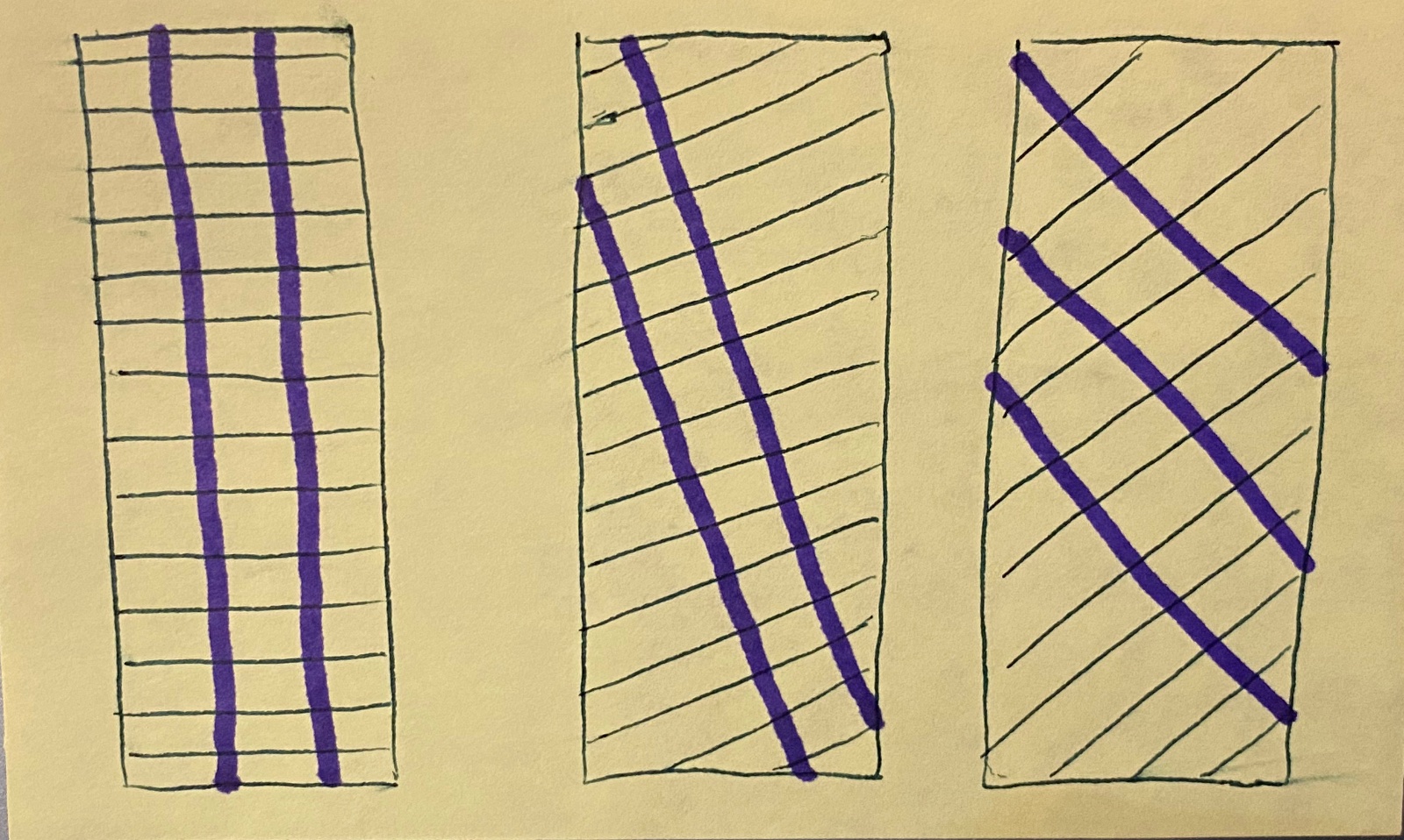

There is a big drawback to using a single piece of wood for the barrel head. In most cases, that single board head would leak more than one using multiple staves.BlueSasquatch wrote: ↑Fri Mar 10, 2023 7:41 amWhat's the pro/cons to a single piece of wood? Menards sells 3/4 x 12 boards that could be a single piece. Seems to save the multi-piece glue up, but I assume that's the way to go for a reason? Wood Buckling?jonlah wrote: ↑Wed Mar 08, 2023 1:25 amBlueSasquatch wrote: ↑Tue Mar 07, 2023 1:21 pm I've got a 30x30 wood CNC that could be programmed easily enough to cut a tapered circle out of a solid piece of wood. Could do the same for the holes as well.
First thing to know is that barrels are made with quartersawn oak (versus flat sawn oak). The difference is the direction of the wood grain. A flatsawn board has a grain from edge to edge and air channels that run through the board from the face to face, so liquid will more easily pass (leak) through a head made from flat sawn wood. Quartersawn wood has a grain running in the opposite direction so the air channels pass edge to edge, not face to face.
The issue with trying to use a single quartersawn board is that most QS board grain is not such that the air channels are perfectly parallel with the face. They tend to be at slight angles, and the wider the board the better the chance that an open air channel on one face passes all the way to the other face and thus leaking.
In the image below, the board on the left is a perfectly cut piece of QS oak, with the grain crossing from face to face and the air channels running from edge to edge. (Air channels are the heavy blue lines). This could work as a single board barrel head if it were wide enough. (Good)
The middle board is more typical for a QS piece of wood. The worst case air channel is open to one face but ends on an edge so liquid will not freely pass face to face. Placing multiple staves like this edge to edge would not have open air channels from face to face. (Good)
The board on the right is also something you may find sold as quartersawn. Some air channels run face to face. This board would leak face to face. (Bad). Boards like this can sometimes be made usable by cutting them narrower edge to edge.
The wider the board, the more likely you are to see a combination of these grain layouts and have some face to face air channels. When making a barrel head, always check the end of your boards for grain layout to prevent the face to face air channels.
