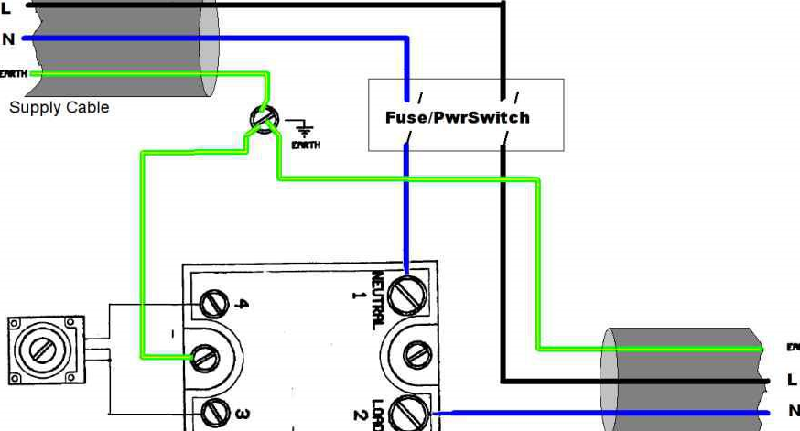

sambedded wrote:
Livetoride wrote:Champion thanks for your help! Any advice for wiring my ssr? It's not wired right apparently? Or was that referring to the switch?
It is wired right but you have a wrong SSR. You need something like this one http://www.ebay.com/itm/SSR-40VA-AC-24- ... 1058557493" onclick="window.open(this.href);return false;" rel="nofollow
Thanks so much for all your help it's greatly appreciated!

Antaean wrote:I have been reading this thread and am thinking of building the Mulekicker controller: viewtopic.php?f=46&t=17383&start=0
I do not mean to sound redundant but I have a few questions,….. do I understand it correctly that the
PSR-25 SSR - Newark # 97K7822 $44.65 http://www.newark.com/united-automation" onclick="window.open(this.href);return false;" rel="nofollow ... tt=97K7822 can operate at 110v or 220v?
Mulekicker added to a later post here that he added a 25A A/C meter, this shows a read out of the output?
I am planning on running a ½ keg (15.5 gallon) so I am looking for 4500watt heating element, since that is what looks to be recommended here for that size.
The PSR should work fine at 120V since you only control 1 leg anyway. If you are running a 4500W element you will need 240V, not 120V.
I also added the 25A Ammeter to mine, it is great to have and I recommend it. I run at 15A to heat up mash, full power(23A) to heat up low wines, 6A for stripping or reflux and 4A for pot still spirit runs. It would be much harder to hit the same power on future runs with just the dial and a tic mark.
I have a 5500W element in my 8gal boiler. It is overkill, but great to heat up my low wines in 12min!
Cheers!

Thank you Jeepkidd, I am getting closer to understanding what I need.......what controller do you use since you have a 5500w element?
jeepkidd
Posts: 140
Joined: Tue Jun 21, 2011 11:03 am
Re: Heating Element Control
Post by jeepkidd »
Antaean wrote:Thank you Jeepkidd, I am getting closer to understanding what I need.......what controller do you use since you have a 5500w element?
PSR25 - At full power my 5500W pulls under 23A
Cheers!
Jeepkidd, I am confused I thought you said you were using 220v with a PSR25 and a 5500w element....so the PSR25 can be used either 110 or 220v? I would prefer 220v since I want to run a 4500 or a 5500w element.....can you show some pictures of your set up Jeepkidd?
jeepkidd
Posts: 140
Post by jeepkidd »
I use 240V, same setup as on the forum link I posted.
Cheers!

I used a fotek ssr-40va from ebay and wired it just like the drawing that is for the psr-25 but when i tried it to boil water i was not able to get it to less than 4.5 amps. Am useing a b500k pot like it says but when i ohm it out it only shows 450k. Do i need to find a pot that is closer to 500k or can i add a resistor in series with it?
I used to have super powers until my therapist took them away.

ufo8mycow wrote:I used a fotek ssr-40va from ebay and wired it just like the drawing that is for the psr-25 but when i tried it to boil water i was not able to get it to less than 4.5 amps. Am useing a b500k pot like it says but when i ohm it out it only shows 450k. Do i need to find a pot that is closer to 500k or can i add a resistor in series with it?
You can hook 30K-50KOhm resistotr in series with the potentiometer. It should allows you to have less than 4.5Amps, but you will not be able to get full power/

The SSR-40DA Fotek SSR Fotek Solid State Relay requires a 1M Ohm potentiometer, not a 500K Ohm... :idea: That, most likely, is your problem... :eugeek:

rad14701 wrote:The SSR-40DA Fotek SSR Fotek Solid State Relay requires a 1M Ohm potentiometer, not a 500K Ohm... :idea: That, most likely, is your problem... :eugeek:
DA- series SSR are control by voltage. if you are talking about SSR-40VA - it requires the same pot as SSR25VA. 250K for 110V, 500K for 240 and 1M for 380V
Yup. Mine is listed as needing a 500k. Would a 1m still work on 240?
