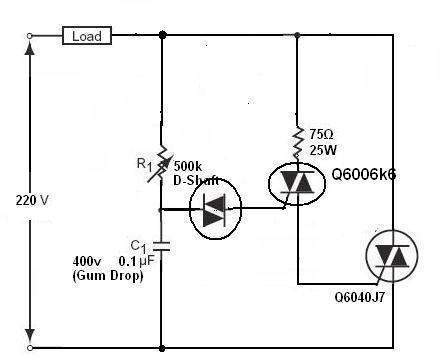

Pint, I finally built your controller that you sent me some months ago. I'm yet to test it under load but with a voltmeter across it, it goes between 238.0VAC (minimum) and 250.6VAC (max). Is this normal? Do I have anything to worry about? Do any of the other Aussies who have built one of Pint's control's have different readings? It would be appreciated if someone could measure the output for me. Thanks, Coops.

This unit could also be built using a quadrac which is a triac with a built-in diac... Additionally, you can use a sidac in place of a diac as long as it falls within the same specification range...glassman wrote:found most of the parts for the control pint. the diac is in question. any part # or info? want to get my glass still runnin and thats the last thing i need. gman

hate to guess rad but here goes. as long as the components can handle 220v @40amp they should work. it's all the other specs when buying components that screws me up. millivolts, leakage, you name it. mouser has way too much info for this brain. like to keep the learning curve as flat as possible. but i'l try a few options. pint is out of stock or i would just buy his kit. i'll be firering a 4000w heating mantle i built for a 22L flask. have a digital watlow temp controll but it will put all 4000w on the flask untill temp is reached. don'y want to stress the flask quite yet. too expencive to break thanks, gman

Not to throw this thread off-track, but some minor explanation is in order... The schematic presented above is based on the theory of using a sensitive triac circuit to drive a high-power triac... That being said, the circuit presented is actually over-spec'd on the sensitive side, but adds a good margin for error...glassman wrote:hate to guess rad but here goes. as long as the components can handle 220v @40amp they should work. it's all the other specs when buying components that screws me up. millivolts, leakage, you name it. mouser has way too much info for this brain. like to keep the learning curve as flat as possible. but i'l try a few options. pint is out of stock or i would just buy his kit. i'll be firering a 4000w heating mantle i built for a 22L flask. have a digital watlow temp controll but it will put all 4000w on the flask untill temp is reached. don'y want to stress the flask quite yet. too expencive to break thanks, gman
Now, regarding the spec's for alternate parts... A 600V 6A quadrac could be used in place of the diac and triac listed... It would go into the circuit in exactly the same manner, only without the diac... You try to keep all components in a circuit of the same voltage level if at all possible... For 240V circuits you would generally use either 400V or 600V components, and this circuit uses 600V parts... For 120V you would use either 200V or 400V components... You, essentially, double the expected input voltage when rating components...

This circuit is not overly sensitive like you said. The 40 amp alternistor requires 4 amps gate current at full load. That is why the 6 amp driving it. The 6 amp only require a few milliamps and the resistor can supply that without becoming under too much load. The resistor wattage is the limiting component in the trigger circuit which is only 1/2 watt. At low position which is 500k ohm it is only able to supply 68 microamps at the peak voltage swing.
The rms voltage of a 240vac is 240vac rms. This means that being sinusoidal the area under the voltage curve was integrated and give the same power rating as if it were an equivalent dc circuit at 240dc.
To get the real peak to peak voltage you must divide the rms by root 2 over 2 and this gives approx. 340 vpp. This is too close to 400 v so I usually choose 600 or 800 v components. This derating helps them last through voltage spikes.
Also, being the 40 amp alternistor can handle 40 amps continuously, I chose that to actually handle 20 amp loads because of the 200% derating for current allows it to be more reliable in the long term. Besides the expense of the larger components is not proportional to rate values. They are only nominally more expensive.
I technically don't use triacs because of their problems with fals triggering without snubber circuits. The alternistors won't conduct in the 4 th quadrant so they always go off dependably eliminating the need for a snubber circuit.

That "technical garbage" is what keeps the "Average Joe" from having a run come to a premature end with no way to finish up...
I've spent several evenings working on some spreadsheet calculations to help me figure some of that "technical garbage"...

I concur, I ran one of Pint's kits today for the first time and it works great. I didn't realise the level of control it would give me, the smallest turn on the pot registers. Thanks Pint, I wish I had of bought one initially instead of blowing all that cash on dimmer switches etc.

btw, im going to use the very first drawing pint posted, and ill keep you all informed on how well "I: can let the smoke out of it....

Mine is now making some pretty funky noises, kinda like something is vibrating. It still works though, should I be concerned?

Every controller I have built, regardless of the design and related components, has made buzzing or singing noises... This is normal for circuits with a bare minimum of components... You might want to be careful as far as having certain electrical devices close by during testing and operation, like hearing aids, pacemakers, or live explosives detonators...CoopsOz wrote:Mine is now making some pretty funky noises, kinda like something is vibrating. It still works though, should I be concerned?

Can I use BTA40-600B & BTA06-600B triacs instead of Q6040j7 & Q6006k6 and 25w 68ohm resistor instead of 75ohm?
How much current goes through potentiometer?
