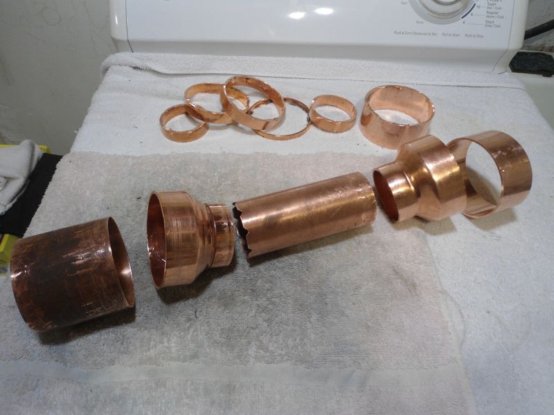

I put the finishing touches on my 1.5" concentric column tonight since it was finally warm enough to venture into the garage. I soldered a 4"x1.5" cap style tri clamp reducer to the top of my inverted bowl. The 4 inch part was soldered to the bowl leaving the 1 inch to accept the column. Like this one except 4 inch https://www.brewershardware.com/Tri-Clo ... ducer.html" onclick="window.open(this.href);return false;" rel="nofollow . I did this because the only bowl I could find to fit my pot had a flimsy
bottom and I thought this would stiffen it up and I was correct. With the 5 gallon pot empty it will support the 36" column with an 11 inch condenser on top and a 12 inch 3/4"X3/8" liebig like Rad built. I was really surprised that I won't need to support the column in any way. Will be doing the required cleaning runs in the coming week.

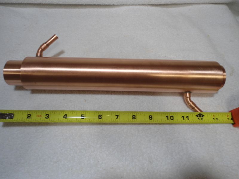

For a product condenser go to Rad's signature and look at page two of his apartment build thread. Scroll down to the
picture of his product condenser. I stole his design and built mine out of a 12 inch piece of 3/4 pipe with 3/8 pipe for the
coolant and product tubes. Super light weight to hang off of the takeoff tube and distillate comes out cold. This was a really fun build and a learning experience to run the thing. Took a bit to figure out that the temp was creeping up because I was not running enough power to create the needed reflux. Definitely a balancing act. It is too bad we all have to be so secretive. Would be great to have someone experienced to show us the ropes. That may come with time.
