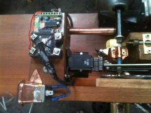

Here's a pic of the electronics installed. It works really well. I need to make a little cover for the live terminals on the SSR, I should really run an earth to the solenoid body as well. Everything still swings out with the two power sources unplugging from the gate. I am amazed at how well everything fits together without advance design work. It is made up as I go along yet each stage seems to fit the last through sheer serendipity.

Nice work Anthony. If you have to re-do the cutter, like you said, second time around always goes faster and better. I've been toying with the idea of silver brazing a carbide lathe insert to act as a cutter, and may try it one of these days, but my current blades are doing well.

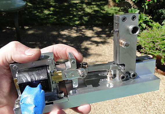

After this much effort, I wanted to make LOTS of SPP. As in multi-kilo batches. I had already made more than I could use, but it made no sense to stop here. So into the trash went the guillotine cutter.
The problem was simple... the guillotine had no mechanical advantage, no leverage. Tin snips work because of the leverage built into the mechanism, so I made a scissors-type cutter. One inch of solenoid movement equals 3/8" of cutter... big leverage.

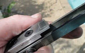

In this picture, I'm holding the blade. The cutter body is to the right, and the feed hole for the SPP is upper right in the body.
Next two pics should explain it easily. The blue tape is simply supporting the solenoid wires so they don't fatigue and break.
Ready to cut, SPP goes into the bushing upper right... CUT!! Works PERFECTLY. So now I have a machine that counts loops, doesn't jam, cuts all day.
I took everything I'd learned about bit geometry and made a few new bits. These are making some killer SPP, visually at least.

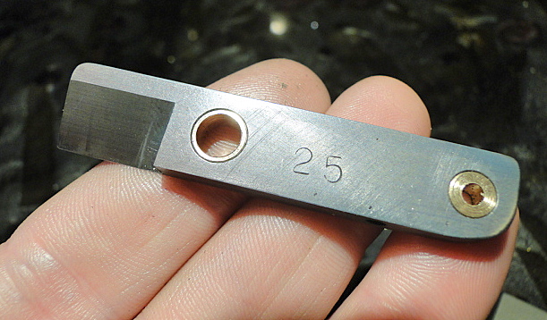

Carbide - tried it. Wasted a whole day grinding a small carbide insert to 45 degrees, brazing it onto a brand new cutter body, only to have it chip after making 50 nuggets. Total waste of time. Maybe it was the carbide grade I used, dunno.
Since then, I have been educating myself a bit on steels, tool steels and carbide. High speed steel blades at maybe 40 degrees is going to be optimum. Carbide is too brittle.
I priced HSS flat blanks. Get this, a 0.093" x 1/2" x 4" long T-15 HSS strip is $50!! YGBSM. On eBay, I found a variety of HSS and placed some orders. I'd like a blade that allows me to simply insert the HSS, clamp it down, and cut. When time to resharpen - it's inevitable - sharpen the edge and re-clamp.
The stationary part of the cut interface is a dead-hard O1 steel round, simply drilled through and held in place with a set screw. Easy-peasy to replace or sharpen.
Anthony - if you get the gumption, a scissors mechanism is probably the way to go. Didn't mean to lead you down a wrong path, I thought the guillotine would work all day. The only trick with a scissors cutter is to ensure the blade doesn't ride up and away from the cut plane, and that can be done with tight tolerances, or maybe a spreing pressure on the blade, pushing it down. And yes, a potent solenoid helps.
I love this new SPP geometry, looks good.
Best of all, I'm back to work on my still! Can't wait to FINALLY run her!
Edit - SUMMARY (hopefully) - SPP is NOT hard to make. It's hard to cut. If someone out there wants SPP for his still, go for it, it can be done without too much trouble. Then, sit in front of the TV with a handful of long strands and start cutting with good cutters until your hands cramp up. You'll have enough, soon enough.

The machine can puke out a 2 lb spool of wire now with zero stoppages. FINALLY have the cutter doing what it should do. I'm adapting the machine to take a 10 lb spool, rather than the 2 lb spools I had been using. It's cheaper that way.
And I can make custom SPP up to 8.9mm diameter if interested.
http://homedistiller.org/forum/viewtopi ... =8&t=52064
Here's the blade that works... tool steel (A2) with a 25 degree primary relief angle, and cannot see in the picture, the actual cutting edge is beveled to 55 degrees relative to the cut plane. Higher angle at the cut means it tends to not make it through the material, a lower angle will chip if the steel is too hard, dent and dull if too soft.
And just for fun, the entire wasted day adapting a solid tungsten carbide insert into the old guillotine cutter that is now scrapped. This lovely bit of work cut about 6 nuggets before fatally chipping at the edge. Carbide is too brittle for this duty!
I sincerely hope some of the experimentation I did on making SPP will help guys make their own, especially bit/mandrel geometry. It was a long haul, but hopefully worth it.

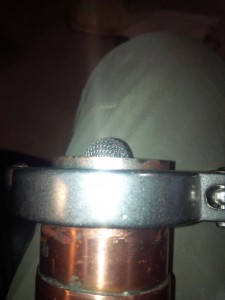

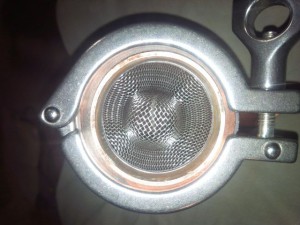

After reading this thread, had to try some. Got it today as well as a new 3" sight glass. This stuff looks awesome! made a retainer out of a sink strainer that happened to fit well. pics are just dry fitting it with a spare ferule, these of of the 2", have same thing for the 3" column. Going to clean the packing and hopefully set things up tomorrow for a run.

Haha! LOVE the retainer! The SPP looks nice as well... that ziploc bag looks familiar!
I need to think outside the box and use more common materials, rather than fabricating everything.
I made my 3" retainer from a 1" section of 3" pipe, sawed off, then split, with a bit more material removed. When pinched together, it slides inside the 3" column.
That Cu ring was simply laid down on a piece of SS mesh; gobs of flux, heat, and solder, secured the ring to the mesh. Then, I simply scissored excess away from the ring. But I like this ^^ better.
Please let us know how it goes.
