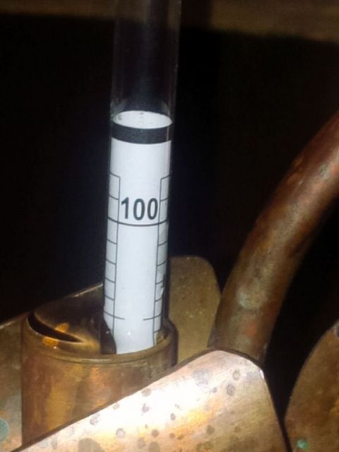

wish I wouldnt have change everything in one go. new dephleg, new cooling arrangement, new sight glass, new gaskets.... new leaks! losing loads of vapor. still producing 90+ percent but a waste of a run.
400ml 92% in 19 minutes, after 200mls of fores dumped.

Ill add my review to Swedes SPP. I just upgraded from a pot still to a reflux. So keep in mind Im still learning how to drive the new CM. I built a 2" modular system that I am packing with Swedes SPP with lengths to go from 12" packed up to 52" but my current low ceilings have me running at 40" of packed section. All three runs I have done so far have been 11-12% ujssm. I'm not trying to reach azeo completely so I havent really tried to push it just letting it run wherever the equipment wants it to. Im leaving a couple inches above the SPP and also putting a SS scrubbie on top. Im learning to create the semi aquatic state that DAD300 has often stated without puking. (Which has also happened) Ive started within 2% +/- of 90% abv after foreshots have been removed, then hearts coming off starting at about 82-85% and ending around 60 to 65%. I dont have any experience with any other packing to compare to at this time but I can say I am very happy with the results of this SPP. I believe with a little tweaking Ill come close azeo with the current 40" of packing when I do try to push it to. If not when the weather warms and I can go to the full 52" of packing azeo will be another notch I can add to my distilling belt.
As always I am very thankful for the wealth of knowledge here I can honestly say there is no way possible I would ever be running the equipment I am now, just over 3 years into the hobby without the knowledge and In this situation also the advanced equipment shared on this forum. Thanks Swede again and all the others here for sharing.

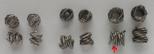

The SPP machine has been well refined in that the new scissor cutter, when correctly tweaked, can eat through 20 pounds of wire without stoppage, and that is a miracle compared to earlier runs where I'd be lucky to get 2 minutes without a jam. I am at a point where I can leave the machine alone a bit.
I actually installed a wireless remote OFF switch to the machine, and I wear the dongle thing around my neck. My ears know what's going on, and I can mash the OFF switch if something goes bad.
Now, on the SPP itself - After hours in front of that thing, playing with parameters, I've come to some conclusions. These apply only to my machine, but I'm guessing others will behave similarly.
1) wire TENSION does little to change diameter or geometry. Surprising to me. I set it and forget it.
2) FEED ANGLE - this is the big one. By feed angle, I refer to the angle the wire creates with the mandrel as it makes initial contact. At 90 degrees, I get fully closed SPP. Just a couple degrees more (ex. the angle of wire to mandrel axis is about 95 degrees) it begins to open. More angle, more open. I can set it so that there is HUGE daylight, if wanted. It is completely repeatable and reliable, and I currently set it so that there is slight daylight between loops. Even have graduated markings on the wire feed just for this adjustment.
This may NOT be desirable... maybe closed is better. I don't know, until I can test my new rig with closed vs open SPP.
But here's what I've taken away from reading on this material here and other forums. If a guy has excess power available during reflux and collection, then SPP likes more power than say scrubbies. And with more power could come by definition a faster takeoff, all else being equal, if the operator cooperates by opening the VM or needle valve a bit more. If it comes with higher ABV, that is a double-plus good result (Orwell!
) Double plus ungood would be SPP having little advantage over other, cheaper materials.
Those with this stuff, please post results, hopefully good ones, after investigating it over more than one run. It'll definitely be different than other packings. I guess the same can be said anytime packing is changed... optimum parameters, running technique, are going to change as well.
And there's ^^ my daily HD novel. Sorry, I write too much. Cheers!

None needed, I've had a blast. I think your thoughts are spot on. This 6.4mm stuff may be TOO open. I'm thinking a definite "crunching"/packing it down may be the way to go. No loose, floppy column fills. That, and plenty of power.humbledore wrote: Thanks again for all your work.
It may be like a new guy packing a 2" column with 5 scrubbers - more is needed. Pack her down.
I need to make a general announcement... I've sold SPP to maybe a half-dozen HD people. This is craft and hobby stuff for me, I'm enjoying it all hugely. And the $$ part, couldn't care less. I've been looking to simply cover time and costs and maybe buy a bit of copper.
What I want to ensure is that this stuff is a leap above other packings. If it isn't, then there's no point to it beyond experimentation, which is where we are at with this particular SPP. On my eBay ad, I mention "no returns of used SPP." That doesn't apply here.
Anyone who has purchased SPP from me, what I want is for you to have fun with it, experiment, get data, be happy. And post. And if it's no better than scrubbers, PLEASE let me execute a refund; don't want any back, I just want to hear about good results. Think of it as a "consulting" arrangement. Again, PLEASE don't hesitate to ask for $$ back, this stuff ain't cheap.
I'm not on a budget, I don't know of any other way to say it and not sound classless.

have had a couple runs with the SPP and a new configuration for me 3" by 40" reflux with 3.5 ltrs of Swede PP. I am still learning how to drive it. first spirit run was very clean seven litres at 88%, made some changes to the RC and column, did a little compaction and now running a sugar wash and am now up to 94+. Once I figure out how to run this effectively I will post some proper readings and information about my set up. I am pleased so far with the performance. Thanks Swede
. I think you and DAD300 and Humbledore have it right. smaller size denser, makes sense to me empirically, when I was doing the first runs vapor would escape past my condenser if I had full power. I improved the condenser capacity and slowed things down with a couple scrubbies and a drop in bubble cap plate under the sight glass. got the aquatic thing happening. made a ten second video but no idea how to post it. editing again... after a couple.... wanted to sample for evaluation. I believe the Swede PP works very well (could be the sweet nectar of my efforts talking) the ABV of the first spirit run was lower than I expected, but was very clean, after the modifications I am very optomistic, I cant wait to do a full run best stuff I've made bar none. It tastes better than the spirit run I did yesty straight away.

another run today, same wash with some feints from yesterday tossed in. its been sitting steady on 95%, loving it

So johnarms....what's the take off speed? How many minutes a liter? during hearts?

sorry was not being super vigilant today had a sparky doing some work in the reno and it was coming off slow on purpose. opened up a bit and take off increased with no appreciable decrease in ABV . This reporting thing is new to me, DAD300, what would be the best info to post? ....perhaps a standard form would be appropriate for posting here? I generally do time of start, time of boil, time of takeoff for fores, then time and amt of distillate (try to make it 500mls) for myself. I'd love to print out something to record my runs. newby learning

near as i can tell its about 1.25 ltrs per hour. I'm sure it can be manipulated with power and reflux... just where I'm starting I guess. Two or three runs is not something to go by for me still learning from people like You... thanks.
