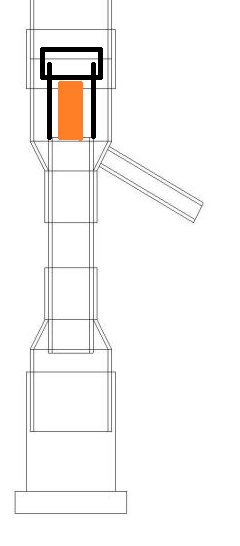

I would like to modify this design by extending the inner copper pipe up into the condenser chamber, add slots and an end cap. The slots vent alcohol vapors into the condenser. Slots are orange in image. Any potential problems with this mod?
