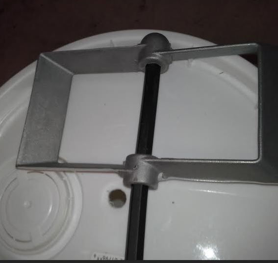

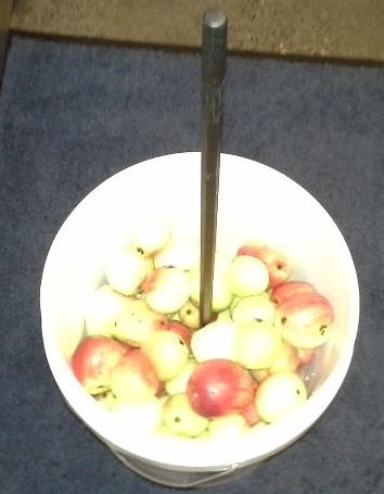

Exciting times in my little world. I was talking to Yakattack on another thread and he told me he successfully uses a mortar mixer to grind apples. The next day I had to go to Lowe's to pick up some stuff so I looked for a blade style mortar mixer which they had on clearance for $3.75, so I bought 2 I also bought a new food grade bucket and lid to grind them in. On my way home I stopped at the park and picked a bucket and a half of apples to test it out. Today at work I sharpened the blades and drilled a hole in the lid of the bucket and washed the apples. I took half the apples and placed them in the bucket on top of the mortar mixer and took a cordless drill and chucked the mixer in it. This did not work. The drill was far too weak and slow but we don't have electric drills at my work and I forgot my corded drill at home. Looking through the tools we have I managed to find an air drill with a 3/8th chuck and we were in business. On that first bucket full I made a few mistakes. I filled it too full and tried to start at the bottom. Reducing the amount of apples down to about half a bucket full and starting at the top which resulted in the apples being pulped fairly well. Mistake number 2 was not sharpening the blades enough for fear of breaking the seeds with it but after taking a die grinder and rotary file to it and making it fairly sharp it worked pretty well and didn't break the seeds. Another concern is the drill. It takes a drill with both speed and torque to handle this thing but the air drill did fine, I might try it with my big 1/2" drive monster drill that has plenty of torque but may be lacking speed. After I did the bucket and a half I picked yesterday I discovered that someone had left me 2 big bags of my favorite kind of apples in the refrigerator at work My favorite kind of apples are free apples someone else picks So I washed those apples and actually timed how long it took to pulp them. Exactly 6 minutes to pulp a bucket and a half of apples, so 12 minutes to do 3 buckets which comes to about 69 pounds of apples. So far I'm pretty happy with that.
I took pictures of everything I did today, so here they are.
I started with a mixer and food grade bucket and lid Drilled a hole in the lid and sharpened the mixer Next, after washing it I added apples Hooked it up to an air drill and made some apple pulp This last picture is the pulp after grinding 12 minutes and 3 buckets of apples are all ground up and ready to press.
Tomorrow I will try to find the time to press the juice and see how it compares to the method I've been using up til now.

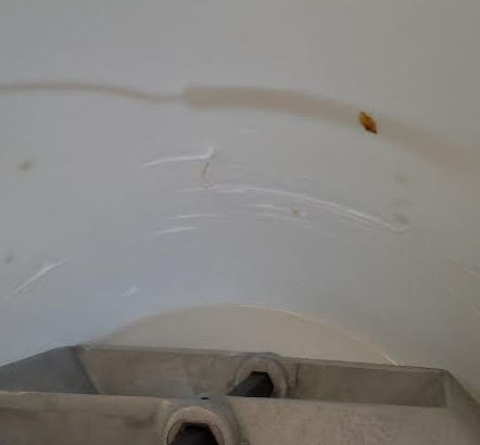

Today I ground up the apples I picked Saturday. I brought my antique arm breaker drill which has plenty of torque but is only 550 RPM so it took a bit longer than the air drill. but not all that long.
One thing to be careful of is the mixer digging into the bucket which does this
This last picture I have shows the actual pressing of the juice.

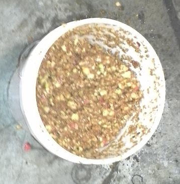

Since I picked apples yesterday I ground them up today. I think I finally have the mixer/ chopper figured out. The trick is drill speed, you need a fast drill, the 550 RPM wrist breaker drill is just too slow. I used the air drill quite easily today. The other trick is to never do more than 1/3rd of a bucket at a time, 1/4 is even better. I timed the pulping and was able to do 1/4 bucket in 40 seconds with a finer grind than I could get from a 1/2 bucket because the drill never bogged down. Ideally I could set up 4 or 5 buckets with a helper and fill them 1/4 full then I could move from one bucket to another while a helper emptied and refilled them. You could do a lot of apples very quickly this way. As it was I managed to do the 1.33 buckets I had in about 7 minutes, taking time to stop and empty the bucket between each session. Here are the pictures to go along with it. This first one shows the perfect amount of apples 1/4 bucket
40 seconds later it looked like this
7 minutes total with about a minute spent emptying and refilling between grinding.

One thing I should mention in case anybody else tries this is to make sure you have the lid locked down on the bucket. I spent more time cleaning up apple pulp off the shop floor today than actually grinding the apples.
And rounding the lower corners a bit stopped the gouging problem.
